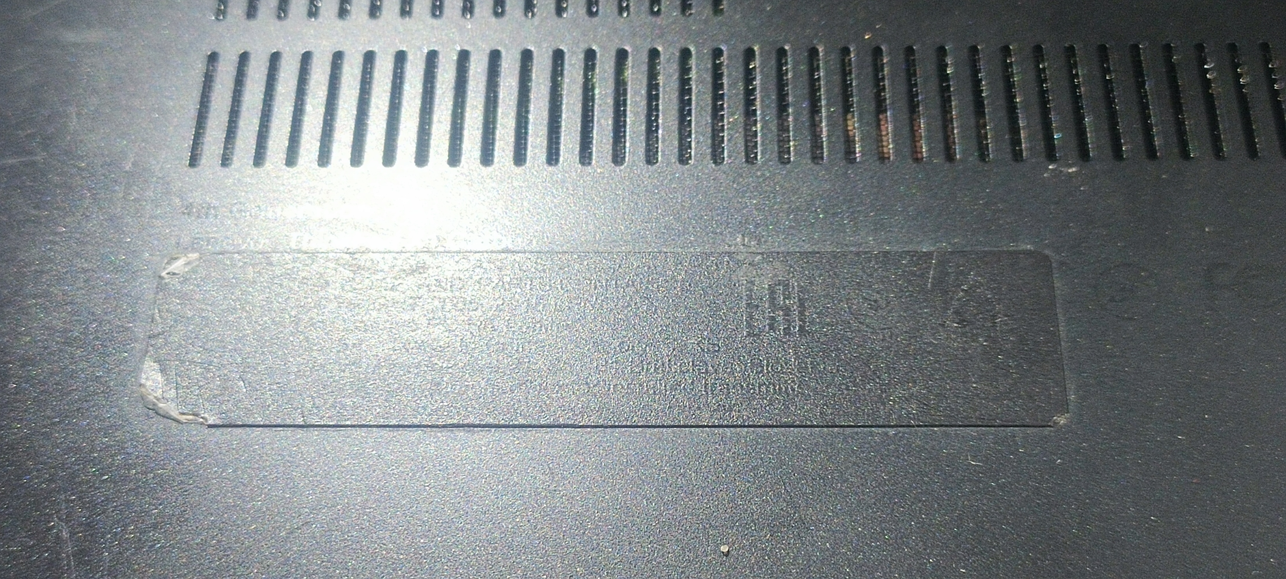

                                          #40
                                          Originally posted by chraa47
                                          remove password pls
                                          Lenovo Thinkpad X1 carbon 4 gen
                                          14282 2m lrv1 mb
                                          448.04p18.002m
                                          Serial is not clear 😭
