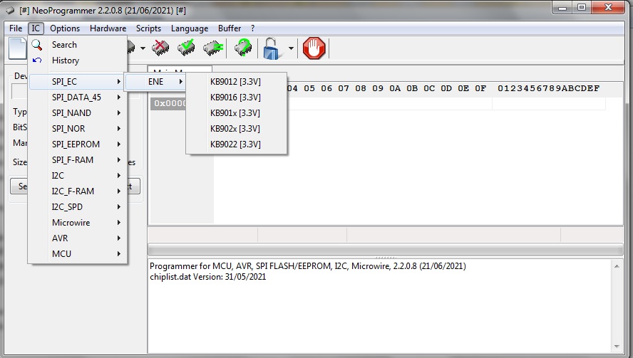

                  Hi, I flashed the bios with the ch314ea programmer.
                  but the EC file how should you flash it?
                  thank's

                    #29
                    Re: La-b162p
                    thank's
                    https://ioprogrammer.com/

                          #32
                          Re: La-b162p
                          thank's
                          You can use the ch341a, but its slow,and tricky too as you have to solder individual wires to the keyboard connector pins.
                          Use NeoProgrammer software - https://www.badcaps.net/forum/showpo...50&postcount=5
                          Flash Ene kb9012 Sio Using Ch341A https://www.youtube.com/watch?v=GQGH6yZuXCc
                          Recommended to modify the ch341a voltage first if you have the black pcb version
                          CH341A volt mod https://www.youtube.com/watch?v=HwnzzF645hA
                          CH341A volt mod https://www.chucknemeth.com/usb-devi.../3v-ch341a-mod
                          You can also buy pre-programmed chips from ebay and aliexpress.
                          If you want to buy an IO programmer there`s other models besides the one that @peste posted theres SVOD3, Vertyanov JIG, RT809F (with peb1 adapter board,but limited to only kb90xx) ,RT809H with adapter board.
