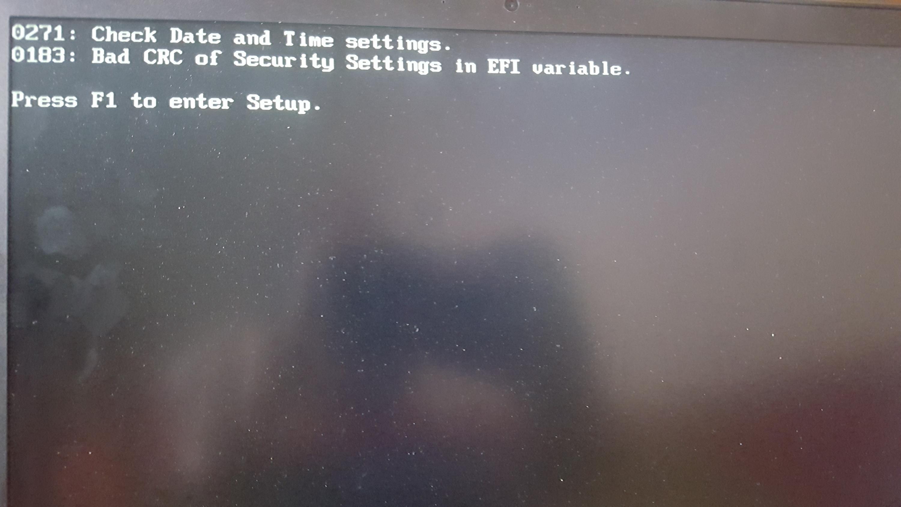

    Hi guys! I need yours help to remove supervisor password in uefi bios bin file that i dumped from my Lenovo Thinkpad T460S. Machine Type Model: 20FAS3440B. System-unit serial number: PC0J8TG5.
    Thanks in advance!

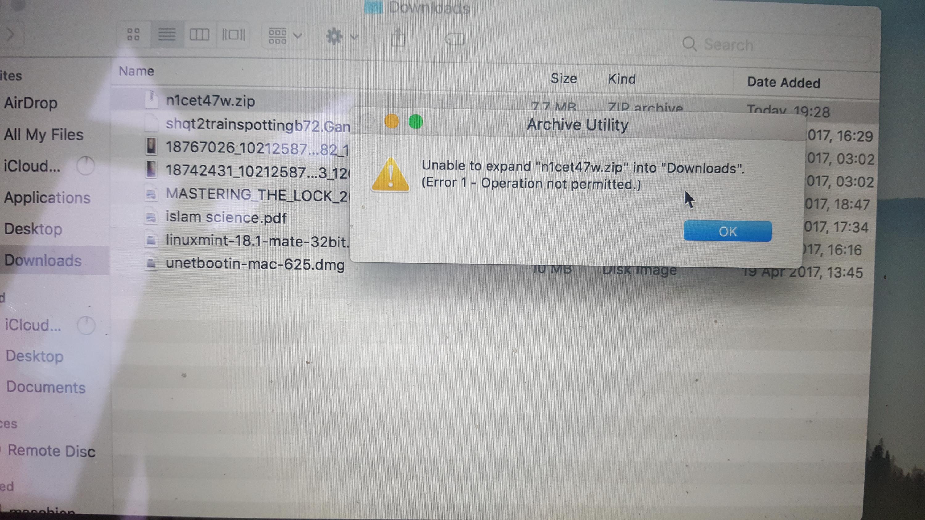

      Hi, thanks alot, i downloaded it but couldnt be extract?

        Re: Lenovo Thinkpad T460S Clean Bin Help
        here is the pic
          My archieve was compressed with 7z x64 bit
          here:

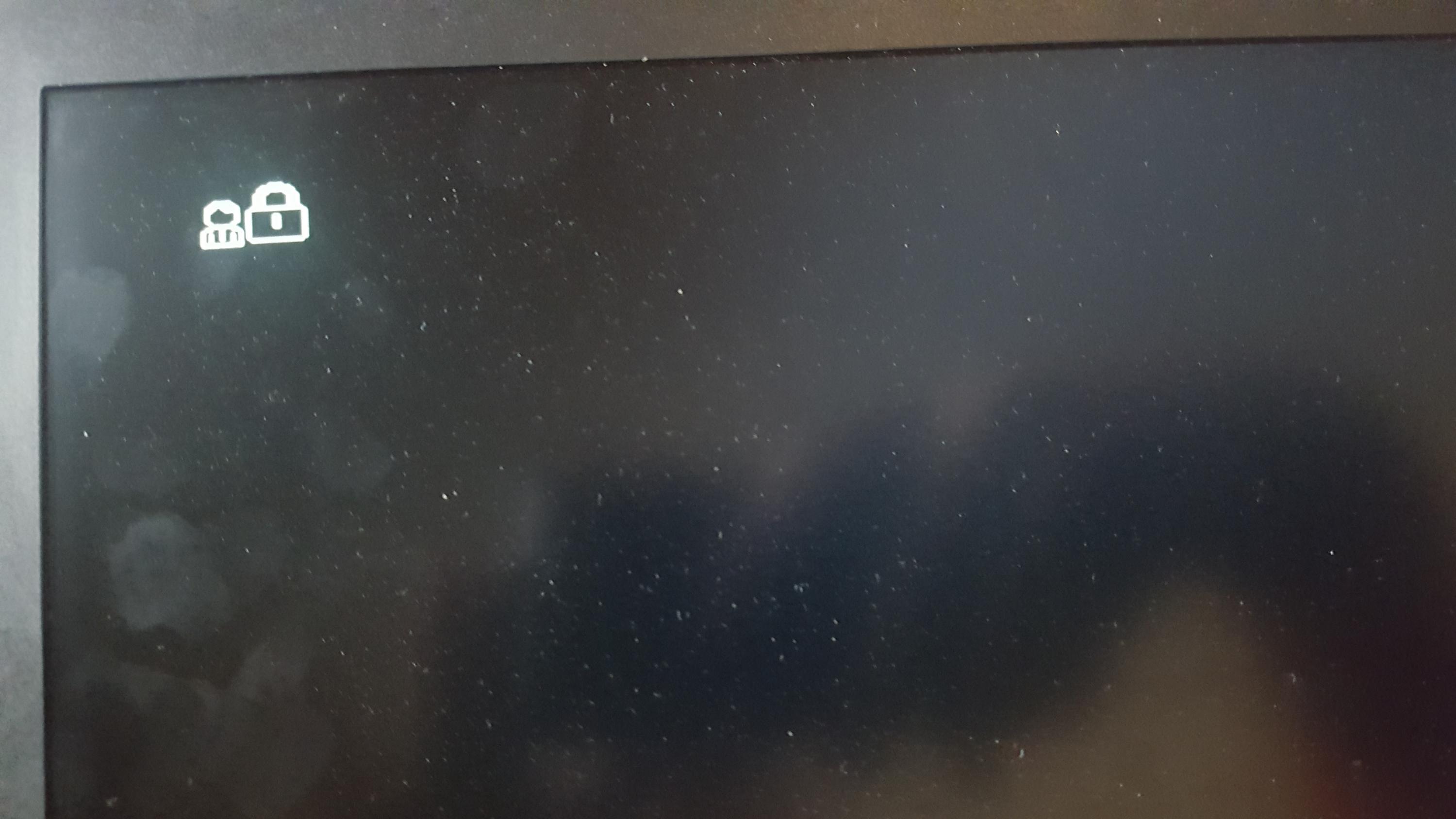

            not working, still asking me a password and with some error message, 0183: bad crc security setting in efi variable.
            here's some picture.
                Originally posted by stj
                remove the harddrive, then boot it up - see what it does.
                some efi crap is stored on the harddrive.
                i did, but still doesnt work and the ssd also locked... but thanks
