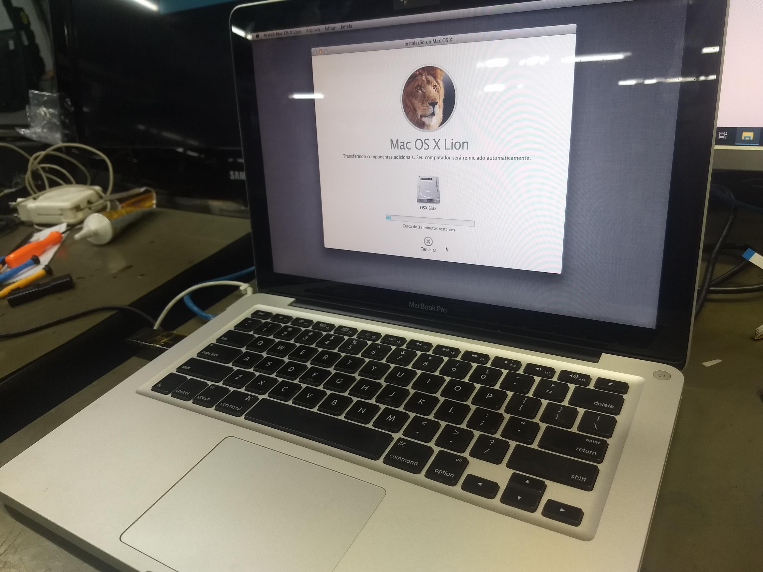

                    Re: help need dump file a1278 emc 2326
                    Unfortunately I must disagree on the matter today I had another case (an A1278 from that time, the fan was spinning no video, I programmed the bios, I got the binary right here in the forum) the client wanted to take advantage of to place an ssd and do a fresh installation, for me surprise installed via internet without major problem accuse a photo of the installation
                      then I will insist on getting a functional original backup to repair the other MBP thank you very much for the considerations @piernov
