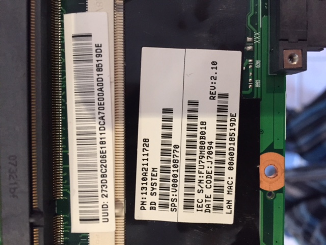

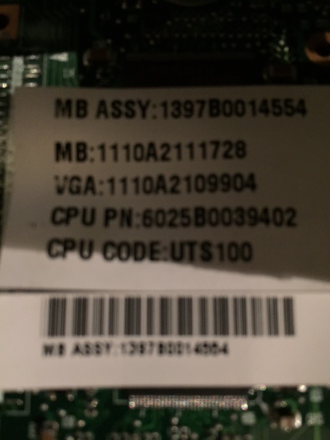

    hi
    may i know motherboard part number?
    • hazzaman
      • Oct 2016
      • 24
      Re: Toshiba Satellite a200 PSAF6A-07G01N BIOS
      Originally posted by boyebaran
      hi
      Hello boyebaran,
      I think it is 1110A2111728
      Thanking You.
      • boyebaran
        • Sep 2015
        • 247
        • iran
        you must find part no in pcb.it is not.
        • hazzaman
          • Oct 2016
          • 24

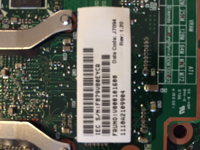

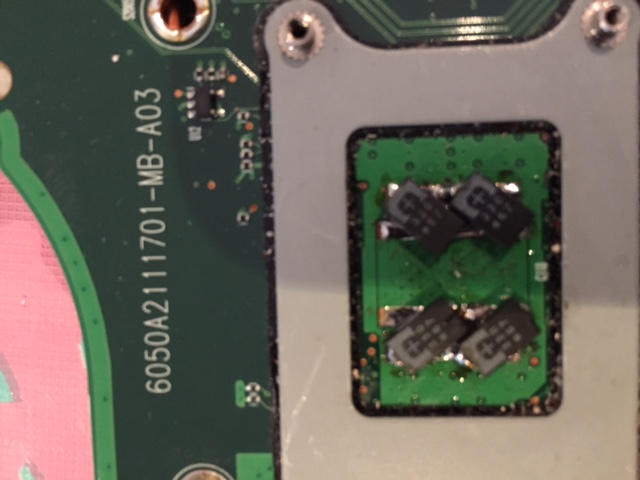

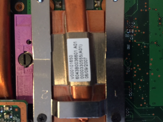

          I hope one of the picture has it.
                  Firstly Thank you to rievax 60 and boyebaran,
                  I have downloaded file thanks.
                  My problem is that once I turn the laptop on, it beeps and tells me that
                  0251 CMOS checksum bad, F1 to use defaults, F2 to enter setup.
                  I can access the BIOS change settings, exit , it will reboot and then lock with a black screen.
                  I have a Toshiba Satellite A200 PSAF6A-07G01N.
                  I have replaced the NEC-TOKIN due to it locking up when charging laptop whilst using it.
                  Also replaced HDD and CMOS battery.
                  Pressing ESC when turning laptop ON shows me that it is checking RAM it seems Ok.
                  So once I turn the laptop on, it beeps and tells me that 0251 CMOS checksum bad, F1 to use defaults, F2 to enter setup.
                  Again I can access the BIOS change settings, exit , it will reboot and then lock with a black screen.
                  Can anyone tell me if I can fix it.
                  I feel it might be a BIOS issue, but cannot boot to anything to reflash.
                  Unless someone tell me if I am doing something wrong
                  Can anyone help.

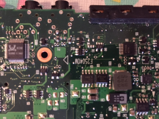

                          I dont know what the checksum error means. Is there voltage across the CMOS battery?
                          The EEPROM IC is U33 near the front of the mainboard, 25VF080.
                          Search here for the CH341 programmer.
                          Double check the RAM by using one module at a time in each slot.

                                  I happen to have an A200 open here, PSAF6A-0SQ01N. It should be comparable to yours. It has ATI HD2400 graphics rather than the HD2600. The BIOS IC is U38 in this model. Check yours.
                                  • hazzaman
                                    • Oct 2016
                                    • 24
                                    I have just opened up and the BIOS IC is U38 and has a red dot.
                                    And I believe is a 25X80VS1G
