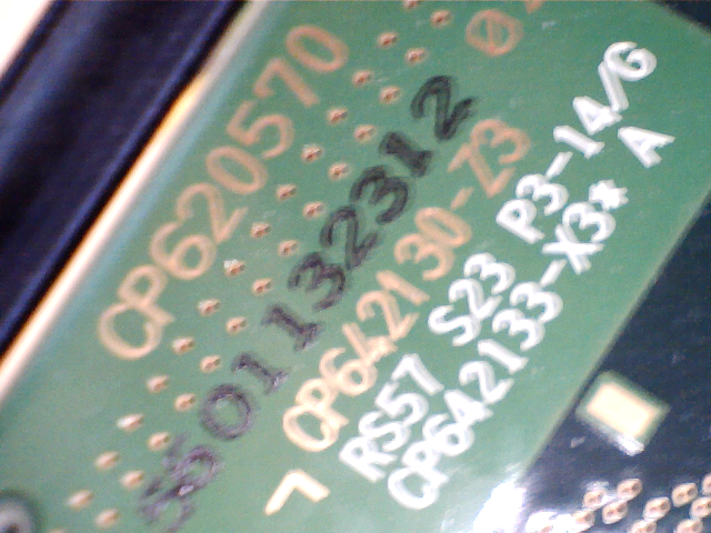

    Hello
    I need dump file for bios Fujitsu Lifebook E734
    Main 4MB, ec 1MB
    model of motherboard and old dump are attached if anyone can remove password i oready tray the dump frome the form but dosnot work

        Re: Fujitsu Lifebook E734 (E734) bios needed coz password
        Originally posted by salim.thebadboy
        Hello
        Main 4MB, ec 1MB
        Are you sure this password is store in bios chip? there is no eeprom? so you can try this...
        main bios + ec bios + update cap file (for your reference)
        don't use pw-org, it will not work, cause only for 5x4 hash fujitsu...
        your password will generate 6x4 hash.... there is no free generator for 6x4 hash until now...
          thanks bro it has been solved by changing the bios chip but thanks for reply
