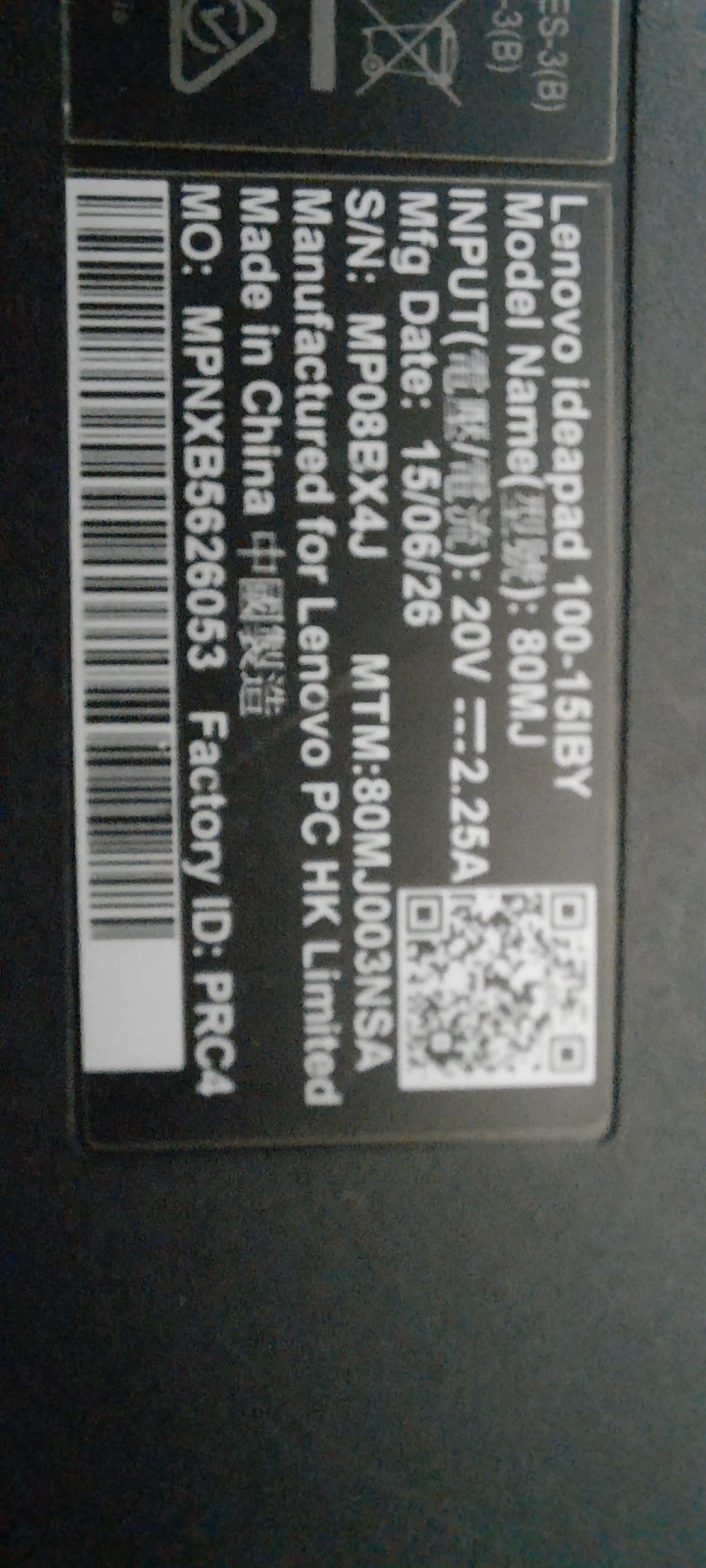

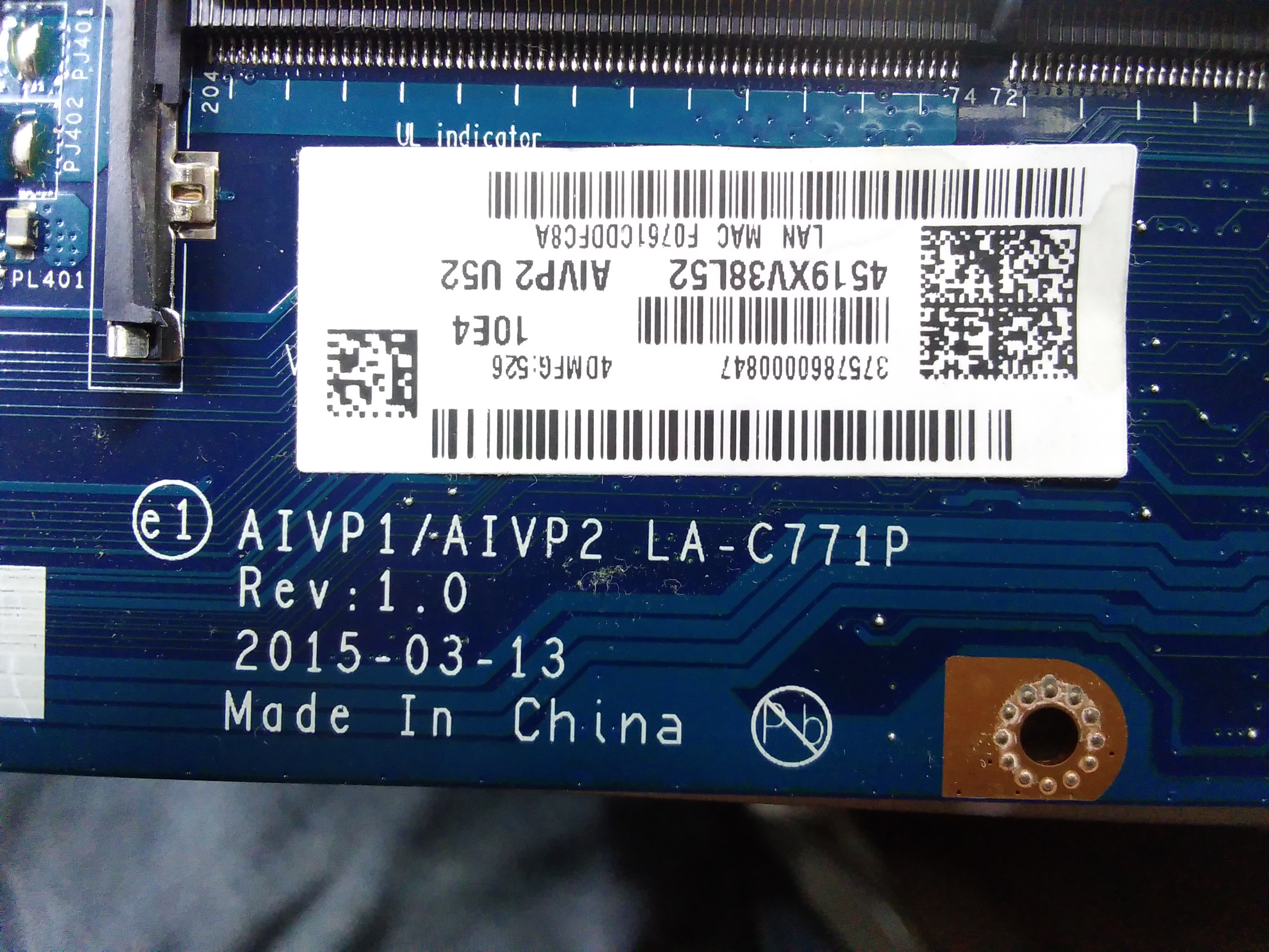

                          Good morning.
                          May I please request a bios for a Lenovo Ideapad 100-15IBY laptop?
                          Model Name: 80MJ
                          Board model: AIVP1/AIVP2 LA-C771P REV 1.0 2015-03-13
                          My problem is the laptop board gets power and powers up when you press the power button. All voltages and resistnces on the coils read good. Also tested new ram as well as these lenovo's can behave like that with faulty ram.
                          I have already tried to download a new bios from Lenovo and I extracted it succesfully. I also followed the guide on how to cut the header from the bios but I am not clear on where the header ends in the bios of that laptop model. Trying the different ofsets mentioned in the guide I can't see if I am getting the full eader or not.
                          I will attach a backup of the original bios as well as a photo of the motherboard model and model of the laptop.
                          I hope I followed all guide lines my apologies if I missed something.
