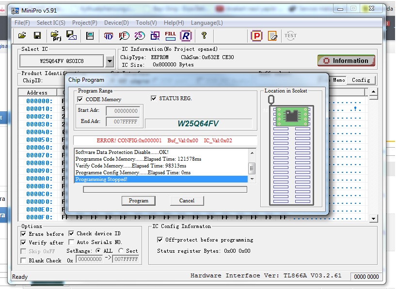

    I can do it when is a Desktop Motherboard but no idea how to solve in a laptop. Im a beginner computer repair techision, need some help here ;
    Re: Asus X551M locked with bios password.
    you need re-program bios chip.
      Ok, if its only way to do it. I have MiniPro TL866 programmer kit. Can any one help me to find Bios Dump for This laptop MB. I serached online for this model but no resolt.
        Please read your old bios and post here.
          here is the old bios. by the way thank you for your time
            Asus X551M (MB X55MA) ok 100%
              I backed it up the old dump, with no error while reading, ones I tryed your file this massage appired what to do next ? anyone there
                Try another chip , any chip with the same size.

                    I puted away for a while this MB, I just star to work on it today for one more time,
                    here is the name of bios ic.
                    Winbond
                    25Q64F VS10
                    1348
                    Im going to try to find dump for it, if not will try to buy a new ic
                          It worked! thanks bro
