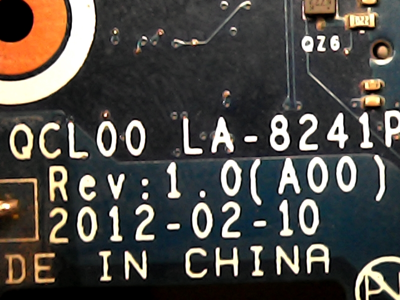

                  Re: Dell 15r 7520(5520) bios dump needed
                  ELL INSPIRON 5520
                  DELL MODEL No:5520-6928
                  Country:LT
                  Service Tag:254HGS1
                  QCL00 LA-8241P
                  Rev:1.0(A00)
                  2012-02-10
                  CPU
                  INTEL SR0MZ
                  AMD
                  216-0833000
                  E217A584
                  SLJ8C
                  ENE
                  KB9012QF A3
                  UH2
                  cFeon QH16-104HIP
                  UH6
                  cFeon Q32B-104HIP

                    Need working bios for Dell 5520
                    Good day everyone. I would like to ask if anybody have working bios for this laptop Dell 5520, la-8241p rev 1.0 amd gpu.
                    The first issue was the 5 beeps that point out to a cmos battery. I already tried replacing cmos battery but still same problem. I decided to flash bios coming from here. The beeping issue is gone, but it has no display now. The motherboard is responding because the fan stops and spin when processor is getting hot. And also when I press power button it turns off accordingly.
                    The bios I used may not be compatible or has a different setting. I can also upload mine so maybe someone can fix it. Hope someone helps. Thanks.

                        #31
                        Re: Need working bios for Dell 5520
                        djems3, with your bios i get 7 beeps which points out to processor. most likely this bios is from different processor. Mine is an i5-3210m (SR0MZ) with Amd 216-0833000 Mobility Radeon HD 7670M gpu. Anyway thanks for sharing.
