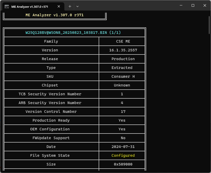

          Someone before you already flashed BIOS from HP website version F.27 (HX55), the ME region didn't even initialize in your backup, it shows as "Configured", when it should be "Initialized". check for hardware problem

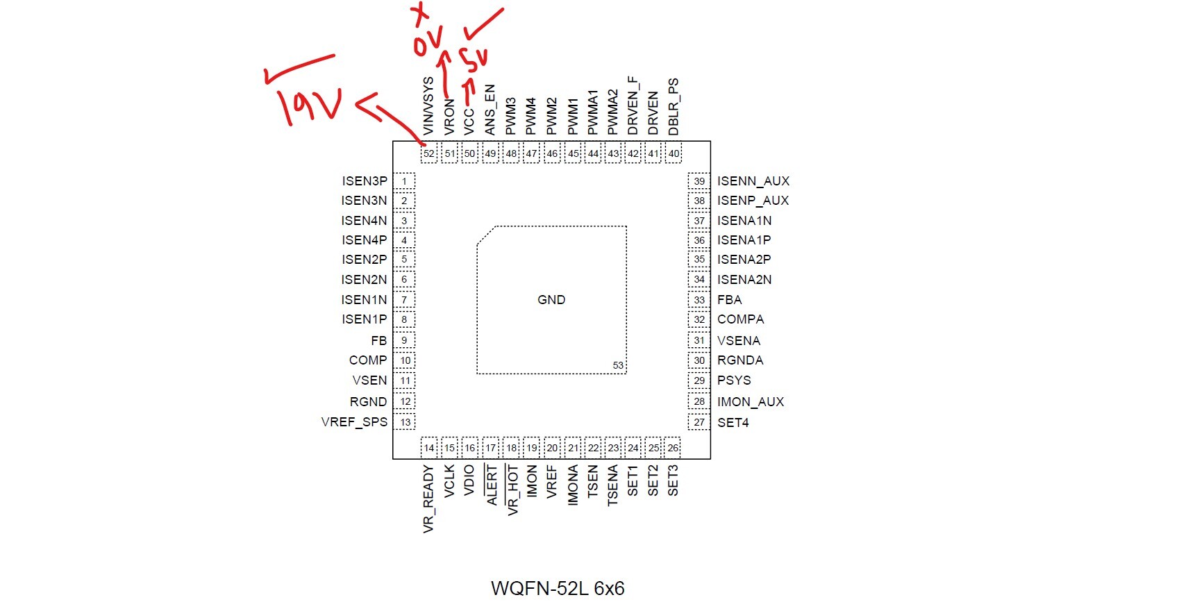

              while checking hardware i found vcore voltage absent
              by tracking the cpu circuit found the pwm signals absent from cpu controller ic (RT3624QE)
              when i measured the ic pin found
              vcc 5v
              vin 19v
              VRON 0v
              this signal vron coming from i/o kb9542 from pin number 121 which has been 0 volte too
              can ec firmware cause this drop on vron voltage?
