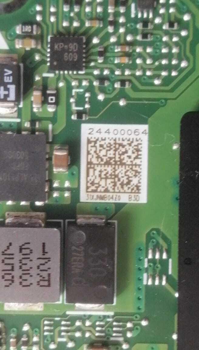

        Does anyone happen to have the EC programming?
        The model is M6400QC REV 2.0, NBN0CX01T900455.
        I think the programming it came with is corrupted.
        ITE5225VG-128

          post the 15 digit laptop serial number

        Is 31XNMB04Z0 B3D or 24400064
          • 22293
          The model number in the QR code scan is M6500QB .Attached is the EC extracted from the M6500QB bios update.
            Thanks, that file works
