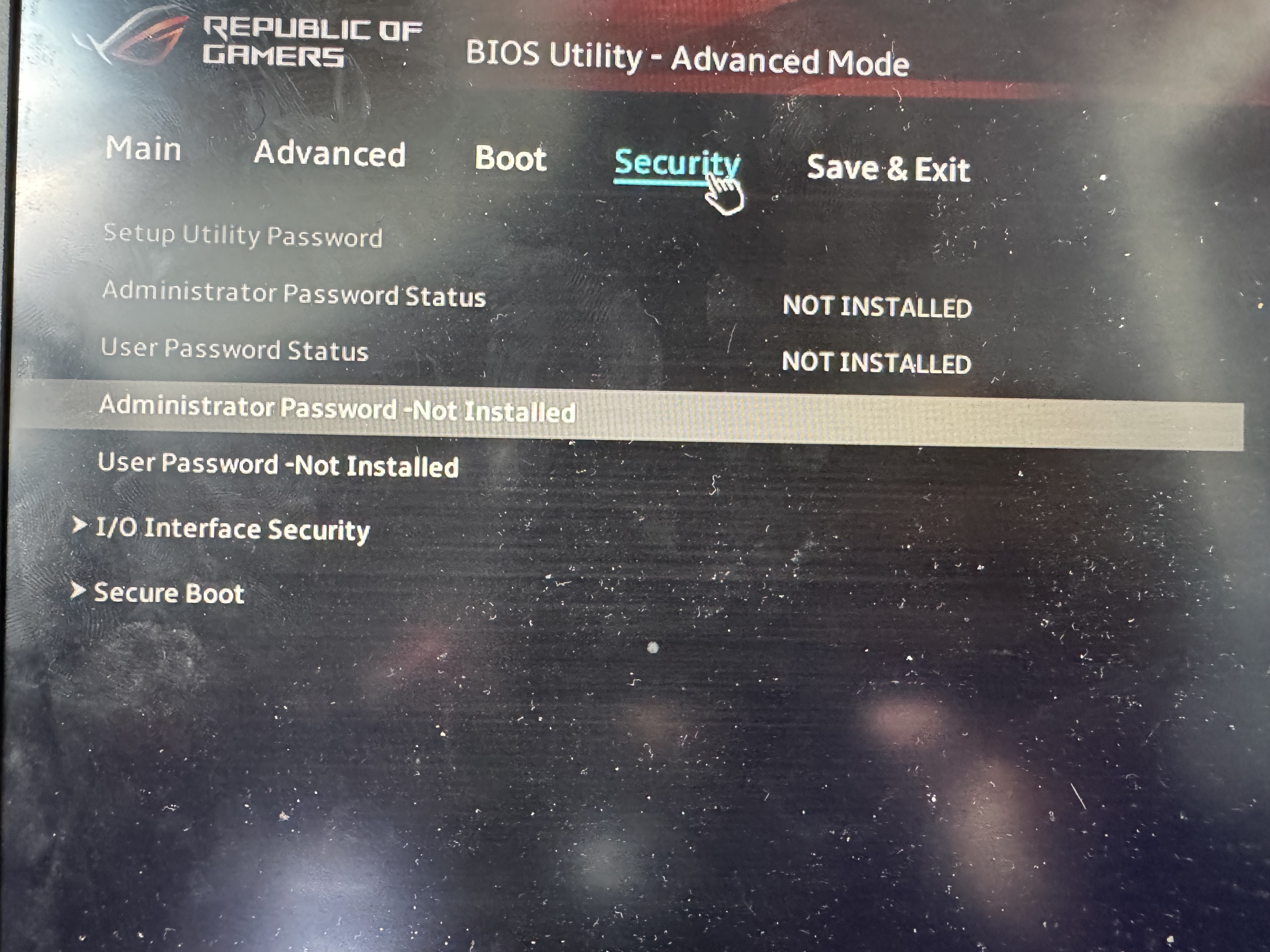

    Hello ,
    I replaced a pch on an asus g532lws laptop board , all is working fine , but when i want to upgrade to windows 11 tpm 2.0 is no available , i search on google , found somethings who speak about intel ptt , someone know how to reprogram or reset the tpm feature?
    i have a backup bin of the bios if something need to be modified into bios , maybe something exist like for the intel me region?.
    thanks a lot for you answer
    serial of the machine is L6NRKD010738235

        • 21889
        Originally posted by bios29
        its done bios posted + serial
        Clean bios.

            • 21889
            You Fix the bios ?you can explain a Little what you’ve done?thank you
            I cleaned the ME firmware, that`s all it needed. Whenever you change a PCH clean the ME firmware.

              Same issue when i try to install Windows 11 says no tpm found, so when the pch is replaced, impossible to get tpm 2.0?
                • 21889
                Go into the advanced bios settings, then security. Find Intel PTT and set it to enable. https://www.asus.com/support/faq/1046215/

                  Nothing about tpm in bios , maybe ita because i used a pch from a other board ?need to be a new pch to get tpm ?i found nothing on internet about that issue
