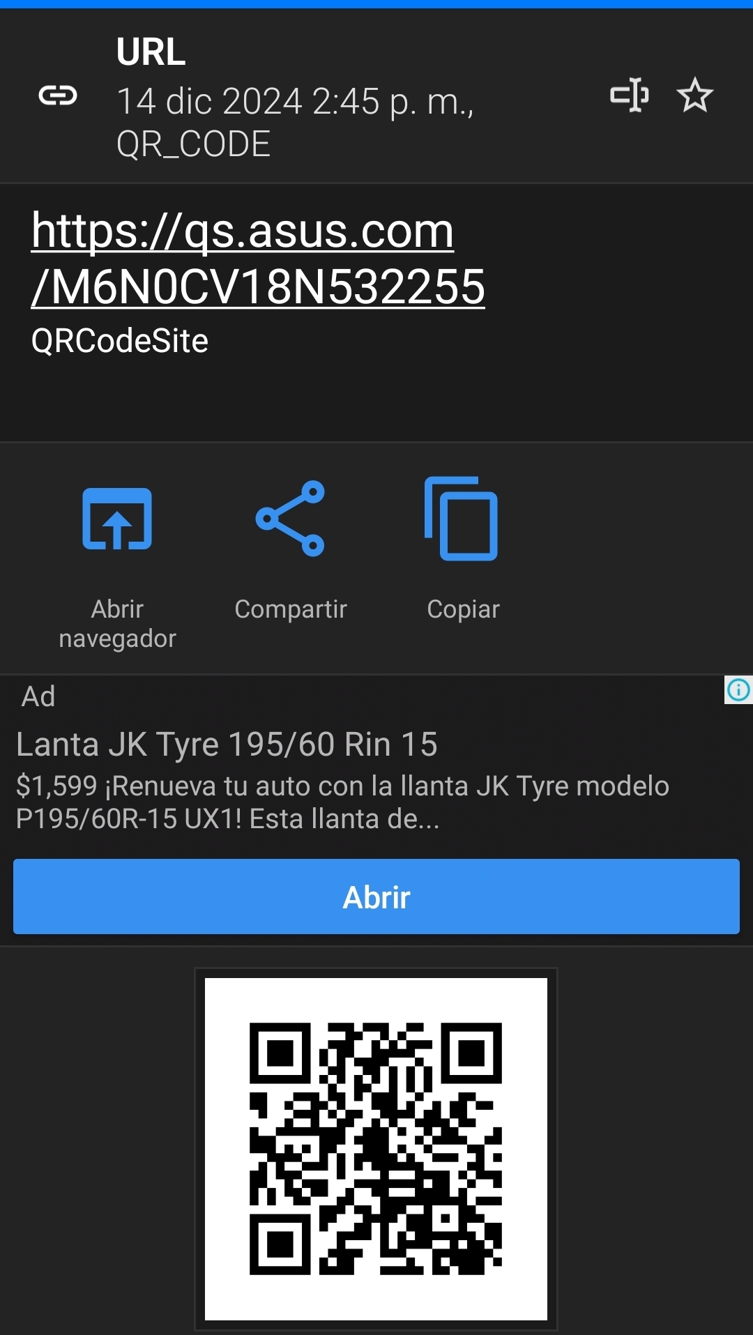

    Do you have the serial number ?
    • Txus3232
      • Apr 2024
      • 16
      • México
      Hi, yes i have the QR code from cover

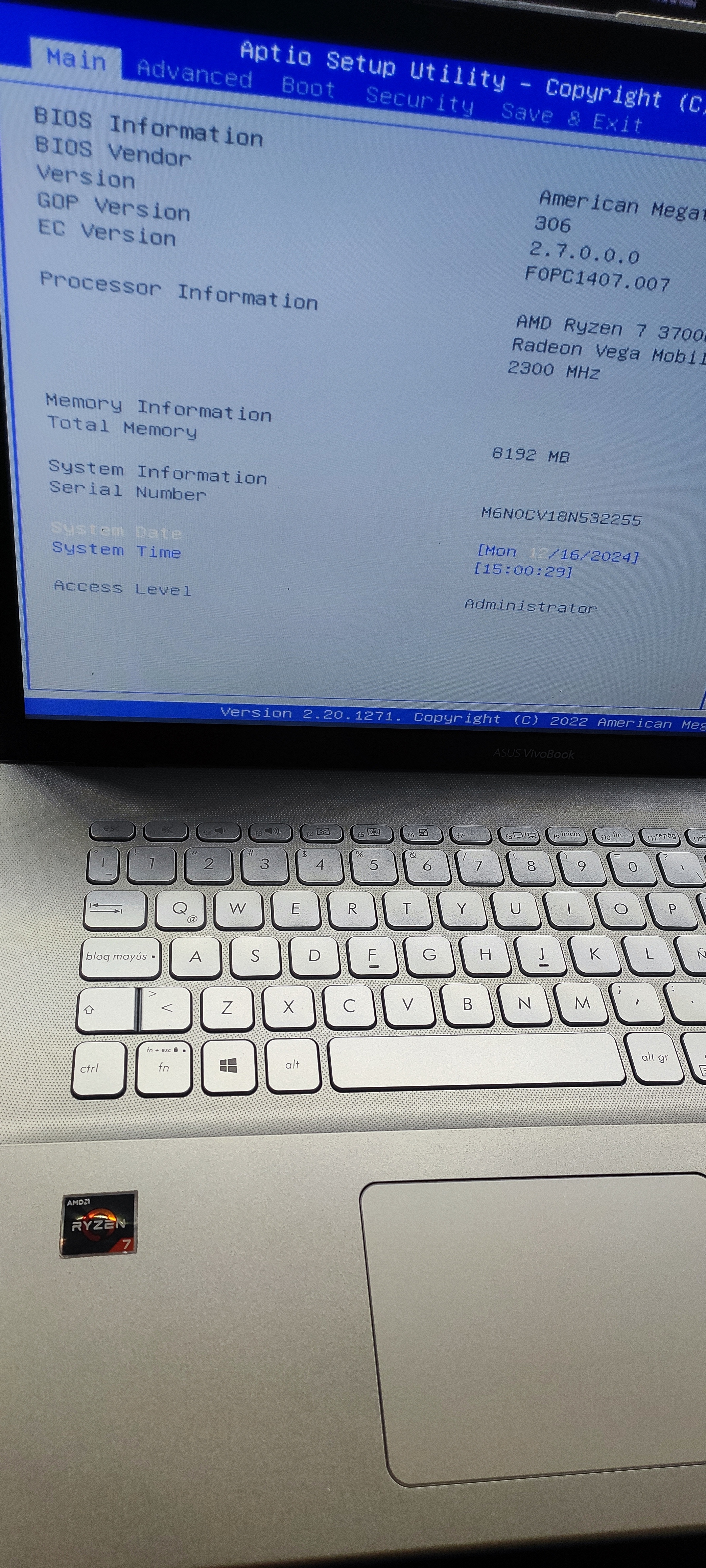

          Hello, thanks for the file, I also downloaded it from the support website
          but I had a question about how to write it in the bios,
          since it does not have the .bin extension, can you help me?
          • hoaca388
            Badcaps
            • Jan 2022
            • 11906
            Convert .360 to .bin
              • 21219
              Bios + DMI .
              • Txus3232
                • Apr 2024
                • 16
                • México
                Originally posted by SMDFlea
                Bios + DMI .
                Thank you so much, it's alive Again 🤩
