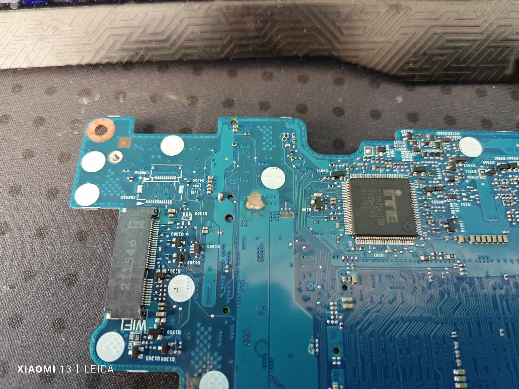

    Asus ROG STRIX G15
    Hi, i'm looking to fix my bios or any other bios.
    The fans and the keyboard/Leds dosen't work, i have replaced the keyboard and keeps doing the same.
    Model: Asus Rog Strix G15 (G513IE-R74AT5CB1)
    SN: N1NRKD006077028
    Mobo model: G513-6050A3249301-MB-A04(A4)

                Originally posted by OnRepair1
                I'd Tried that one already and keeps the same.
                So bios is not the cause.
                  • 21679
                  Did not work saddly, dosent do anything, no power no nothing
                  Maybe a corrupt EC. Check all the pins around the EC chip for dirt,corrosion https://www.badcaps.net/filedata/fet...2&d=1714139372
                    Is there anyway to fix the ec without external programmer? I can turn on the laptop and work with it, i don't know if there is anyway to do that because i dont have a programmer for that saddly
                      • 21679
                      Some EC chips on Asus boards will flash themselves from the EC code in the bios if a blank chip is soldered .Not sure if it will or not with this model, and it might not be the EC chip at fault, that`s for you to diagnose.
