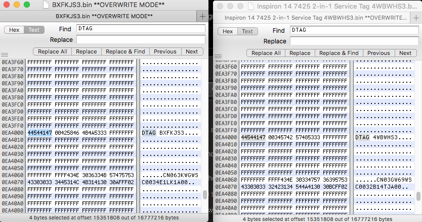

    Hey guys, could someone help me with fixed BIOS please, I'd be forever grateful as always!
    Model: Dell Inspiron 14 7425 2-in-1
    Service Tag: BXFKJS3
    Motherboard: 41242529 Ver: 1C
    Thank you!

    Try this :

      Thank you, I tried but I'm getting 'memory error', 2 amber, 5 white LED. I tried many different DDR4 RAM sticks, but still same error, do you think this could be a problem caused by BIOS? Thank you!

        Second try
        ...and put the Micron RAMs
        P.S.
        Check SHA1 of the .bin file , it must be 87714e01777a55740c550e9bd6b961f896ad25c2.
        If it's not then download again.
        (7-Zip has the calculator in Right-Click menu)

          Thank you for your help, I tried the second file you supplied, checked the SHA1, that was correct. This second file works better, the first file the machine was rebooting, with the second file the machine stays powered on, but still I am getting memory error. I tried the file from this post:
          https://www.badcaps.net/forum/troubl...37#post3296637
          and it looks to be working normally, but of course I need my Service Tag integrated. If someone could help with this I would be very great full. Thank you!

            you can do it yourself, open both files with HxD, search for text "DTAG" and copy/paste from 0EA4000 to 0EA4080. Also, your win key from 0EAA000

              I didn`t know about that DMI marker DTAG . I know that some of the older ones had $Tag
                me neither, i did search for his service tag

                  You the man Volinakis! Thank you very much for teaching me! I transfered over the service tag and windows key, everything looks great, thanks again for your help and continued support!

                    you are welcome. Is very useful to read Bios guides of this forum, you'll find very good infos how to do yourself bios modding.

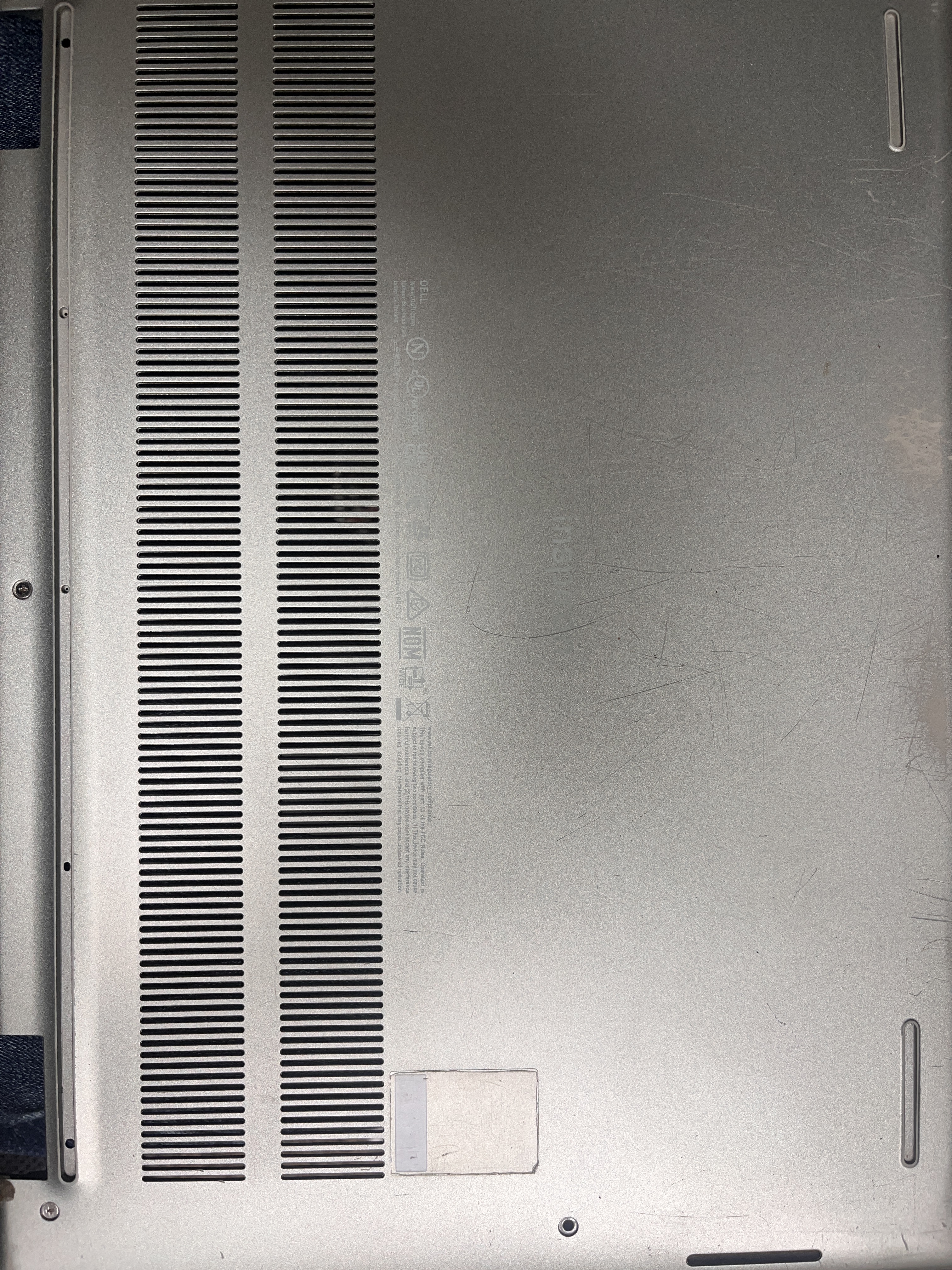

                              have a Inspiron 14 2 in 1 213084-1 no boot black screen all voltages present I'm assuming a failed bios update Can not read service tag its rubbed of bottom of case however original bios is attached if it can be pulled from it
                              post the service tag.....

                                Service tag 40KSSL3

                                  Thank you as it’s worn off the bottom of the case on this one
