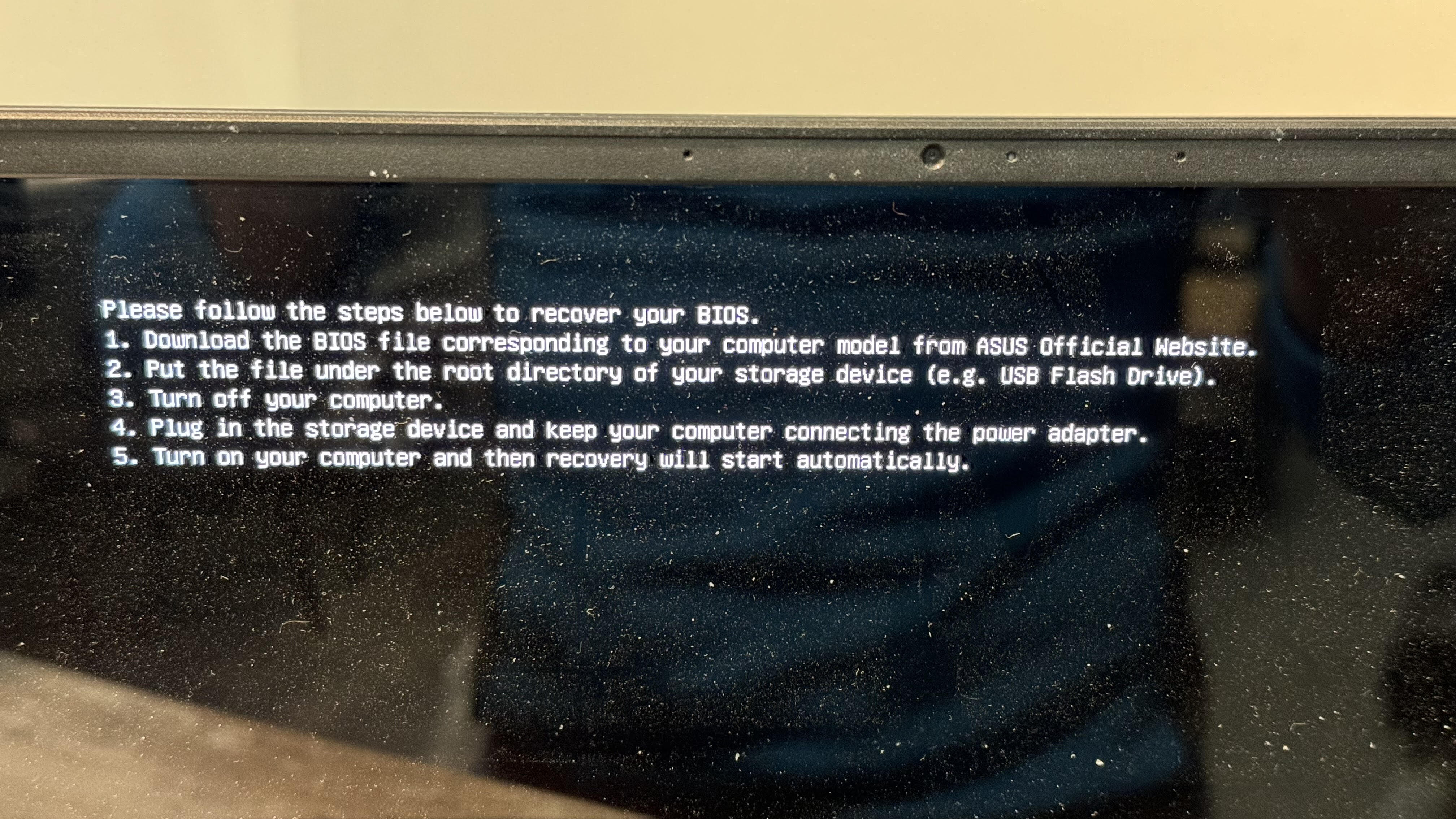

                            • Russia
                            Originally posted by hoaca388
                            UX3402ZA
                            After I programmed and soldered IC on the board - I received next messege on the laptops display - you can see it in the attachment.
                            Click image for larger version  Name:	12345.jpg Views:	0 Size:	1.27 MB ID:	3472579
                            I made all the steps from this instruction with or without battery with plugged AC Adapter, tried to use different flash drives with NTFS/exFAT partitions, but Asus Flash Utility didn/t start anyway. Where is the problem? Why laptop didn't start after BIOS programming?
                            • volinakis
                              • Jan 2021
                              • 2874
                              • N/A
                              put on USB disk only UX3402ZAAS.310 file
                              • pbls
                                • Apr 2019
                                • 12
                                • Russia
                                Already tried this way. in archive, without archive, tried different flash drives, with or without SSD on the board - no result, just the same message on the display every time.
                                • pbls
                                  • Apr 2019
                                  • 12
                                  • Russia
                                  UX3402ZA
                                  In this file I didn't find my serial number N4N0LP00W77515E
                                  Maybe problem is that one of BIOS regions isn't correct, because in my dump from the board I found the correct serial number
                                  • pbls
                                    • Apr 2019
                                    • 12
                                    • Russia
                                    I used another BIOS and it's fully worked. Laptop is fully worked. Problem was resolved. Dear, hoaca388 in your file there is a mistake somewhere.
