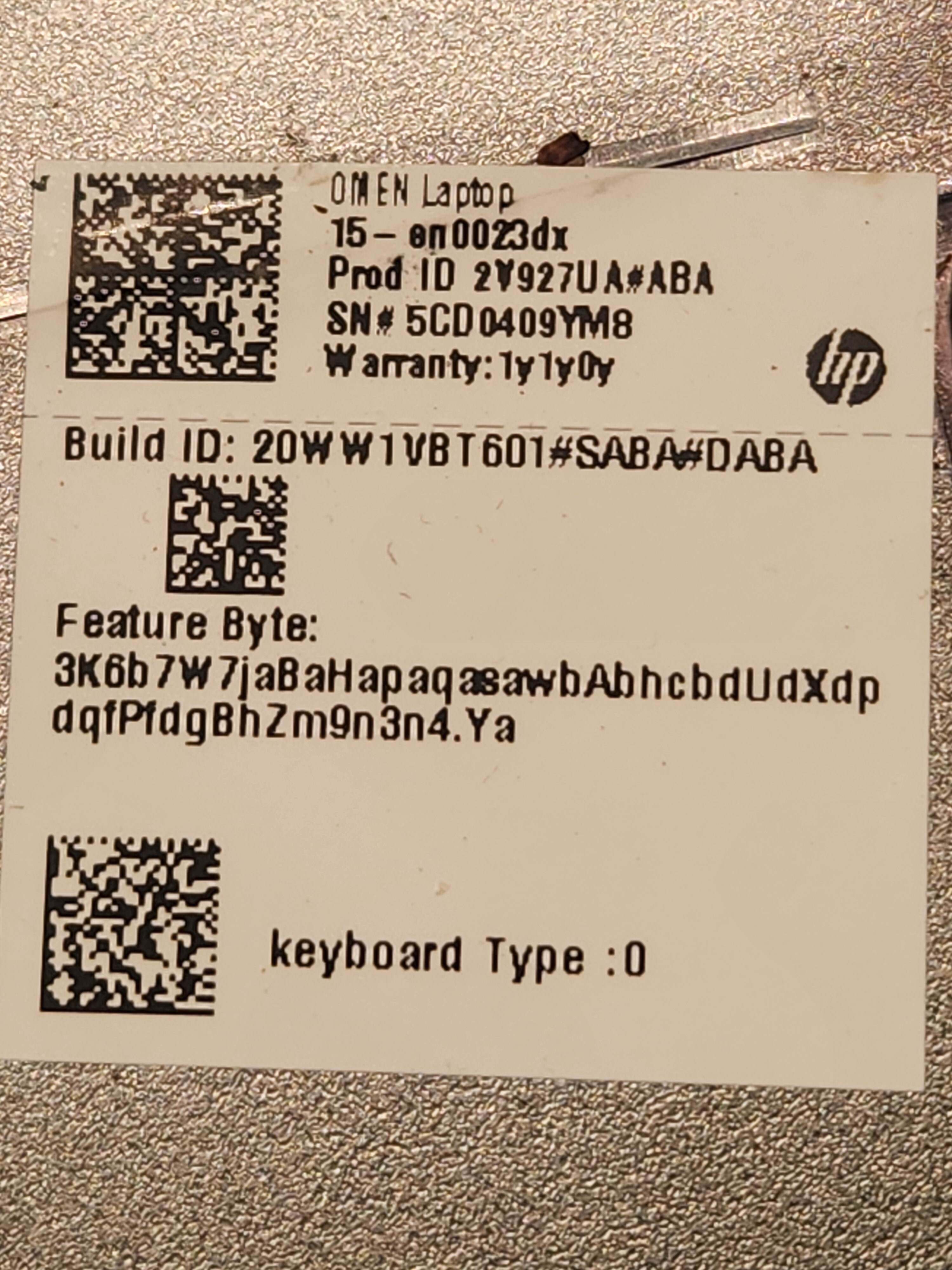

    HP Omen 15-en0023dx
    Need clean/clear BIOS dump for HP Omen 15-en0023dx please. I would like to setup this laptop like it came out of the box. I previously made a USB BIOS Recovery drive and used it, but the BIOS problems remained after it rewrote the BIOS. So it just kept the same problems present and the laptop is unusable as is. I would like to have a clear dump that I could install that brings it back to the beginning and then I could update it with BIOS updates to bring it to the latest release. This is my plan.

    Post your backup,the motherboard model number and laptop serial number -> https://www.badcaps.net/forum/troubl...before-posting

      I went to my recovery usb to: F:\EFI\HP\BIOS and tried to upload it, but I was blocked and said I can't upload a bin file. So i compressed it with 7 and attached it. Laptop serial number is: Click image for larger version  Name:	20240617_165639[1].jpg Views:	0 Size:	1.31 MB ID:	3292187 . I don't see a model number on the motherboard. Where can I find it ?

        Hi SMDFlea, sorry I didn't have what you asked before. I haven't done this before so I was clumsy and unprepared. I have now purchased and used a T48 programmer and got a dump from the laptop for you. I am attaching it now so you can help me. Thanks for your time in guiding me through this.

          See carefuly # 2, Next time you have to write down the serial number

            It worked!!!!! THANKS A MILLION!!!
