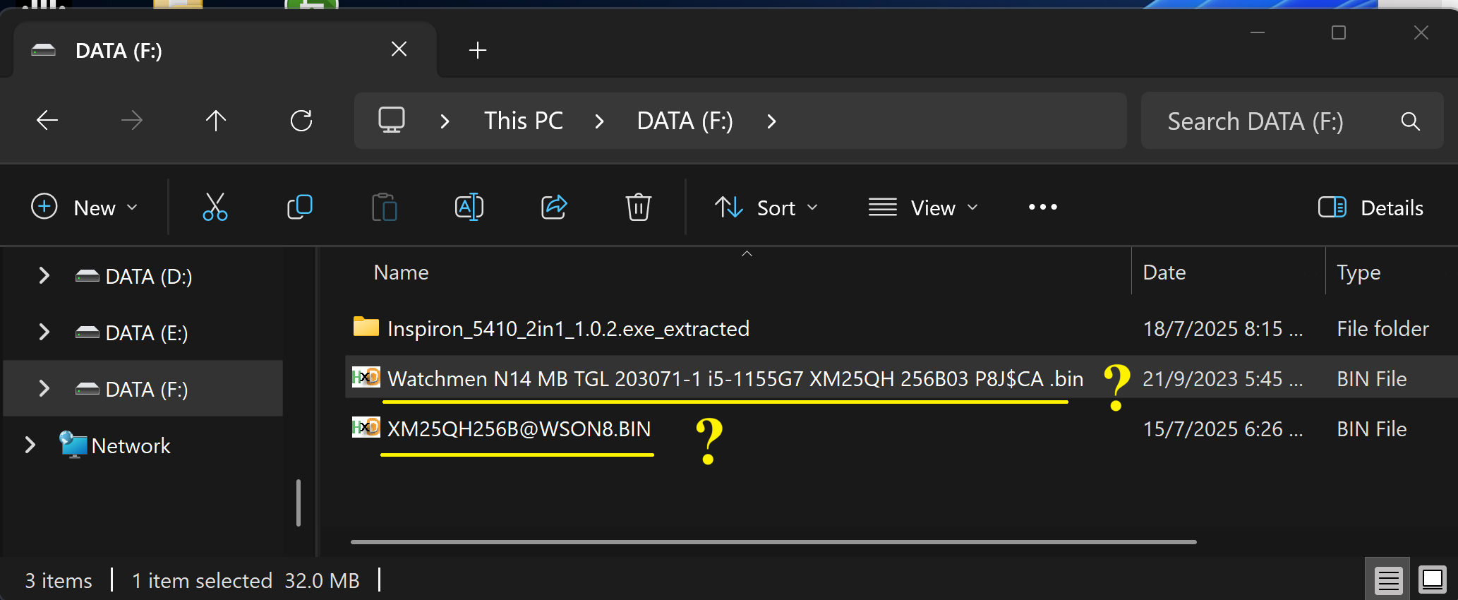

                              Hi everyone. Can you help me reprogram my BIOS. The KBC and Buck boost lines are fine. But I cant reprogram my bios with the original service tag ( CN0TX40JWSC0016A0HAFA01)

                                    Originally posted by M03CAT
                                    I'm sorry my bad. The ST number is 7T2NT93. Thanks in advance.
                                    Which file is the original file ?

                                        Thanks a lot man!. The XM25QH256B@WSON8 Is the original file that I extracted from the motherboard. And the Watchmen N14 MB TGL 203071-1 i5-1155G7 XM25QH 256B03 P8J$CA file Is the .BIN that I downloaded from here. 🙏
