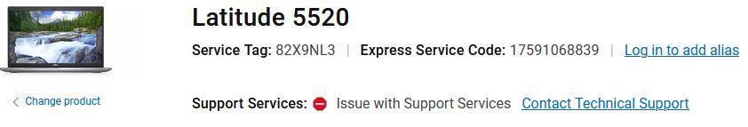

        SERVICE TAG: 82X9NL3

                According to the laptop cofiguration at dell support,it has vPro, so the bios will be 16 MB + 32 MB .There`s a problem with support services as well,which could possibly mean the laptop has been reported as stolen

                  Now I understand why they sold it to my client so cheap. Thanks for the contribution of the chip, I already found it in the diagram and on the board. say no to theft
