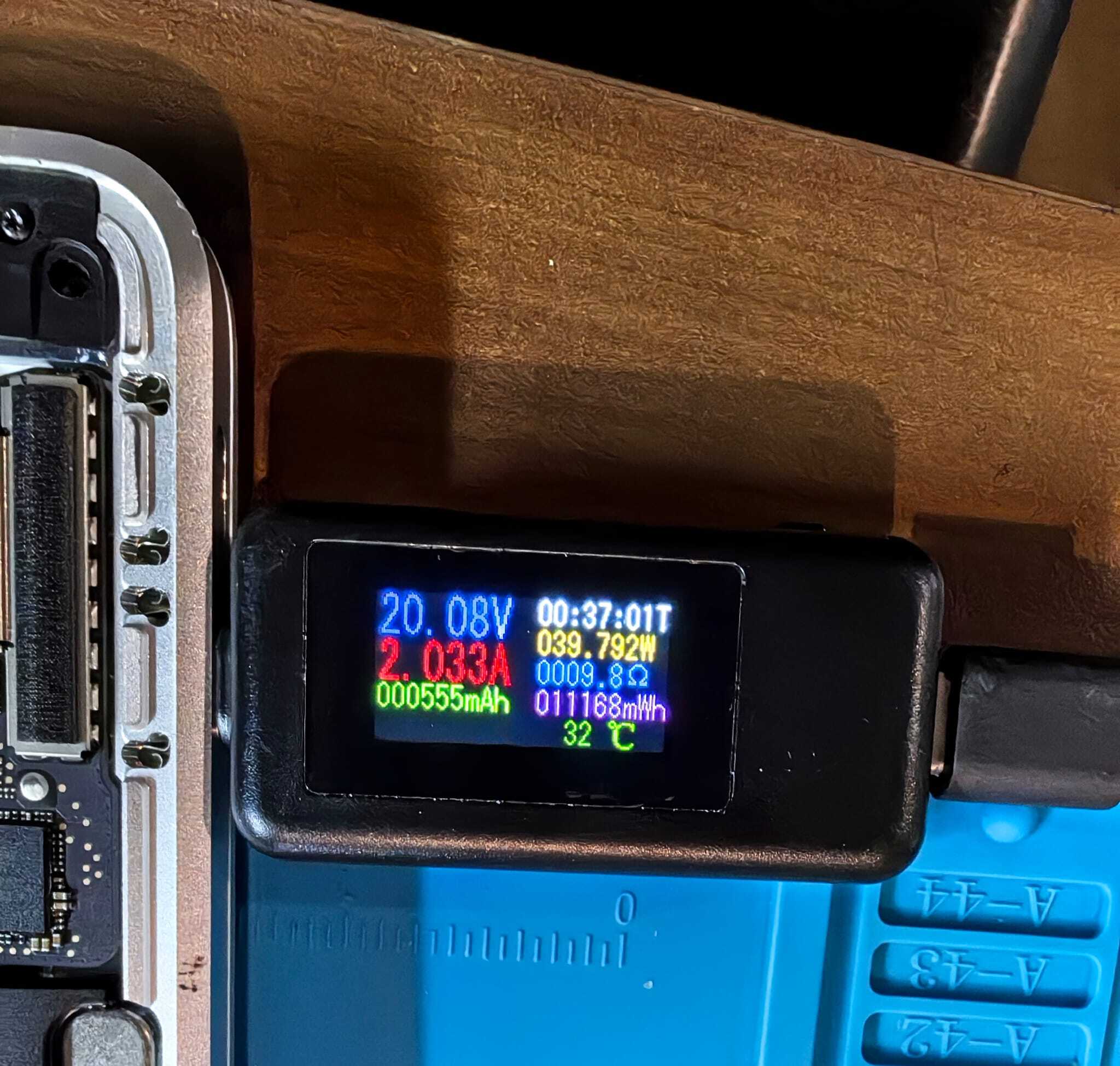

      The macbook was able to be turn on without any issue before i started the EFI unlocked, i used the same set of adapter.
      I didnt change anything like the memory chip or battery.
      Here is the attached pic of the USB Type C Meter
      Sorry I jyst started my journey unlocking and repairing macbook so I am unsure what are the steps you mention.
      How do I mesaure the voltage to ground of ppbus_g3h ?

        Do you see a gradual increase of the current draw or is it a fixed value? 20v is good. Current draw looks normal.
        Do you have a led toggle when pressing the caps key? If yes, the logic board has booted. Apply a flashlight to the front side of the display to check if you have any graphics.
