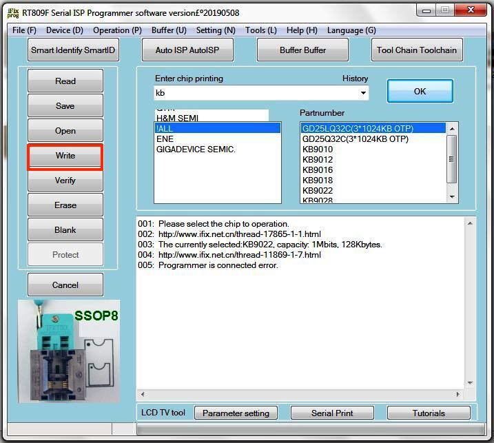

          My chip programmer only reads.(RT809F) I ordered a new programmer. I'll get back to you when I try it. Thank you.
          • volinakis
            • Jan 2021
            • 2820
            • N/A
            what??? Click image for larger version
            • ahmypc
              • Oct 2013
              • 79
              • Turkey
              Pro 9 bios chip ID W25R256JW and although this programmer(RT809F) shows the chip ID incorrectly, it can read but cannot write. RT809H supports this chip.
              • volinakis
                • Jan 2021
                • 2820
                • N/A
                if it's JW select 1.8V and W25Q256JW
                • ahmypc
                  • Oct 2013
                  • 79
                  • Turkey
                  It already shows it in automatic identification ( W25Q256JW), but it does not verify the data.

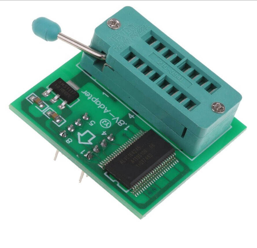

                    You need soket rom 1.8V for it
                    • ahmypc
                      • Oct 2013
                      • 79
                      • Turkey
                      I know. I've already studied with him.
