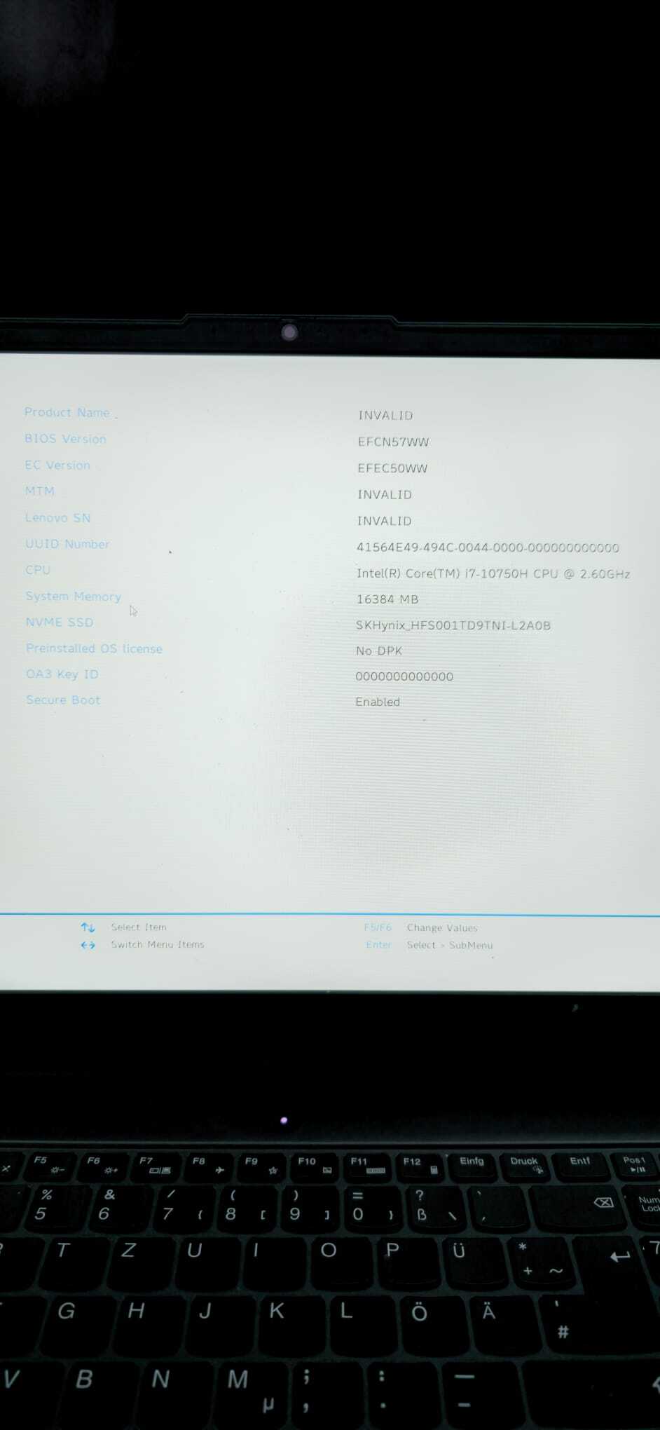

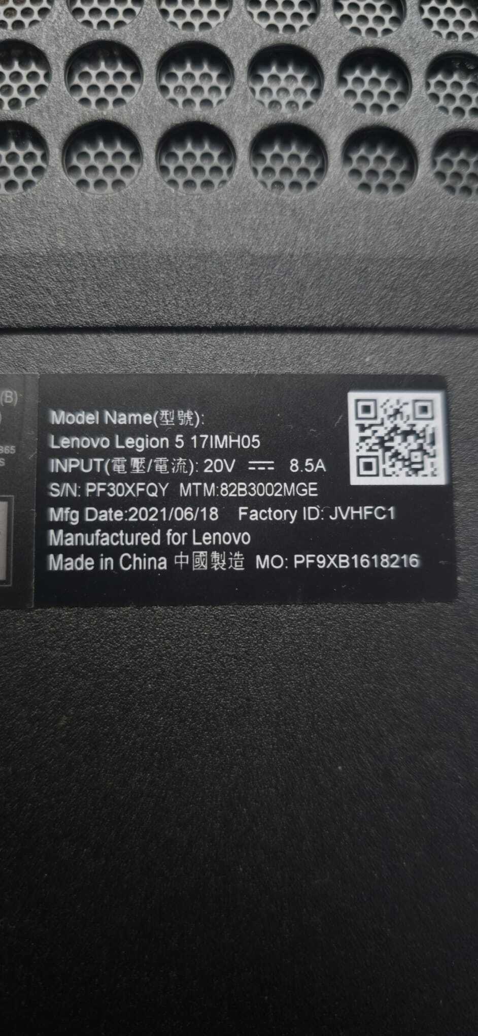

                Hello, I need your help. I have a Legion 5 17IMH05 with serial number PF30XFQY
                Here is the link to the device:
                https://pcsupport.lenovo.com/de/de/p...xfqy/downloads
                The problem is that the device no longer starts. I have a black screen and the fans run for 3 seconds then the device switches off and starts again. I read the BIOS with a CH341A and the NeoProgrammer program.
                Can you tell me from the bios dump whether everything is OK or whether I should import a new bios ?

                    try the bios from post #2..
                    https://www.badcaps.net/forum/troubl...mp#post1726131
                    • BlackBeetle
                      • Apr 2024
                      • 18
                      • Deutschland

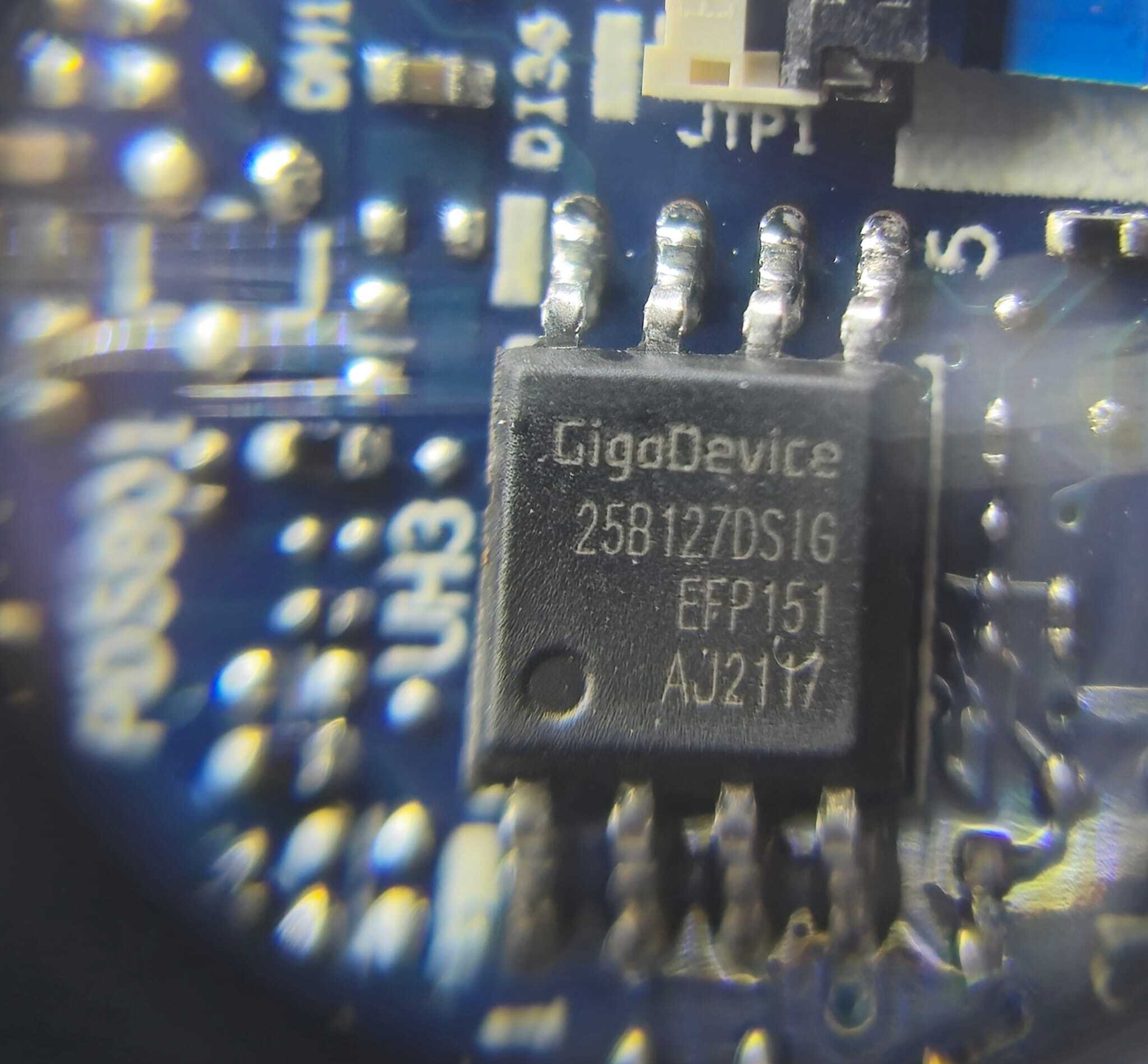

                      I installed an NVIDIA GeForce GTX 1650 Ti - 4GB. That's not a problem with the bios from post 2?
                      Edit: Yes! It works again! Is there a way to add the serial number and this other information?

                        Try this posted bios if you have any issue than flash previous bios and use dmi toll to fill the dmi information
                          • 22293
                          Copy the DMI from your backup to the new bios from post 2 using a hex editor, offsets 532000 - 533FFF​ or try the attached script,see the README text file
