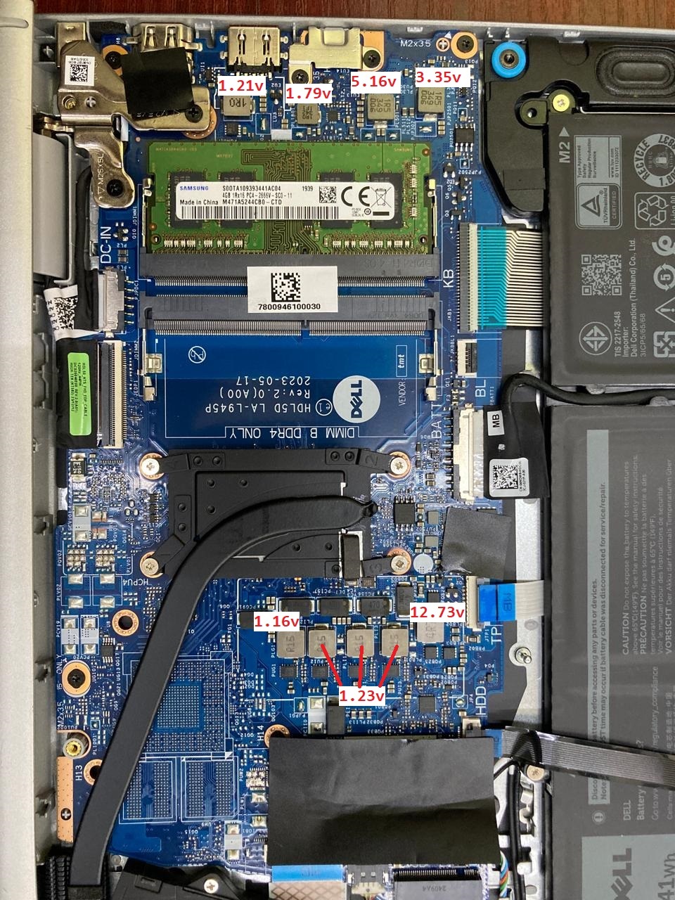

                        Hi.
                        Laptop powers on, Caps Lock light always on, No video.
                        Did measure voltage on all main coils, all voltages present.
                        HDL5D LA-L945P Rev 2.0
                        Dell Inspiron 15 3525
                        ST: GPH4134
                        Thx in advance.

                          #112
                          Originally posted by iplaypty
                          Hi.
                          ST: GPH4134
                          Thx in advance.
                          try and feedback
                          • iplaypty
                            • Aug 2017
                            • 50
                            • FLORIDA
                            #113
                            Originally posted by LBTT1121
                            try and feedback
                            Still having the same problem. Click image for larger version
                            tested with different RAM modules and disconnected most things.
                              Change ram with 3200MHz...
                              • iplaypty
                                • Aug 2017
                                • 50
                                • FLORIDA
                                #115
                                Tested with 3200Mhz RAM module too. Didn't work.
