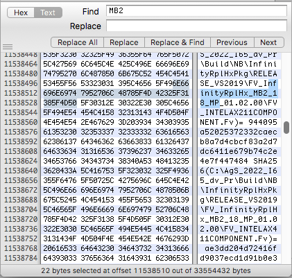

    Hello guys i have a dell Alien ware m16 R1 that has boot loop.
    It displays alien ware log then goes off and the sequence repeats its self.
    board number: 213260-1 INFINITY RPL-HX+NV-P
    S/N/ Service Tag: 3RZ0FS3
    Reg model: P124F
    Old file is attached
    i need your help guys
    thanks

    try. let it run for 2 mins, it will restart several time with no image.

      with this dump the machine acts as if completely dead. nothing happens no fan spin no nothing

        check soldering, bios is a virgin one from update and with clean ME.

            ok, try this only clean ME version, in previous one I was updating bios region to 1.12, also ME to 16.1.27.2225.

                try an older bios version. In your dump it says is ver.1.02 but it doesn't exist in bios updates.

                    there are 4 bios images in extracted update bios, try them all. I assumed that your bios is InfinityRplHx_MB2_18_MP because of data I found in your dump, but maybe it was a failed bios update from windows updates and is wrong.
