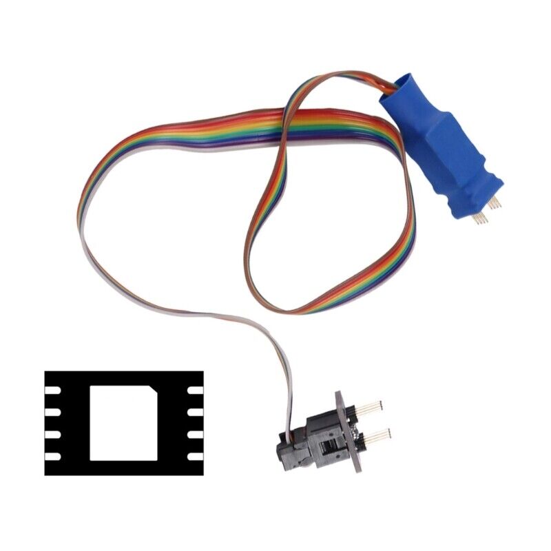

    Hi
    i have some problems reading out the 16mb chip on Keyboard Side.
    The 32MB Chip memory side i can read out but for unlocking i need the 16mb chip for the G5 series right?
    I use the Revelprog IS and WSON 8 6x8 Pins.
    Photo attached.
    Any idea?
    tried with ac adapter and without also with VPP 3V and disabled

    Any file will do

      What do you mean any file will do? i can use the 32MB Dump for unlocking?
        Yes .

          Yes tried with RC Unlock but says find 16MB Dump
          tried old unocker V1 from here, i get bin file unlocked back but password still remain, lil bit confused
            i find out the failure the programmers protection buffers are blown
            thanks to all will try with ch341
