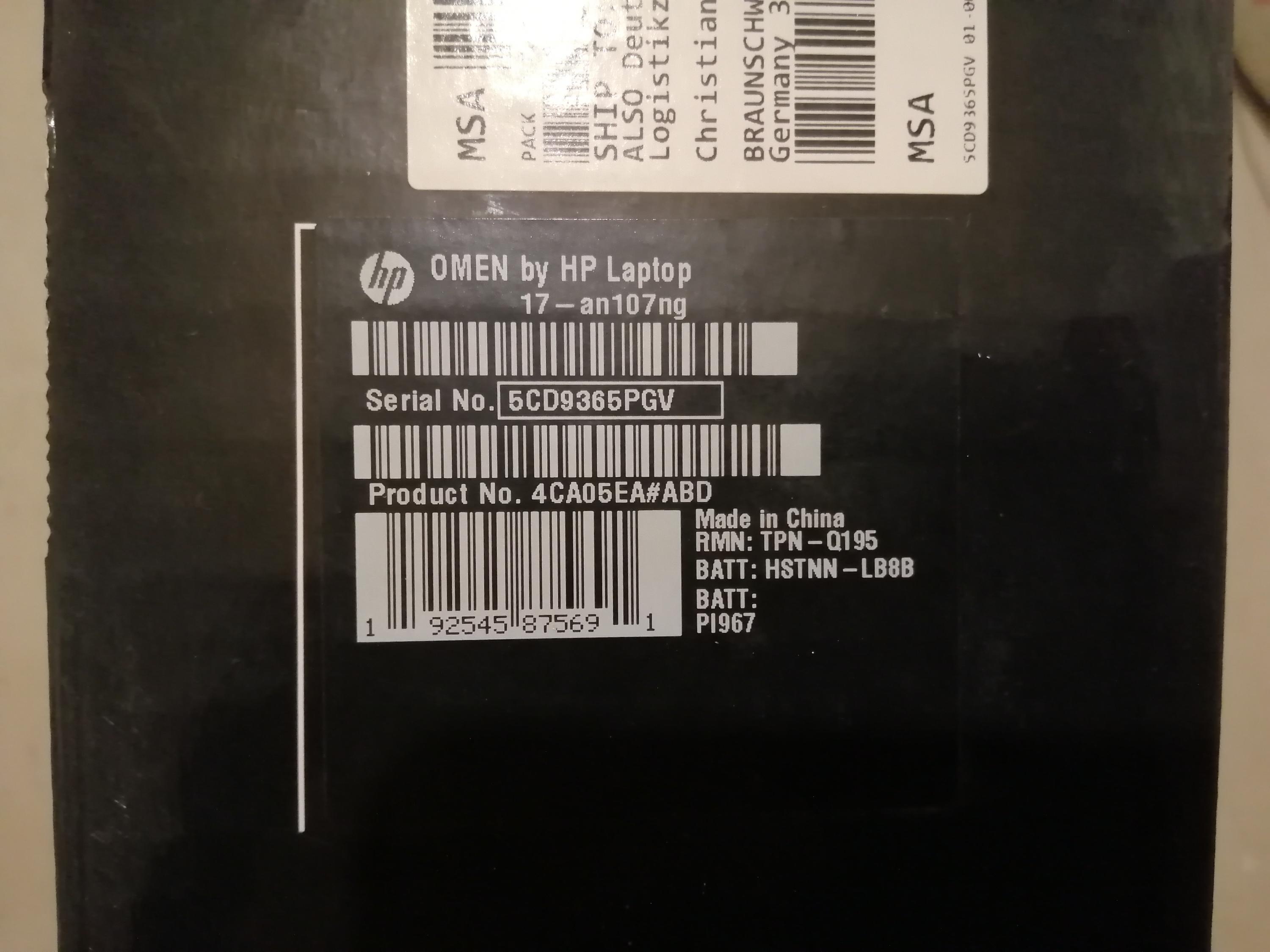

        Re: Bios HP Omen 17-an107ng G3BE N17
        The Sticker on it
