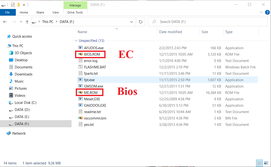

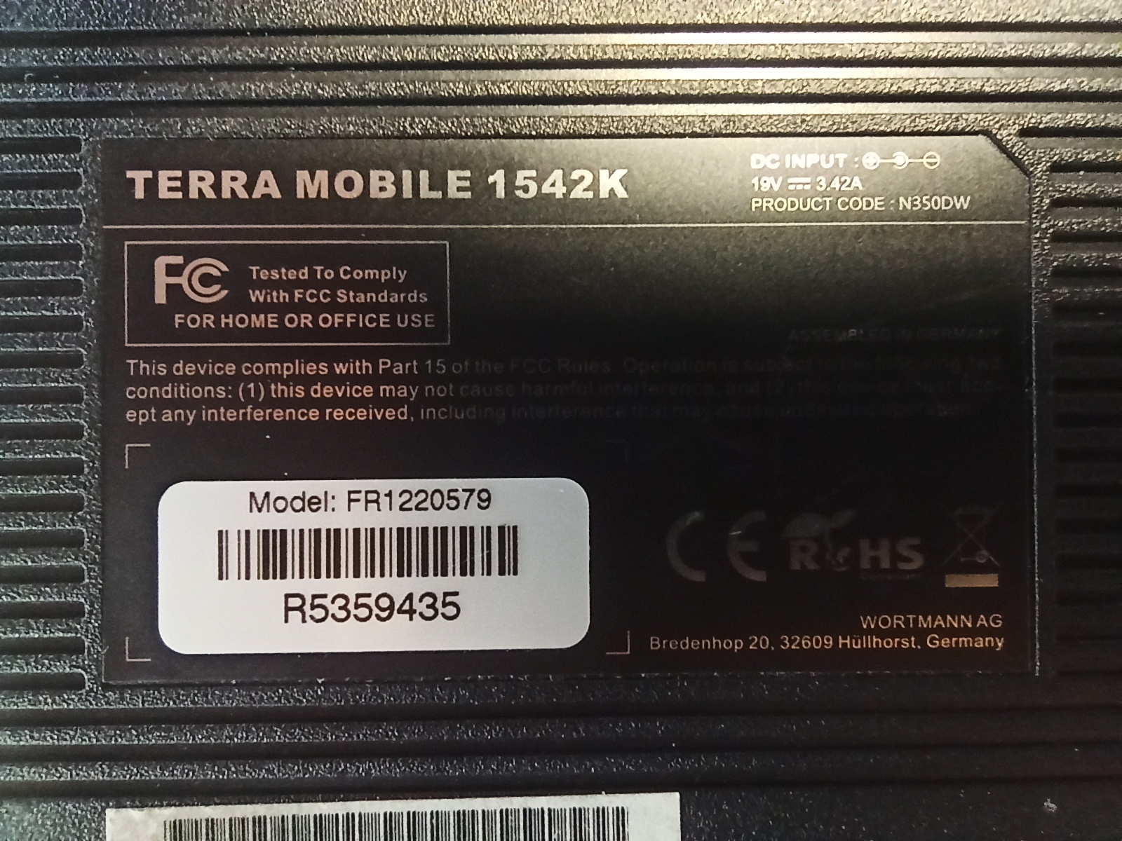

    I made a mistake when running bios/EC/ME update on a Terra Mobile 1542K.
    In fact it is a CLEVO N350DW.
    We can find service manual here :
    https://cdn.badcaps-static.com/pdfs/...c8a7609b11.pdf
    This motherboard has 2 IC CHIP :
    - ME ROM
    - BIOS ROM
    We can find all the files bios, ec... here :
    https://my.h******************************3xxx/N350DW
    I can program chips but I don't which file to take for each chip.
    Someone could help me ?

        Could you explain how to program this ?
        Because the files BIOS.ROM is 5MB and the BIOS+EC chip is 8MB and ME.ROM is 16MB and the ME IC chip is only 8MB !
        I am new with bios programming

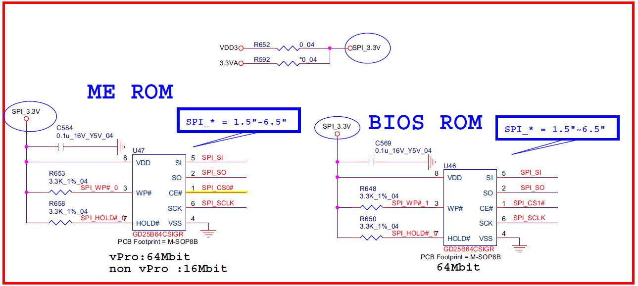

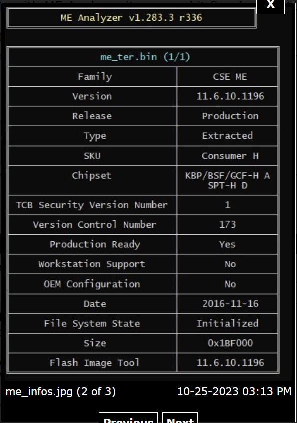

          So my laptop is a CLEVO N350DW.
          After a bios upgrade and an error, the laptop boot but I have a black screen and the fan is spinning.
          So I think I need to flash the two IC chips.
          Both chips are GD25B64CSIGR so 64Mbit => 8MB, aren't they ?
          I can find thanks to a link on this forum BIOS.ROM and ME.ROM but there are two problems :
          - BIOS.ROM is only 5MB so how to flash it on the 8MB IC chip ?
          - ME.ROM is 16MB ! The IC chip is only 8MB so how to do ?
          We are agree that BIOS.ROM goes into U46 ?
          And ME.ROM goes into U47 ?

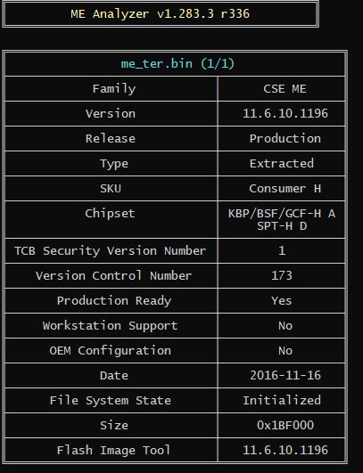

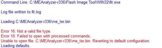

          I backup my two chips and I tried to load my me bios into Flash Image Tool but I have an error (see picture).
          When I analyze file with ME Analyzer it can read it fine (see picture).
          Please help me

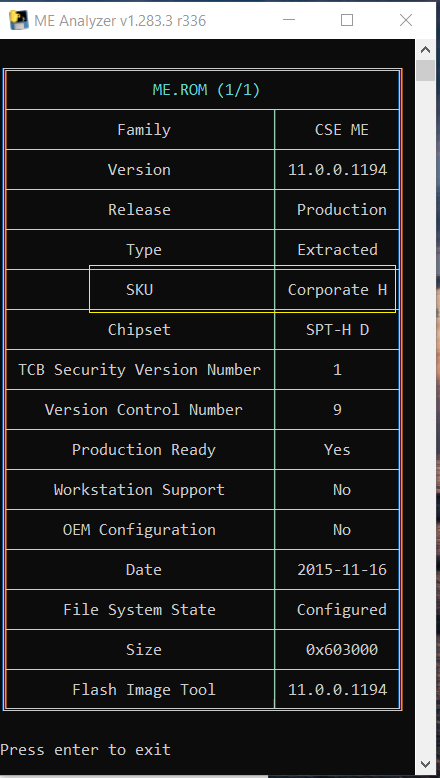

                Originally posted by sauce
                Yes I am looking but ME.ROM has a size of 16MB !
                My IC CHIP for ME ROM is only 8MB so I don't understand.
                It's not a matter of just dividing the bios file, the problem is this. Are you sure the model is CLEVO N350DW
                      My motherboard is :
                      6-71-n3500-d02
                      And yes it is a N350DW
                      Where did you get the me_ter.bin file ?
                      • sauce
                        • Sep 2013
                        • 146
                        • France
                        Re: Terra Mobile 1542K
                        me_ter.bin => it's my U47 IC CHIP third backup
                        But cannot be loaded by Flash Image Tool don't understand why (MEanalyzer can read it)
                            ok thank but explain me how to flash
                            BIOS.ROM is 5MB so I flash it directly on my U46 so the last 3MB will be blank ??
                            And which outimage I take the first one ??
                              Bios.rom is only 512Kb, actually this is EC file, flashed to U47 IC CHIP (To be sure, I need the name of this chip)

                                  Sorry but i don't understand the relation between the 2 IC CHIPS (16Mbit / 8MB each) and files BIOS.ROM and ME.ROM of the clevo zip file !
                                  I thought :
                                  - BIOS.ROM goes into U46 as it is written "BIOS+EC" on the board
                                  - ME.ROM goes into U47 as it is written "ME" on the board
                                  But it's not like that ?
                                    I thought :
                                    Something needs to be clarified:
                                    Me.rom will flash Outimage1.(it contains ME region )
                                    Bios.rom will flash Outimage2
                                    For now, don't pay attention to the BIOS.rom file (512Kb)
