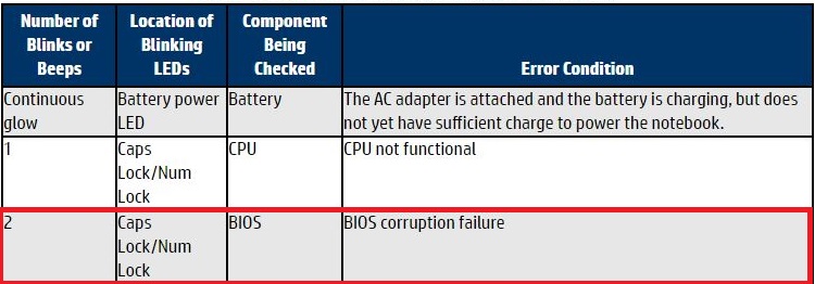

        problem : black screen
        caps lock blinking 2 times
        it's means bios error
        anyone have bios file
