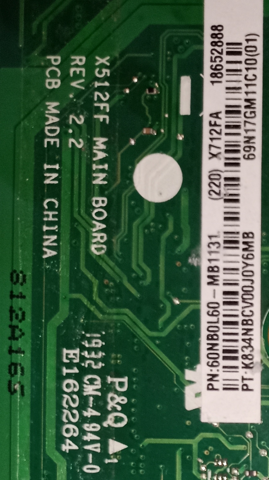

    I need BIOS file for ASUS VIVOBOOK 17 X712F.
    Motherboard number : X512FF REV 2.2
    This one is without a discrete GPU.
    the dump file is attached downside.
    Thanks in advance.

      If the bios at post #2 doesn`t work post a picture of the long white barcode sticker,near the ram slots
      https://www.badcaps.net/forum/showpo...04&postcount=2
          Here it is, Hope you can help me.
          Thnx

                Originally posted by qayyum786
                you didn't mention the actual issue of your laptop
                is it no pwr or no image
                The laptop powers on but there is no image.
                All the power rails are present exept for one going the cpu i think it's VCCGT but im not sure (schematic isn't available).
                The VCCGT is present at the beginning then turns off but the power good signal is HIGH so i think the cpu is requesting it off.
                The laptop comes with Onboard RAM, i tried to disable it by editing the BIOS but no luck.
                Any help i woud appreciate.
