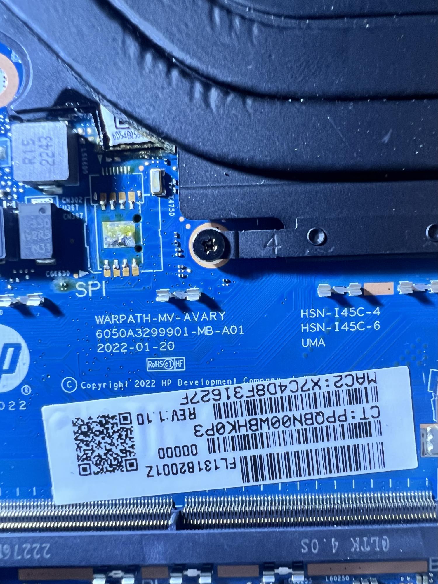

    Hp elitebook 840 g9
    hello need bios unlock for Hp elitebook 840 g9
    i didnt find solution to patch those files
    i got two files 32mo
    • aminetiaret
      • Aug 2018
      • 9
      • algeria
      Re: Hp elitebook 840 g9
      here is motherboard pic
      and system info pic also
        flash this file then add info
          didnt work flashed and still have password
          • black0hackers
            • Jul 2020
            • 367
            100% password removed
            if not you are doing wrong
              what should i do just write the dump ? or should i do something else ???
              • volinakis
                • Jan 2021
                • 2820
                • N/A
                write bios file provided by black0hackers and 1st thing to do is to reset bios to factory defaults, save, restart and password will go on. Then, in Main tab you have "set machine unique data" and write there what it's written on the label inside the bottom cover. Or extract DMI from your bios dump:
                  lot of thanks worked 100%
