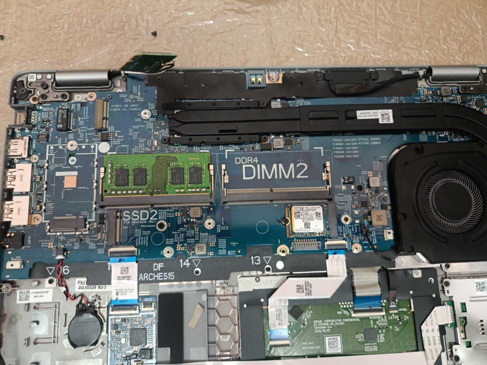

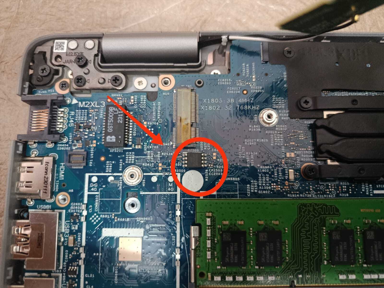

          HI there,my dell Latitude 5540 has a bios lock.I am not able to find where is the bios chip on the motherboard.
          Would you please give me some help and show me where the bios chips are located?
          board number:Arches 15 DDR4 MB, 223032-1
          service tag:63nwky3
          Thank you very much.
          • danito
            • Jun 2016
            • 1259
            • Romania
            #105
            service tag:63nwky3
            here

              #106
              HELLO . please unlock this bios
              dell 5540

                  #108
                  dell 5540
                  ST : BC4KKS3-8FC8
                  This not the main bios
                  See picture at post #104 to identify your bios location

                    #109
                    is that the man bios ?

                      #110
                      You must find d Files 256 (= 32 mega) write on it

                        #111
                        is that ?

                          #112
                          is that ?
                          No , this is your EC dump and it's a 16 mega..it's written on it 128...you must find the other chip with 256

                            #113
                            i found it thank you

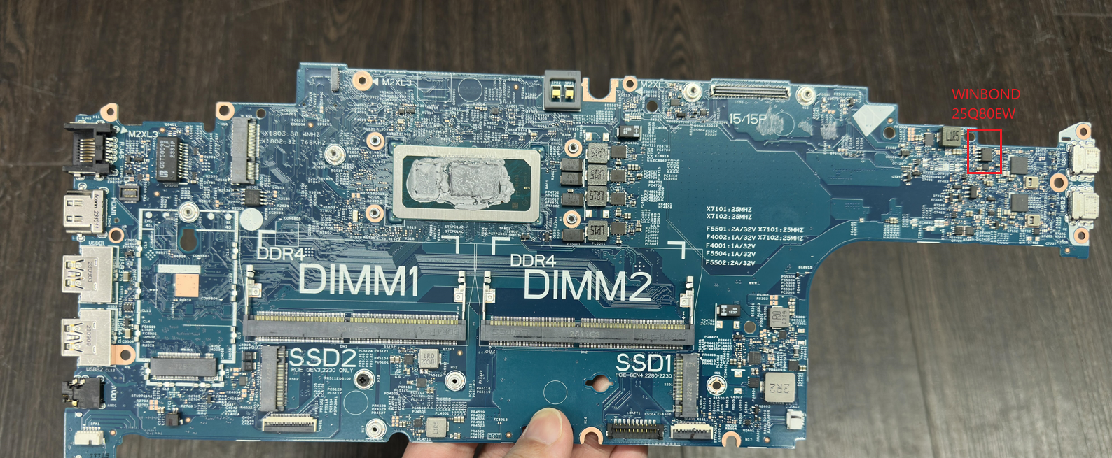

                              • Jason55
                                • Apr 2025
                                • 9
                                #115
                                Originally posted by danito
                                here
                                Thank you so much.
                                BTW,would you tell me what does this WINBOND 25Q80EW do?it is a 8Mb chip.
                                  SMDFlea commented
                                  Editing a comment
                                  It is 8 Mega bits, which is 1 Mega Byte .8Mb = 1MB .That chip is for thunderbolt firmware or something else, it isn`t the bios chip.

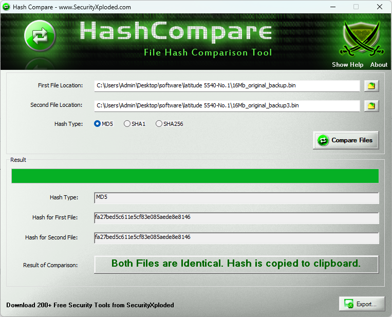

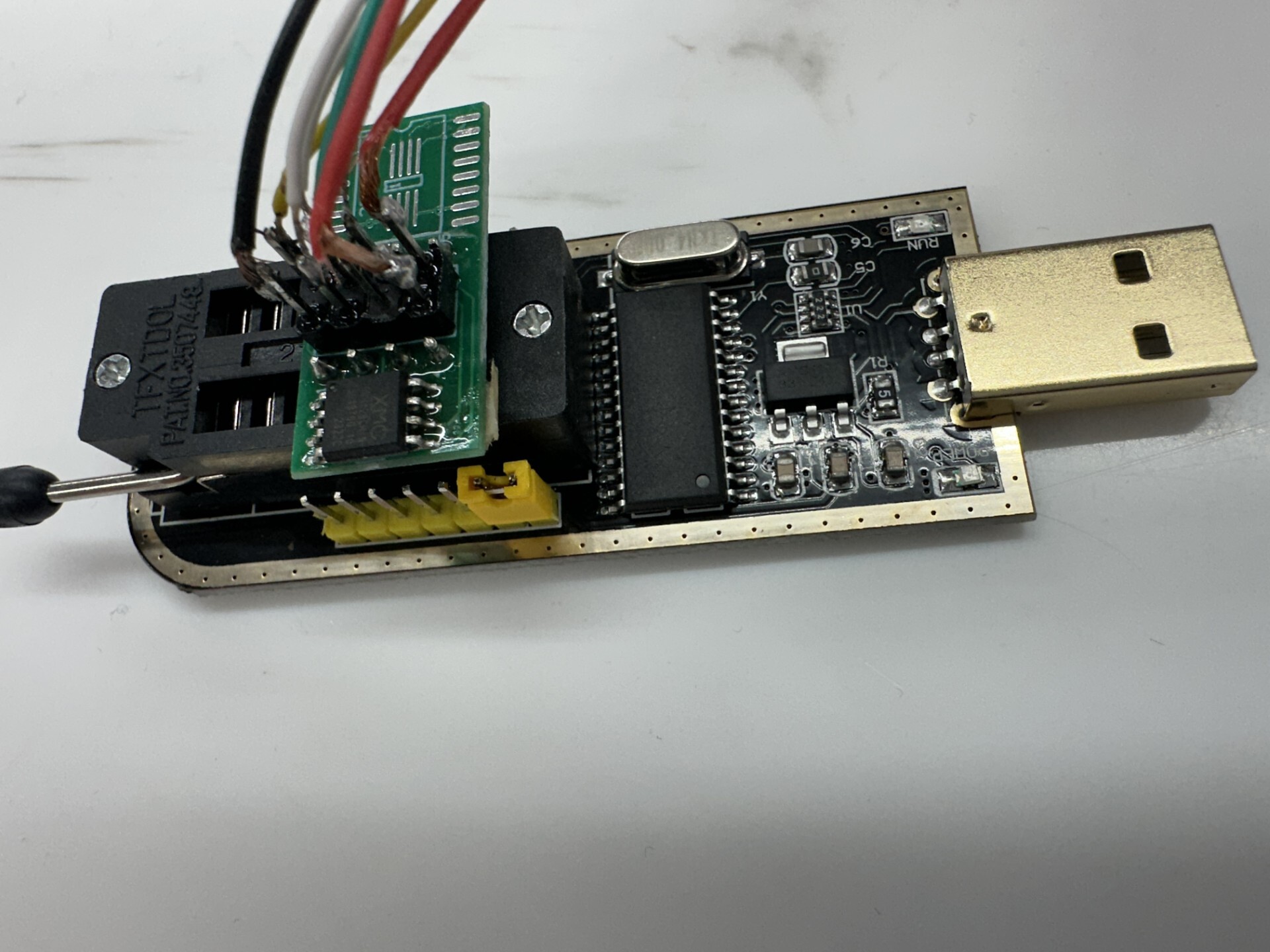

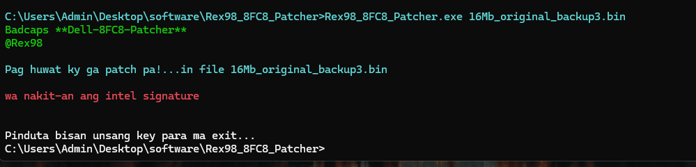

                                  Hello everybody.
                                  I soldered a bios chip(XM25RH128C) to CH341A adaper and got a bin file.When I tried to patch it,patcher show an error "wa nakit-an ang intel signature".
                                  I tired three times and all the bios files have the same MD5.
                                  The programmer software is AsProgrammer_2.1.2.
                                  I am sure the bios chip is soldered correctly.
                                  Would someone can help to check where is wrong to me?
                                  Thank you so much.

                                    #118
                                    Hello everybody.
                                    Thank you so much.
                                    SERVICE TAG:63NWKY3-8F8C
                                    Wrong chip. Select chip with number 256.

                                      #119
                                      Hello,thank you for your reply.
                                      The 5540 motherboard has 2 chips related to bios.One is 16MB(XM25RH128C),and the other is 32MB(XM25QH256C). We only need to read,patch bin file and then re-write the 32MB chip,is that right??
                                      Thanks.
                                      • hoaca388
                                        Badcaps
                                        • Jan 2022
                                        • 12441
                                        #120
                                        Thanks.
                                        Yes .
