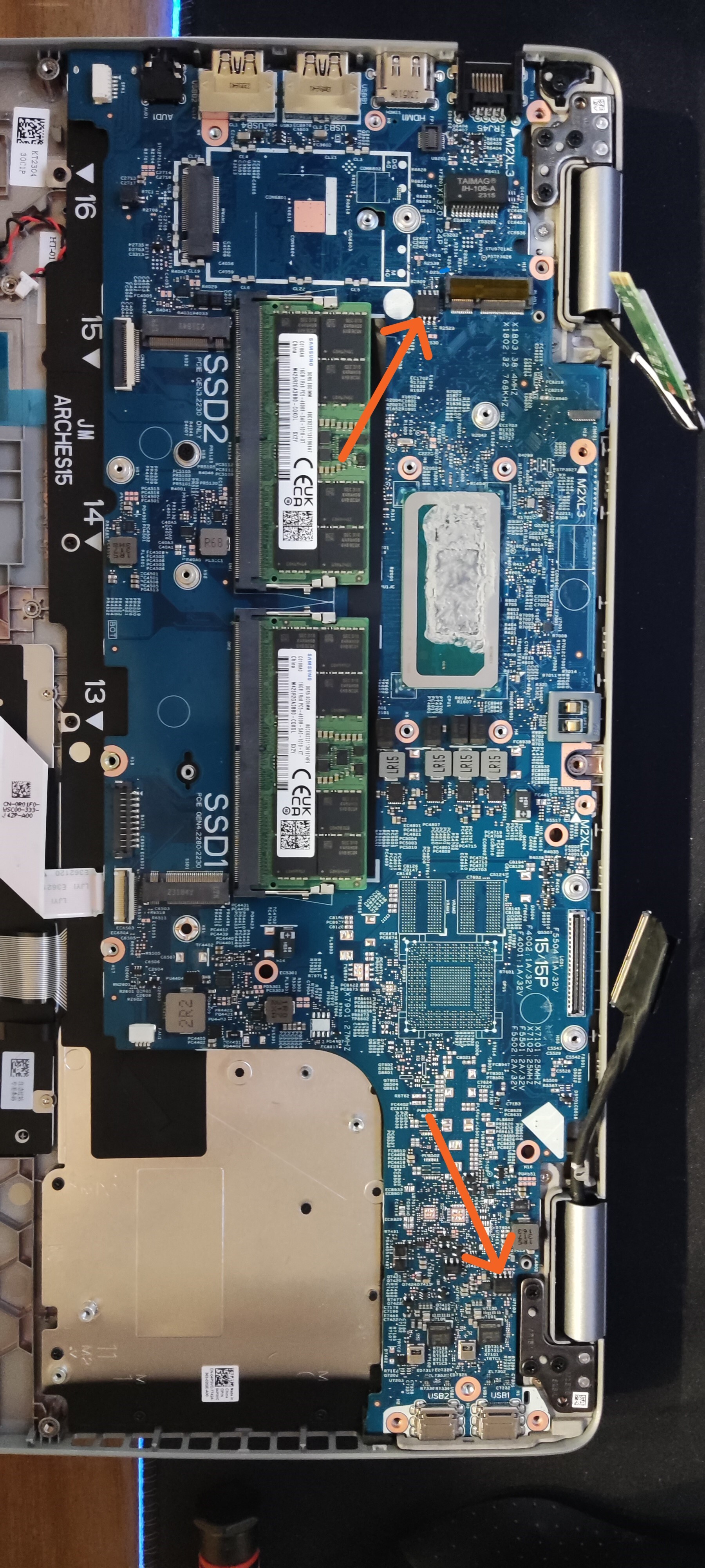

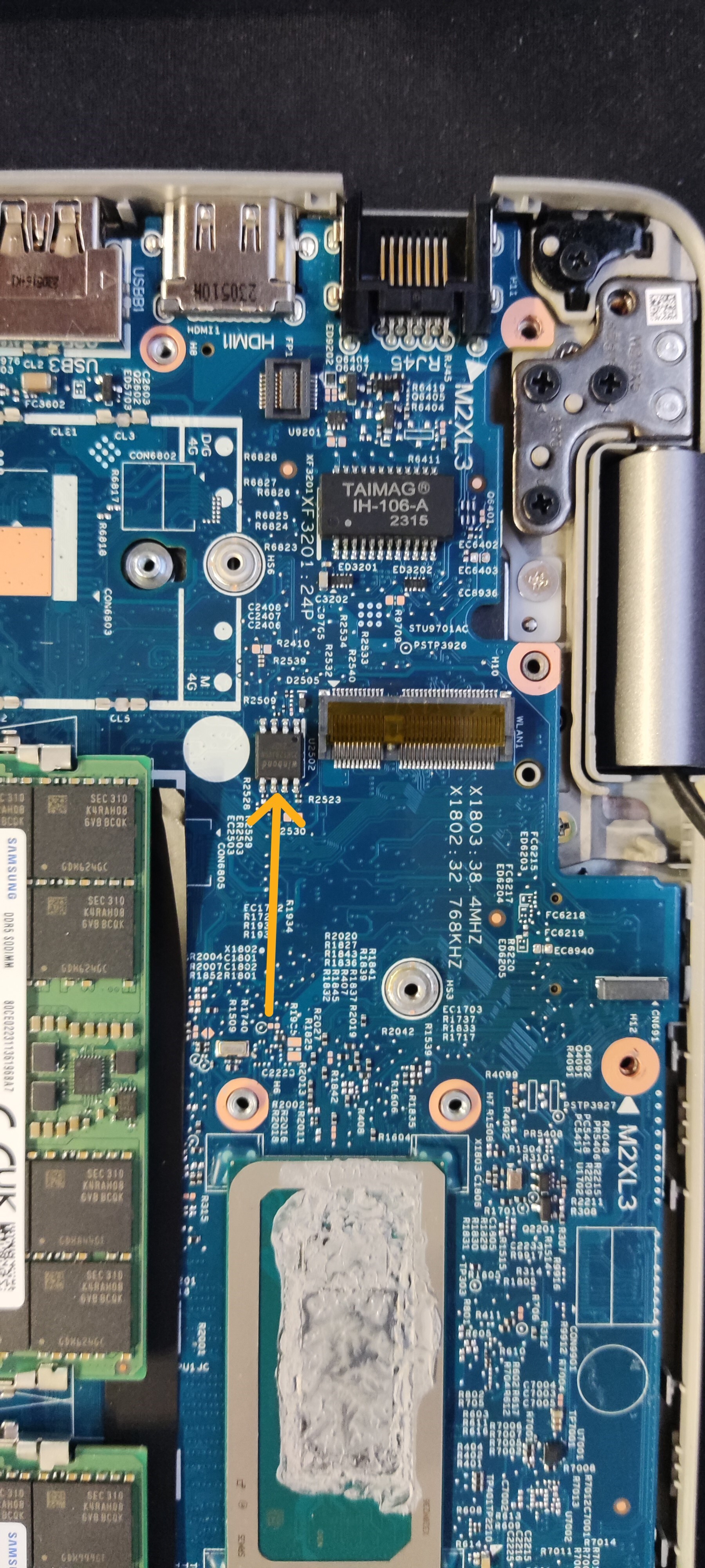

              #46
              Originally posted by hoaca388
              You have selected the wrong chip with the IC1 file.
              The Latitude 5540 model has two chips: one chip containing the bios part (32MB), one chip containing the ME part (16 MB)
              So: the number 128 gives us 16MB of data. For example: 25Q128JVSQ
              The number 256 gives us 32MB of data. For example: 25Q256JVSQ
              Oh sorry for that,
              i'm a noob in BIOS Chips reading and writing. i just can't find the other Chip that has the 256 in it. I attached pictures of the board, and marked the two IC's (1M and 16M) that i was able to find. Maybe you can help me locate the 32M IC? On the backside of the board are no such IC's at all.
              THX in advance

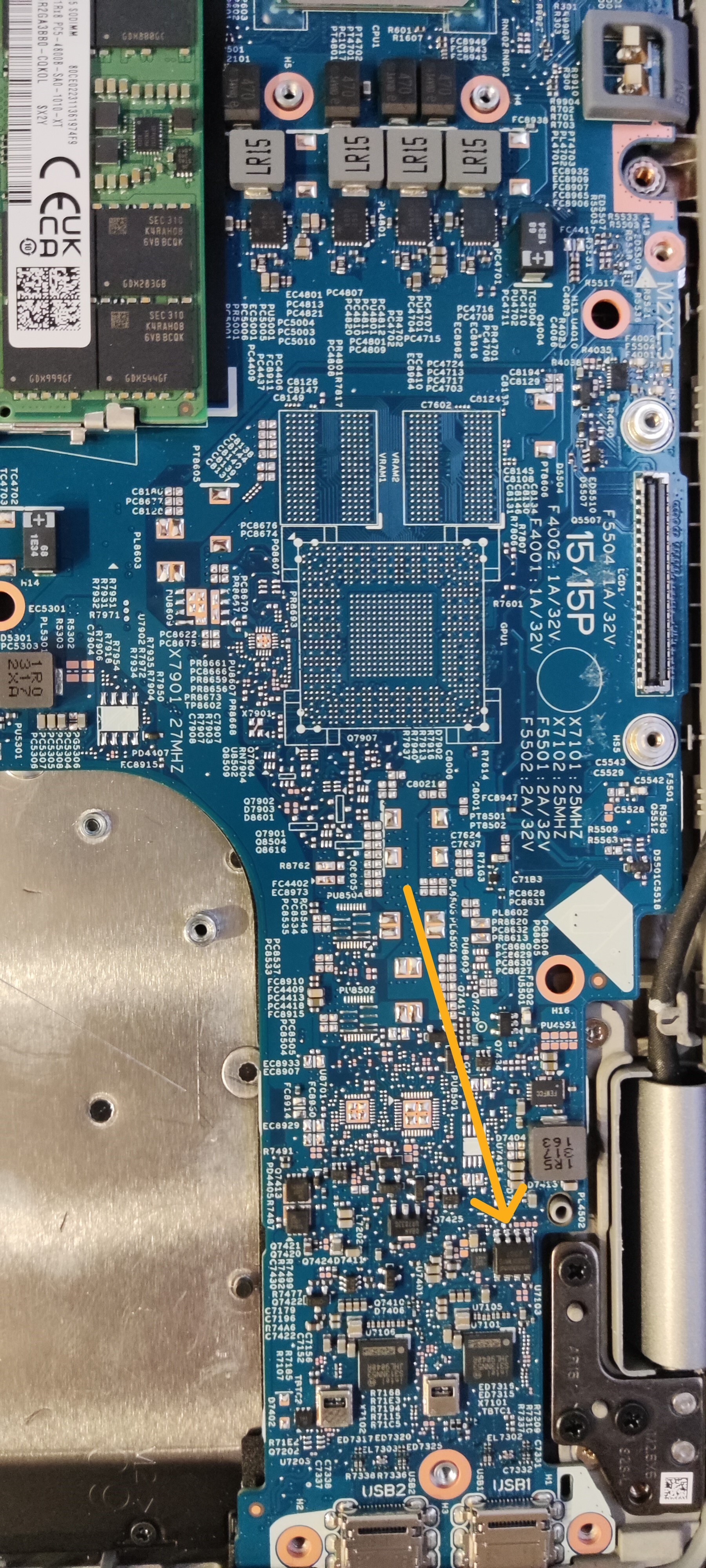

                #47
                Originally posted by coultrain@web.de
                Oh sorry for that,
                THX in advance
                Find the other side of the motherboard.

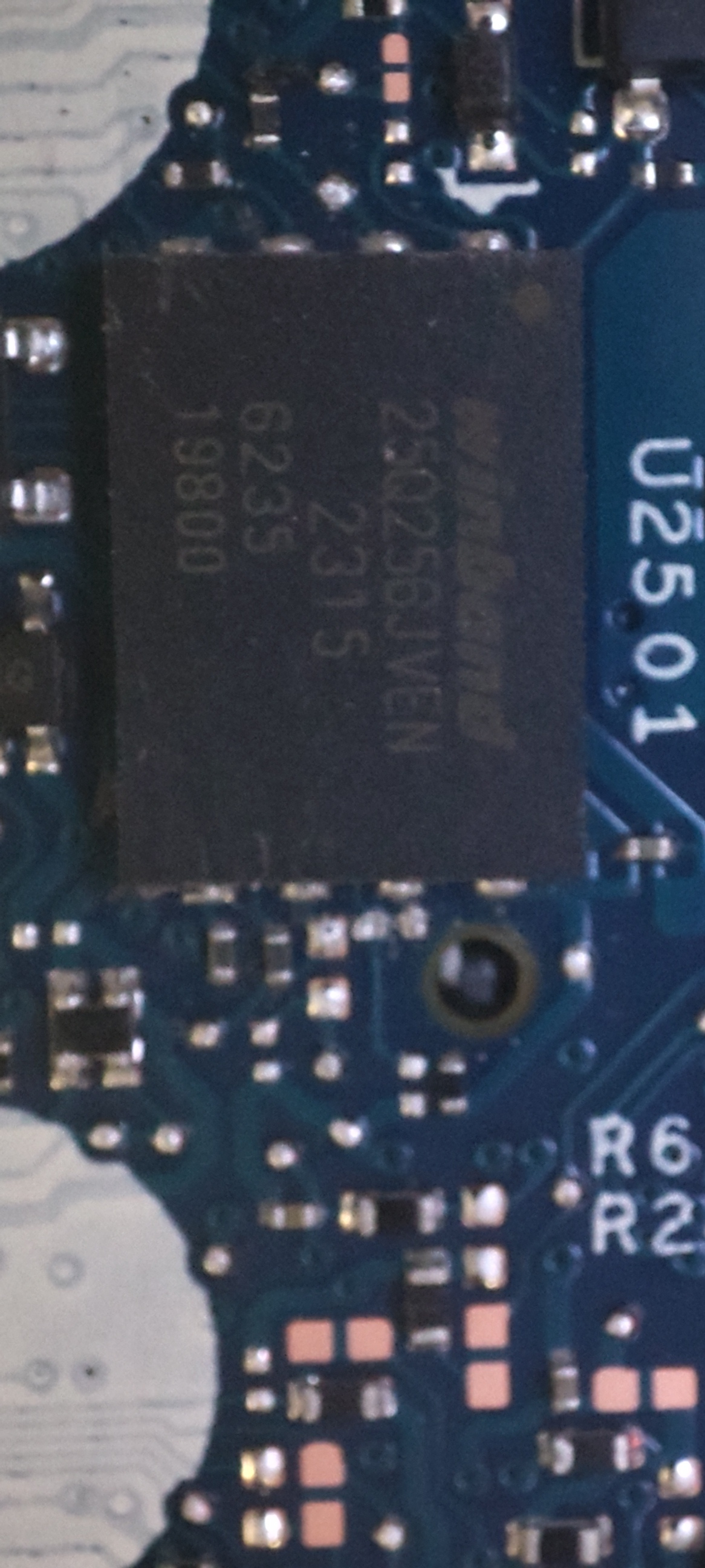

                  #48
                  Thank you for your advice. I finally found it. It looks different and i can't grab it with my clamp to read it. I think i've to desolder it from the board for reading and writing or ist there another solution?

                    #49
                    Try this.
                    Any donations to badcaps are welcome, click this link to donate. Thanks to all the supporters----------------------------------------------------------------------------------------------------------------------------------------------------------------
                    • peste
                      • Dec 2016
                      • 13070
                      • ROMANIA
                      #50
                      there is no other solution, charge do not use the clamp, the bios chip is always removed from the board before writing or reading..

                        #51
                        Finally it took me a while, but now i desoldered the 25Q256JV and read it. File(s) are attached.
                        Thanks in advance
