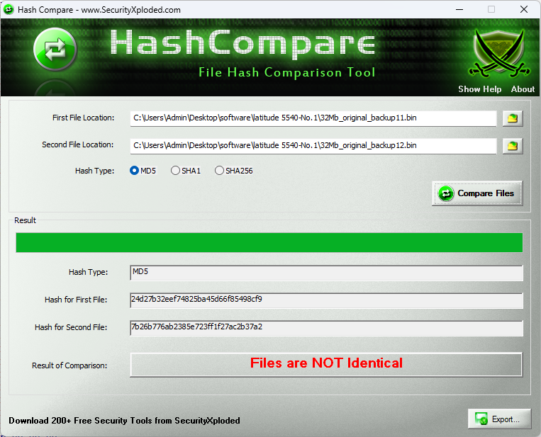

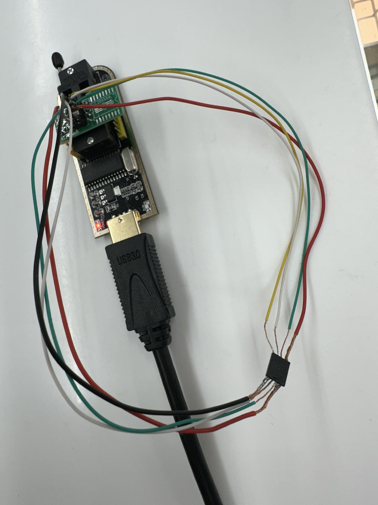

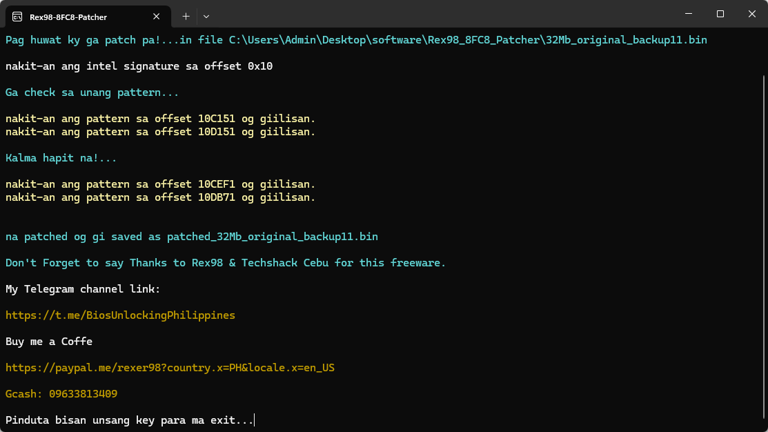

      I wired a 32MB(XM25QH256C) chip on a CH341A programmer.I read the bios chip for several times,and get several bin files.When I compare the bios files,the result is "FILE is NOT Identical".
      I can patch them and has no error.
      Is this normal or something is wrong??
      Thank you.

        As we know, CH341A is the cheapest programmer but not the best so it has 3 software for programming.
          HI,good evening.
          I am using AsProgrammer 2.12,so what should I do next?
