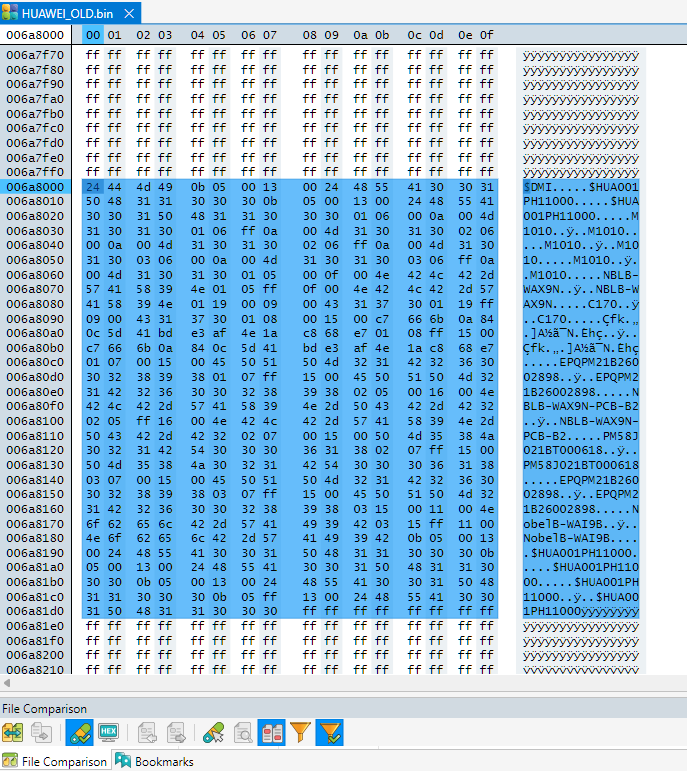

        i tried the rev c hf it works. idk about the others. try it..
        DMI info 006a8000 to 006a81d7
        just try to copy and replace your DMI dump to the new bios on your own.
        search in hex editor $DMI

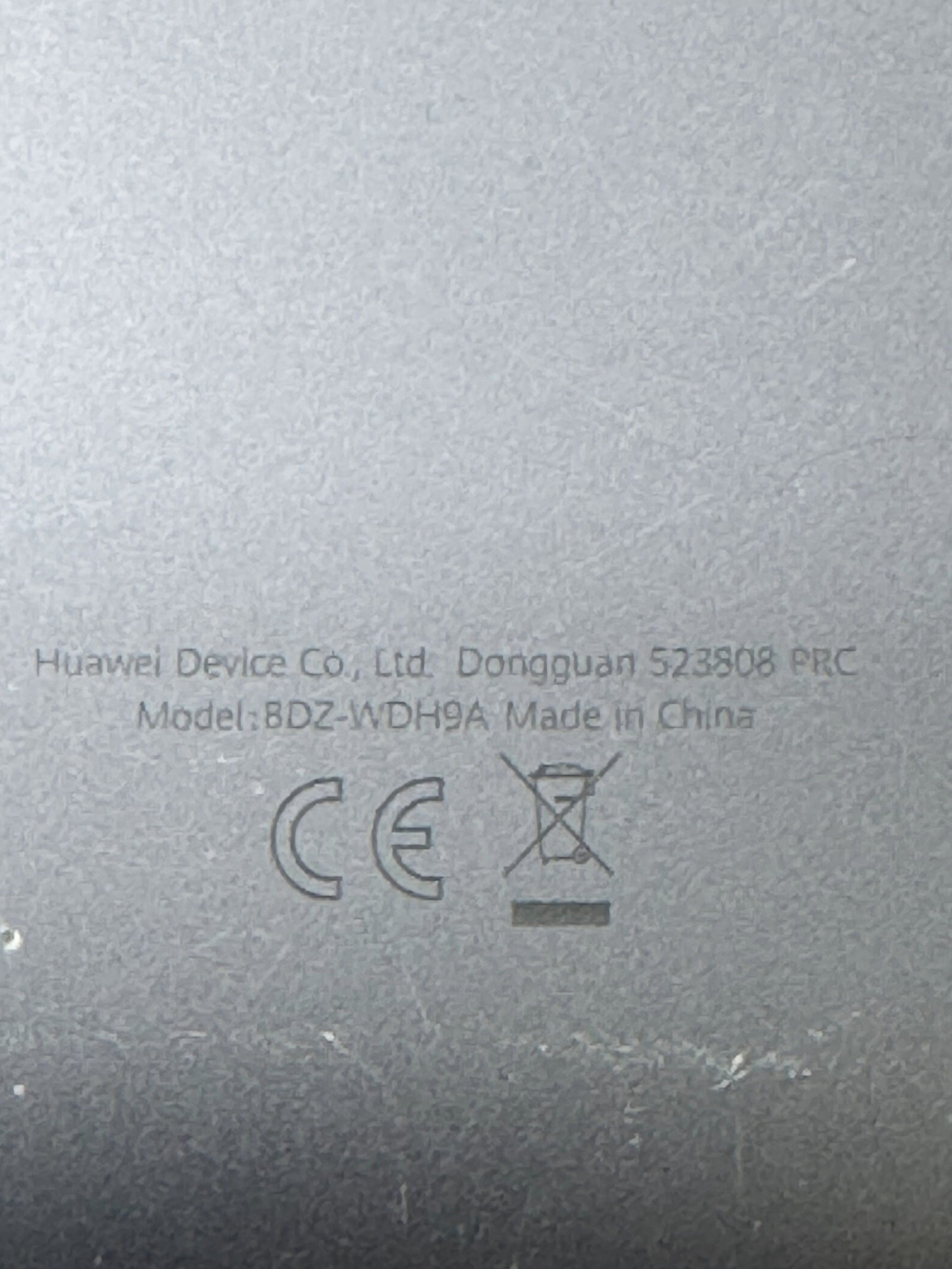

                      hi sir
                      i have huawei laptop model bdz-wdh9a
                      motherboard DAH98UMB8C0 rev c
                      sending org bios have admin lock
                      any help plz
                      • peste
                        • Dec 2016
                        • 14459
                        • ROMANIA
                        Originally posted by QK Hafeez
                        hi sir
                        any help plz
                        post S/N...
                        • QK Hafeez
                          • Apr 2024
                          • 71
                          • South Africa
                          hi
                          its rely funy this laptop dont have sn number sending you pix
