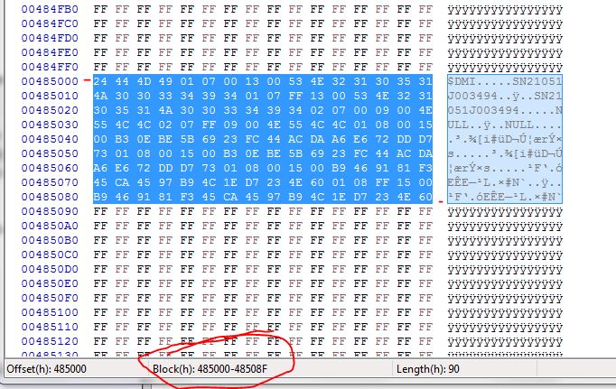

    i need dump for laptop gigabyte gamer G5_KC. The laptop turn on, THE RIGHT FAN RUNS, the keyboard lights up in RGB. BUT NO DISPLAY.
    I don't know what the bios or graphics card problem is
    • 21018
    Re: gigabyte laptop gamer G5_KC dump
    You will find a full bios at gigabyte support -> https://www.gigabyte.com/Laptop/G5--...port-dl-driver
    If you want to add the serial number use a hex editor,copy using the offsets in the attached picture, paste into the new bios.
