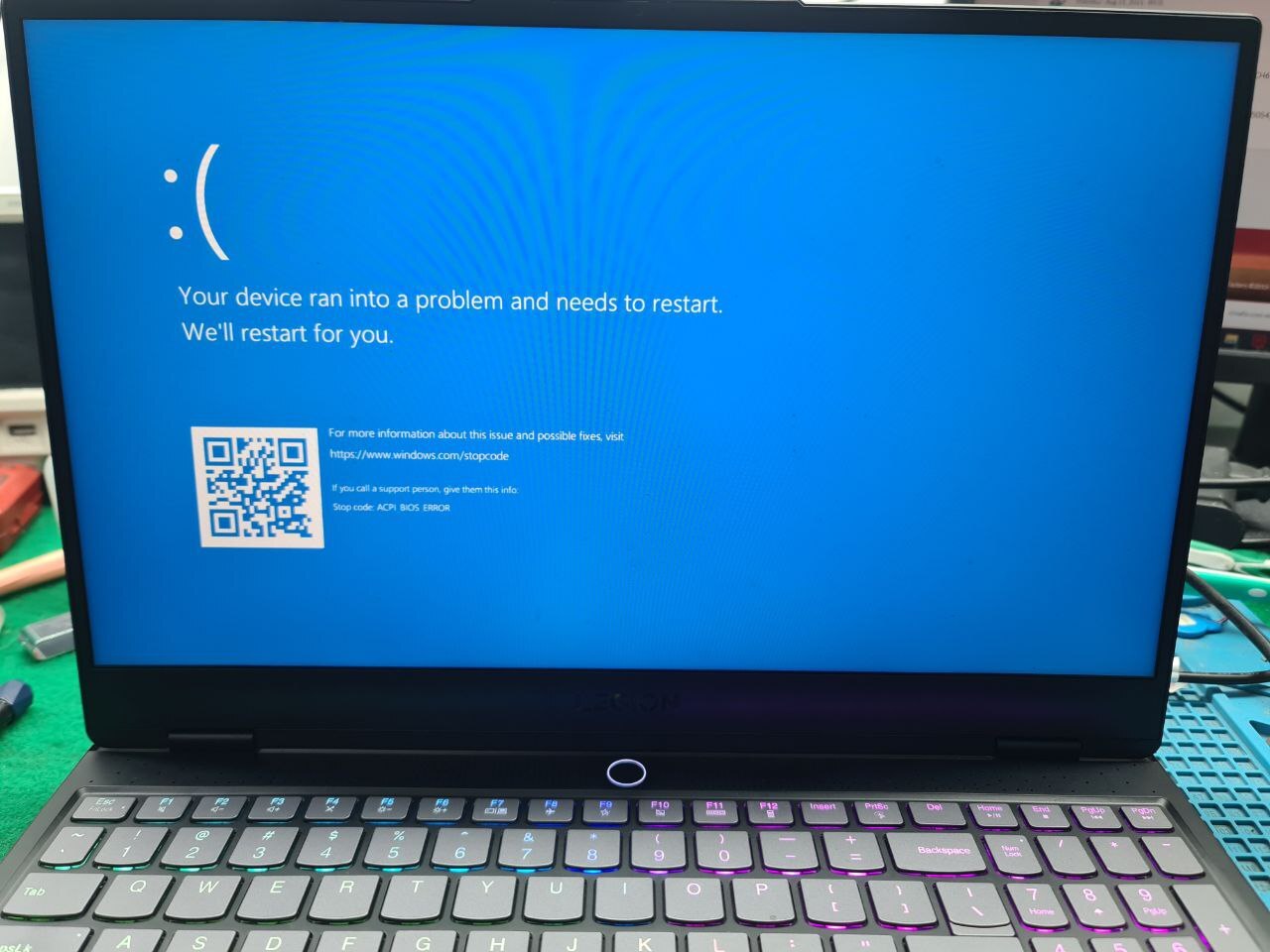

              Lenovo Legion S7-15ACH6
              S/N = PF2XC6BL
              Motherboard code = BM5070_V1.4
              Blue Skin Problem.......
              Please Help me ...... Badcaps Veteran Sir OLD File Add
                S/N = PF2XC6BL
                virgin bios no DMI added ( reason cant find your serial number inside your dump)
