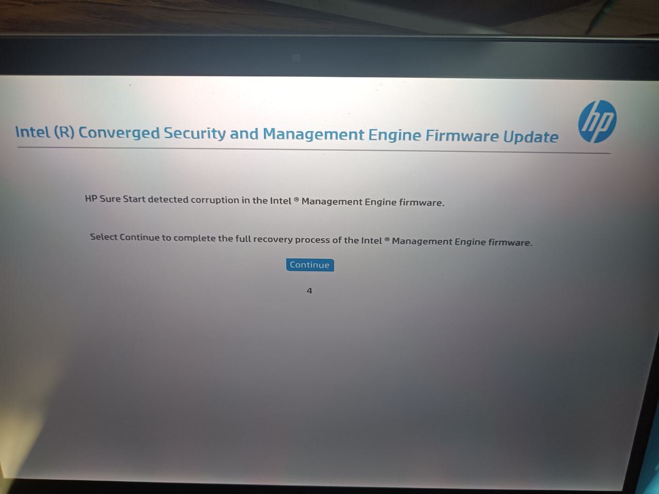

        Thank you very much for your response. But the problem is still not solved. Moreover, now when loading the system it still hangs on the logo every other time. And the BIOS update does not install.Click image for larger version
ID:	3545022​At the first boot it gives this message. Is it maybe because of different versions of BIOS and EC firmware? How to fix it?
          SMDFlea commented
          Editing a comment
          click continue, let the ME recover
