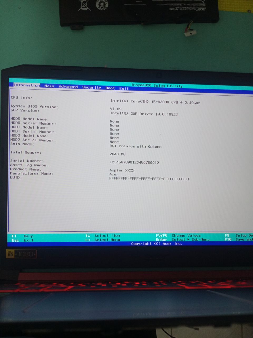

            Hi friends need help,
            Device: Laptop
            Brand: Acer Nitro
            Requesting: Repair/Clean Me Region
            History of Repair: shorted PCH, it is already change to a new PCH and now it is turning on but no display on screen.
            Motherboard EH5VF LA-H501P Rev: 1a
            Acer model: AN517-51 56YW
            S/N: NHQ5WAA001927057263400
            SNID: 92702231034
            Thank you in advance..

                after trying still not having a display, upon observing the PM_SLP_S4# PM_SLP_S3# enabling signal coming from PCH, I have 5v rail stable out 3v rail power after pressing power button after 10 seconds the 3v rail will turn off.​

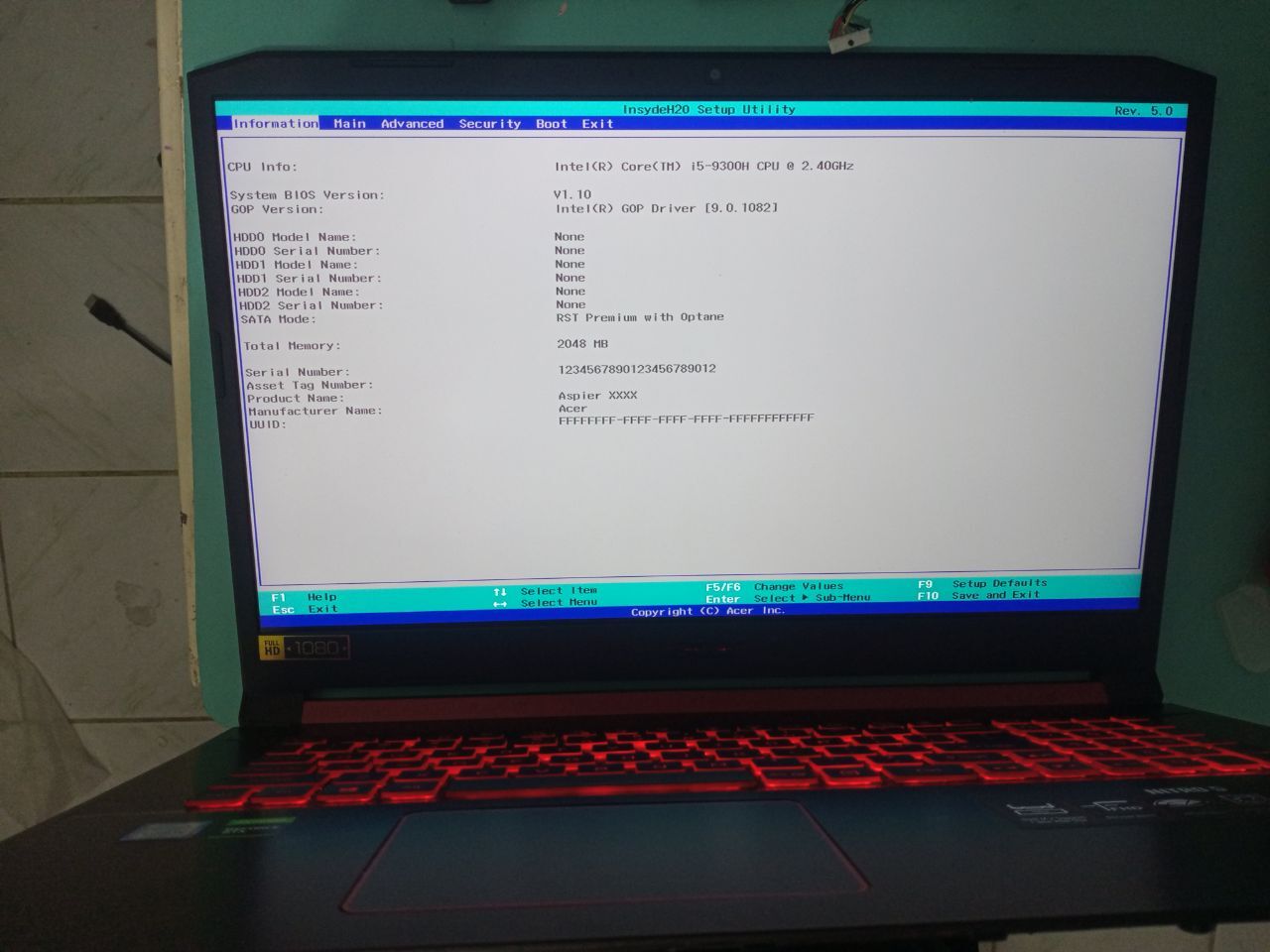

                      Originally posted by hoaca388
                      Nitro AN517-51
                      Hello friends,
                      Update to my unit: After deeply trying fixing finally my laptop now are displaying using this bios but my problem the (Serial number, Product name, UUID) is not properly indicated in my bios Information is this possible to fix? Please kindly help.. Thank you in advance
                      SNID: 92702231034

                        This DMI is from another machine, where is original backup bios file ?

                                after testing laptop has now display but Im getting same result about DMI it has no information. Can you manually input DMI information list below?
                                SNID: 92702231034​
