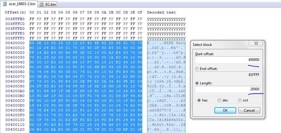

                Problem with ENE firmware
                Awhile back I replaced a burnt ENE kb9028q c, and after programming the replacement, I was unable to get the laptop to work. I did poor job of soldering the chip, and had to go back with my soldering iron to fix a few mistakes, so I thought maybe I had damaged the chip trying to fix these mistakes.
                Since I had order two replacement chips (in case I messed up) I recently decided to retry soldering in a new chip again. This time I did well soldering it with hot air.
                After installing the chip, I plugged in the AC adapter and I got the orange charging light, which came on with or without the battery plugged in, but the laptop would not power on, so I again folllowed the steps to attach jumpers to the keyboard pins, and reprogram the chip with my ch341a.
                After programming, the charging light no longer comes on at all. I tried erasing and reprogramming again, but still no luck. The firmware I am trying to flash I extracted from the BIOS I dumped from the BIOS chip, but don't know if it is possible I did something wrong.
                If I upload my dumped BIOS and the extraced firmware could anyone take a look and tell if something is wrong with the firmware I am trying to flash?

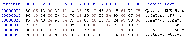

                      Attached is the EC extracted from your backup.

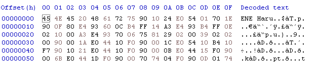

                        Re: Problem with ENE firmware
                        Originally posted by SMDFlea
                        I can get to the support site but the download links aren`t working,they might be doing some site maintenance at the moment.
                        Thank you!
                        My extracted, vs yours:
                        https://www.badcaps.net/forum/attach...1&d=1690668030
                        I need to learn more about doing that myself. When I did it before I used a program called BIOS creator.
                        Thank you very much, I kind of wish I'd done this before, but I feel like I also needed the extra practice installing the EC chip anyway.
