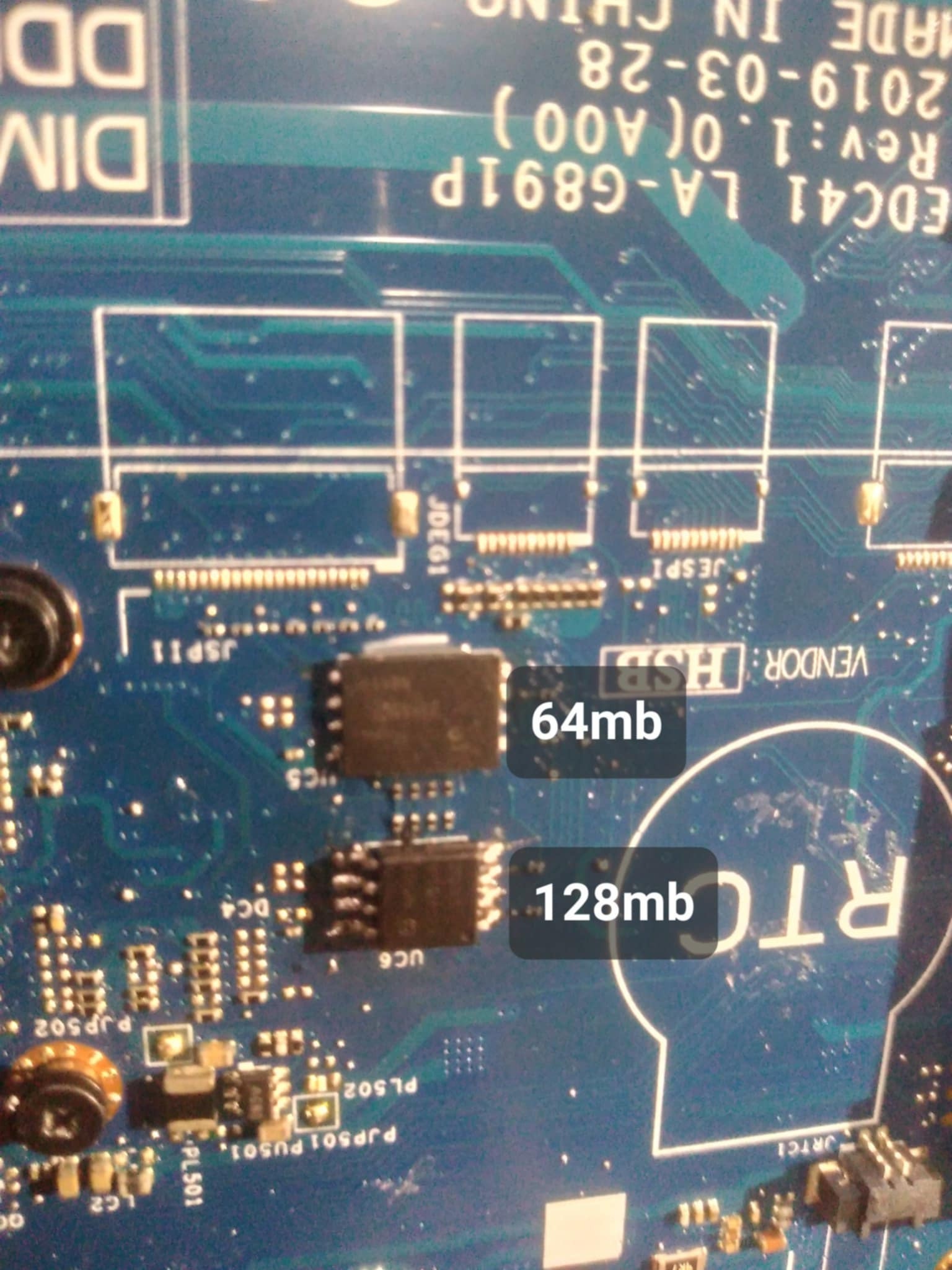

    hi need bios password removing this motherboard has 2 chips 64 and a 128 please let me know which chip you need the dump from thanks

    Re: dell latitude 5400 bios password
    Smaller one only.
      thanks here is the dump
        Here you are, unlocked:
          thanks but that did not work now turns on fans full speed keyboard backlight on but nothing on display
            sorry it has worked it just needed to be left on for 2 mins then it restarted and works fine thank you

              HEllo everyone, thus anybody have the same experience with me? after I patched my 64m chip with rex8 8CF8 patcher my dell 5400 went dead..

                  Here's my 2 chips, I think I bricked, can anyone tell me how to unbricked it..
                    try and feedback

                      Originally posted by LBTT1121
                      try and feedback
                      Thanks Bro. I already manage to save it... probably my mistake. It works perfectly
