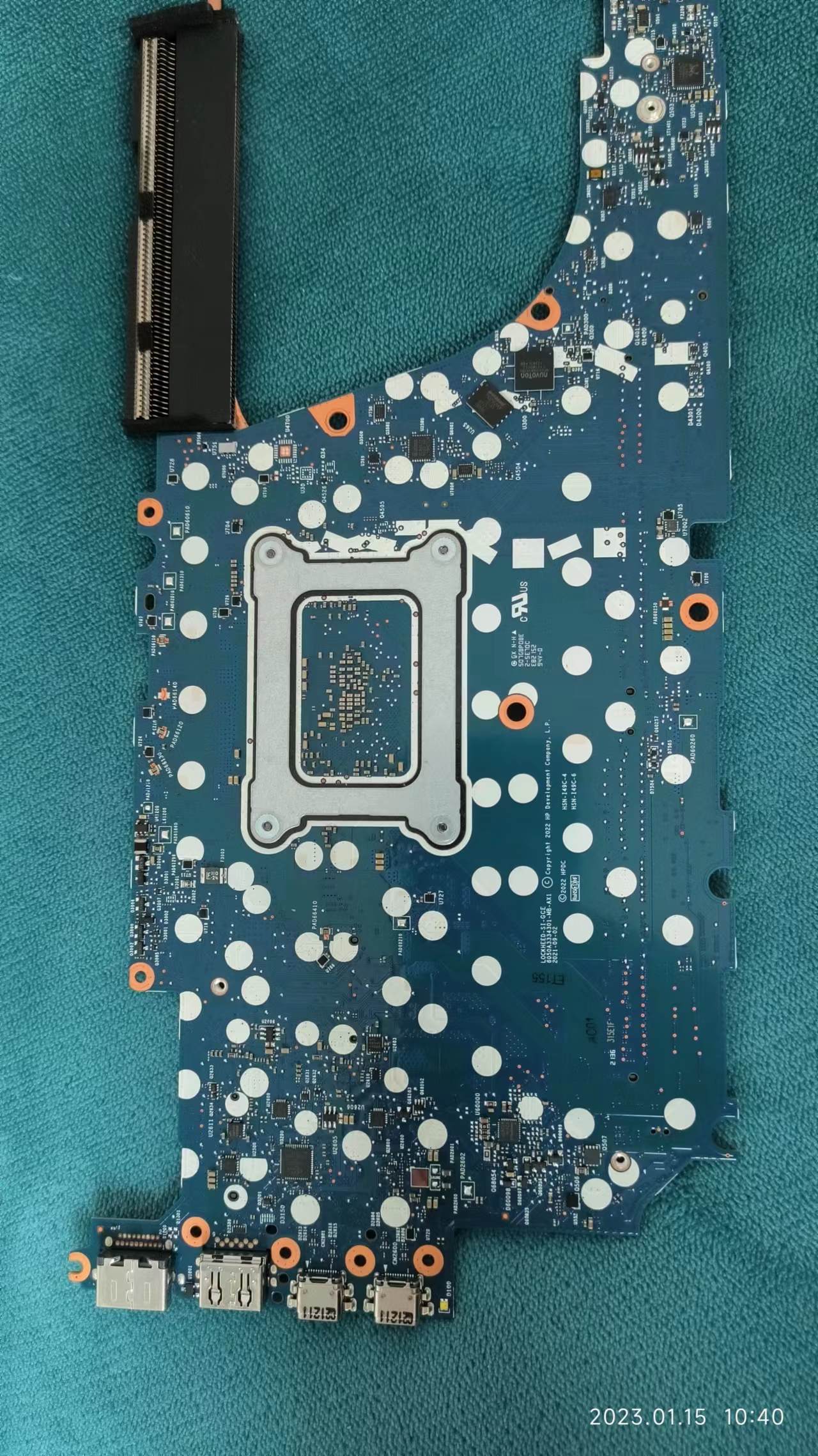

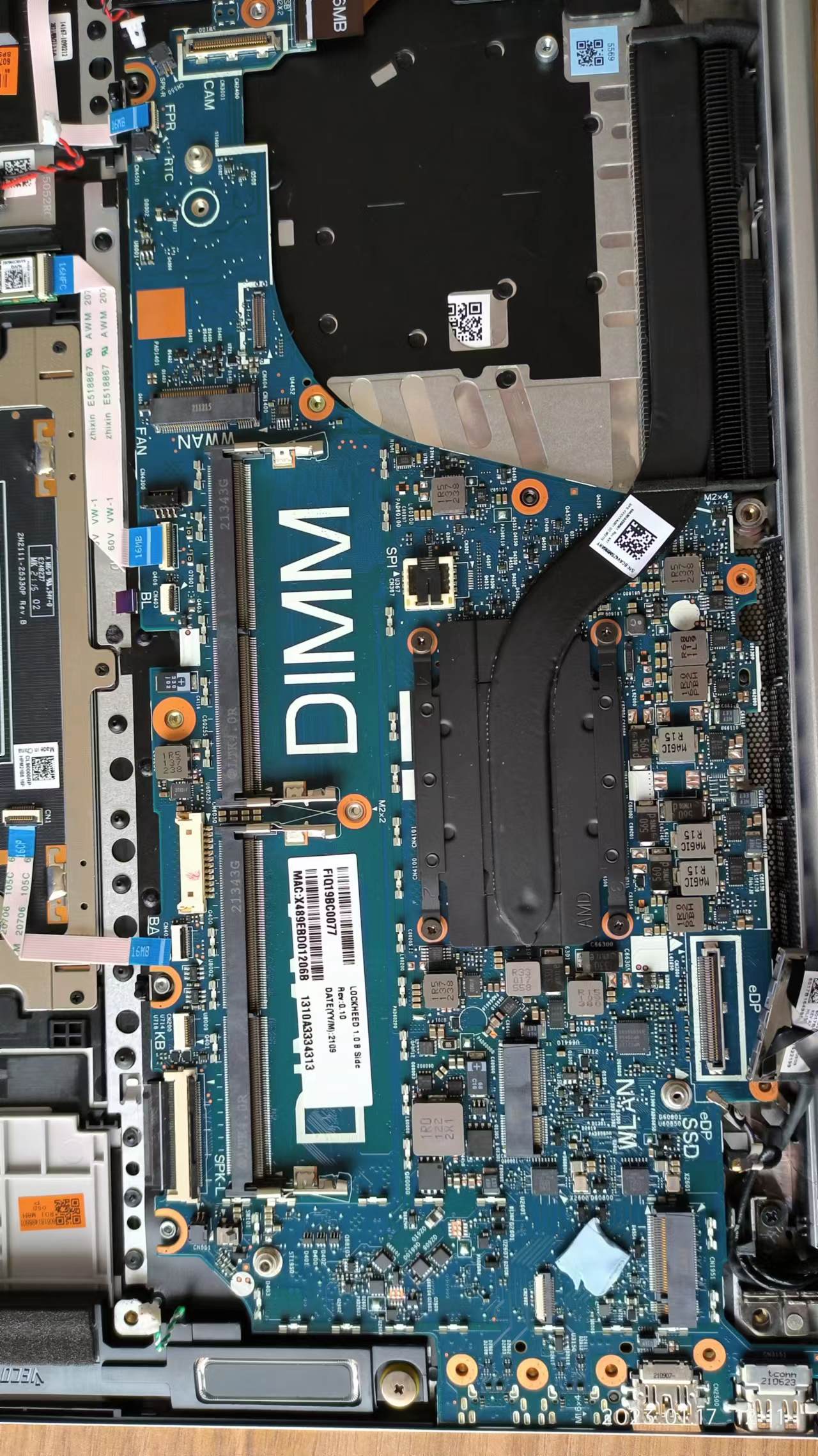

Some time ago, I forgot my 865 G9 BIOS password. I found a warm-hearted person in the forum and cleared the password; It's all a problem. DMI is wrong. I rewrite the new DMI in the BIOS. However, the message "Shared SPI Flash was Recovered from the Adobe" automatically recovers the wrong DMI information when I boot up. What should I do? Is there any other chip that stores DMI information? How can I clear it. Attach the motherboard diagram and BIOS backup.

by MrFlapsI booted my Windows 10 laptop with a Ubuntu USB Key drive and it's done something awful to the BIOS / UEFI.
Entering sleep or shutting it down causes it to enter an unresponsive state.
Sometimes the power LED by the charger port will flash orange / white.
Sometimes the Caps Lock and Num Lock LEDs will flash.
After some time it will boot with the following message
"Shared SPI Flash was Recovered from the Embedded Controller Flash"
and will then boot normally.
I have also recieved the following... -
