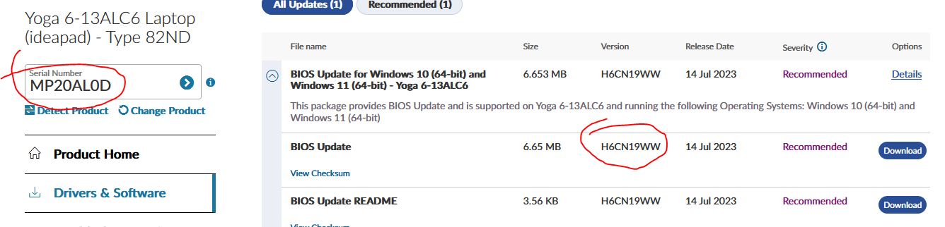

            Re: la-k211p bios
            hi ,
            I need working bios for
            Yoga 6 13ALC6
            motherboard la-k211p
            sn: MP20AL0D
            laptop turns on but no image / video.

              Use the bios at post #3 .Copy your DMI (serial number,key) with a hex editor from your backup to the new one.Use these offsets
              5BC000 - 5BDFFF
              EAA000 - EAA03F

                  How to check if there`s a compatible bios in this or any of the other lenovo threads ? .Go to lenovo support, enter the serial number,look at the bios version.
                  The current latest version is H6CN19WW (see attached image),the bios at post #2 is H6CN16WW its older,but newer than yours which is H6CN10WW.To find H6CN10WW in your backup look for the word BVDT with a hex editor.
