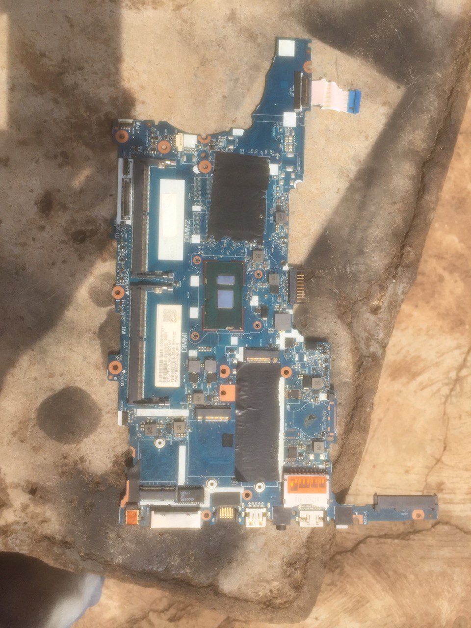

    Am working on hp elitebook 840 g3 . the problem is , it can only turn on when i put in charge battery but not on charger. if i plug in the charger all the necessary voltages come , but still cant switch on from charger. is there way through which i can solve this problem?

          this is the board

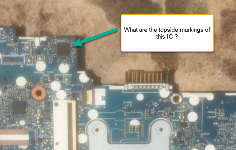

            See attached. Near the battery connector should be the charger IC. We need to locate this charger IC to debug this case.
            Is the IC with a 'BQ' marking ? If not, continue to locate similar looking square ICs till you find the 'BQ' charger IC.

              ok thank you. but please how can i locate BQ charger ic?
              • mon2
                • Dec 2019
                • 13836
                Re: hp elitebook 840 g3 power problem
                Review each square (black in color) shaped IC and review the topside markings.
                Guessing that you will have one with 'BQ' in the markings = Texas Instruments / BenchmarQ brand. We need to know the full part number on this IC.
                Start the hunt from the DCin adapter connector and review to the battery connector. Has to be present somewhere.

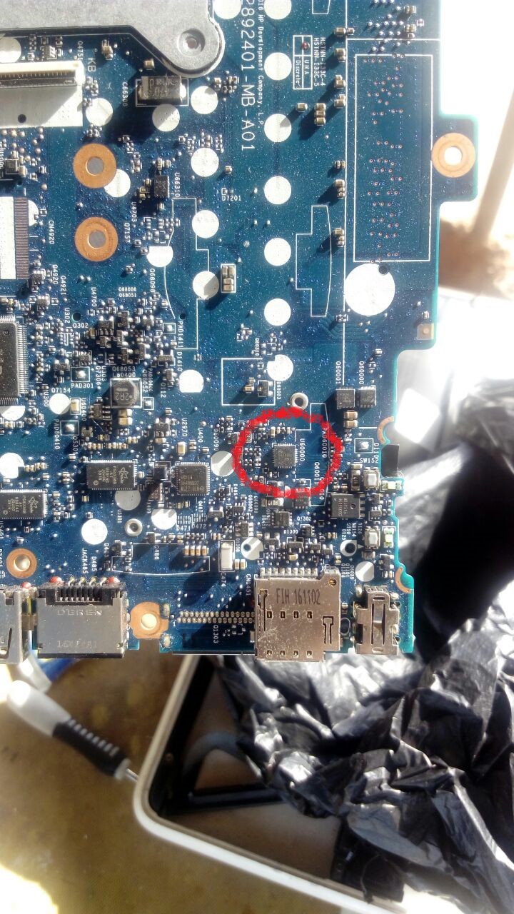

                  i have seen the ic

                    please should i replace ic ?

                      What are the full markings of this charger IC ? So far, unable to locate the schematic for this logic board ->> Use 840 G1 (similar) schematics.
                      However, with the charger IC details, we can get a very close idea of how this charger circuit works to debug the fault.

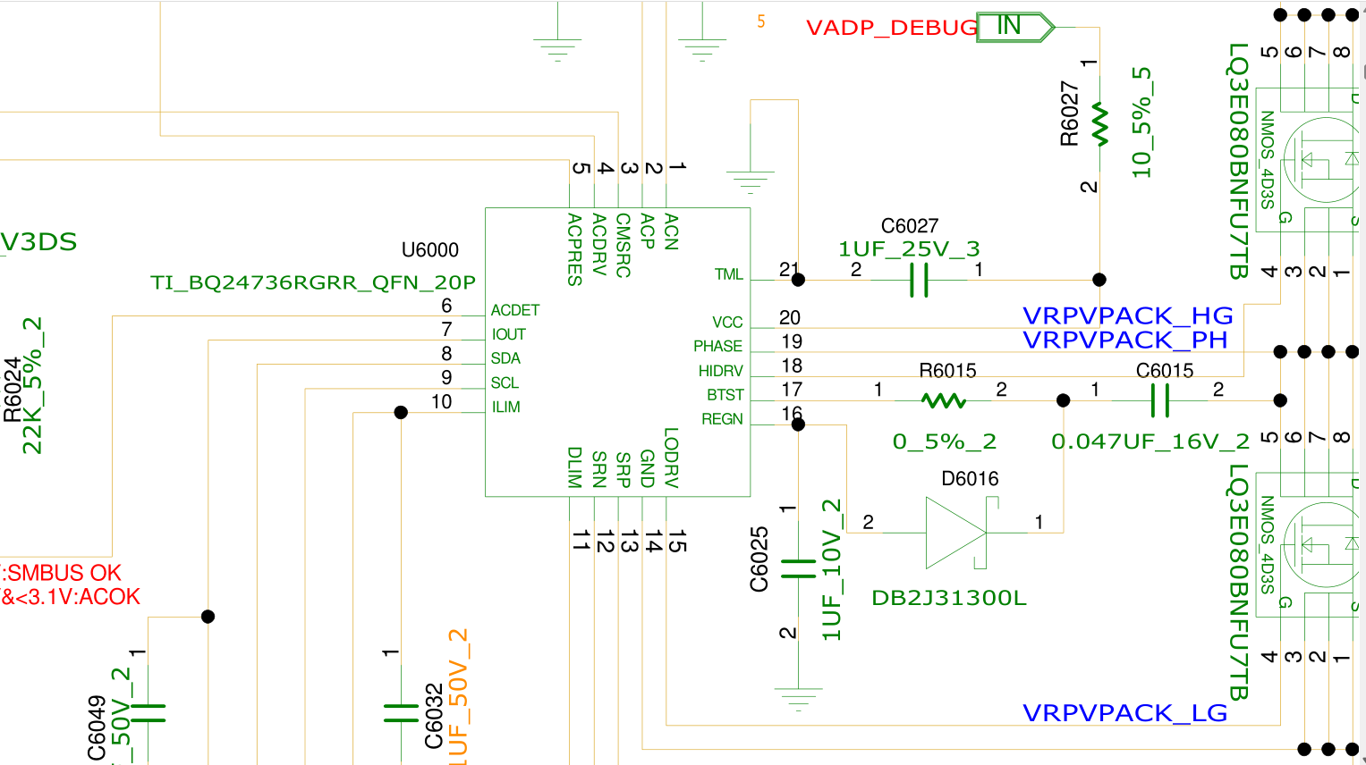

                      Update: HP 840 G1 also has a U6000 for the charger IC so use it for reference.
                      Download the schematic from here:
                      https://www.badcaps.net/forum/showth...ghlight=840+g1
                      Then search for 'U6000'.
                      Measure the voltage to ground for the following pins on U6000:
                      a) REGN
                      b) ACDRV

                          I think you may find that the 2nd mosfet = Q6011 will be defective.
                          You can remove it and confirm that ACDRV should be ~25 volts to ENABLE the 2 x DCin mosfets. If it is not, then we need to review the conditions needed for this charger IC to spit out this boosted voltage.
                          That is, the ACDRV voltage should be (if working properly) = DCin adapter + REGN voltage (~6 volts) = ~25 volts to enable the mosfets.
                          Often, as per article above by @Piernov, the 2nd mosfet gets damaged. DO NOT bypass the mosfet but if available, replace it with a suitable N-channel device. The device can be replaced by many others.

                            This board uses BQ24780S...... Same as HP Elitebook 1040 g3, 1030 g2 and most 6th and 7th Generation HP Elitebooks and Probooks Series
