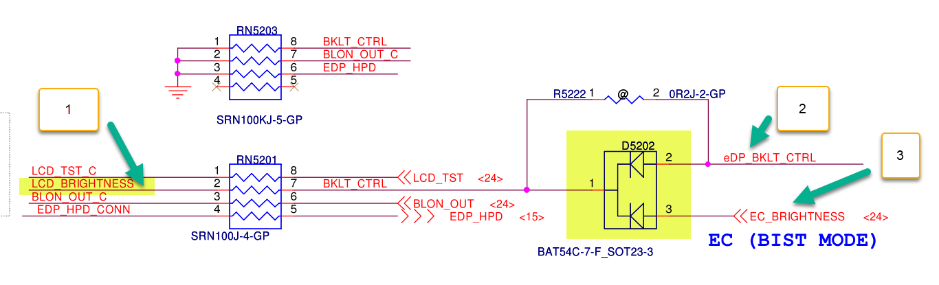

    i have a la-b843p motherboard with dim display
    dcbatout at lcd is 19v
    lcd vdd is 3.3v
    lcd brightness is 3.3v
    blon out is 3.3v
    have tried new led but same problem.

    LCD1 connector Pin9 status??

      Re: dell vostro la-b843p dim display
      thanks for reply .pin no 9 is 2.5 v
        Very likely bad EDP cable. Do you get display on external monitor??
          Also, measure the voltage to ground of the attached points.
