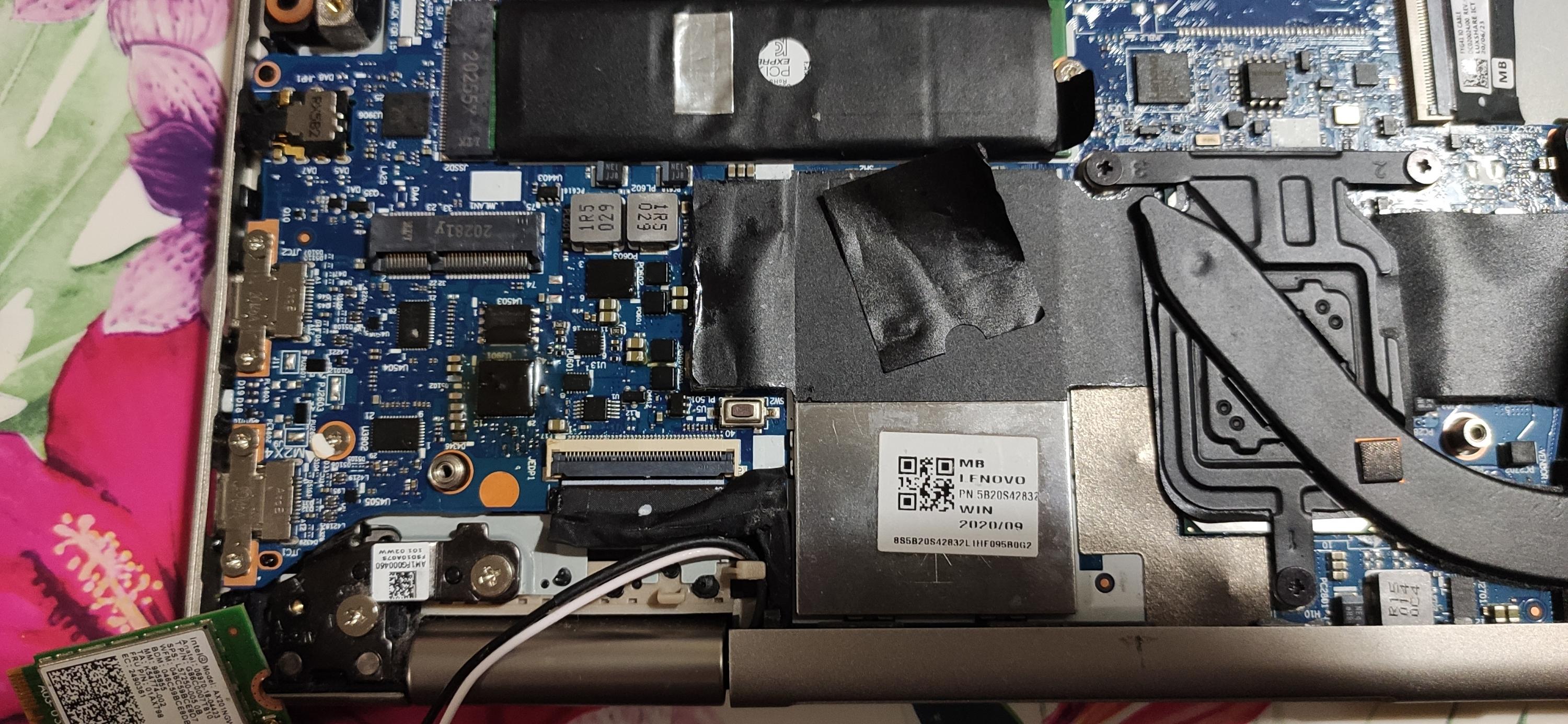

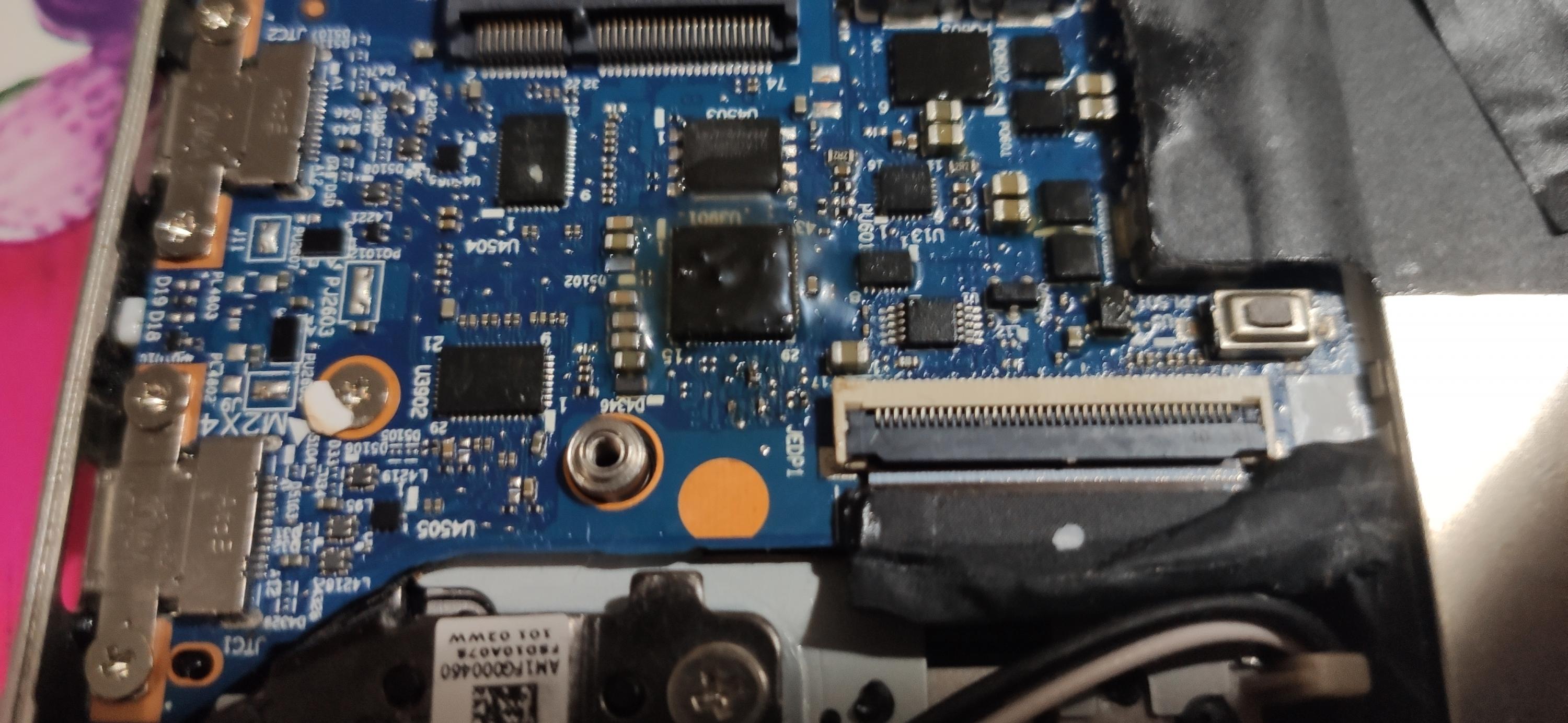

    Hello all,
    I was replacing the USB charge chip and noticed that I knocked off a cap 'ext to it. I'm not able to find the place it was sitting.
    Does anybody have a picture of that area? It would be really appreciated!

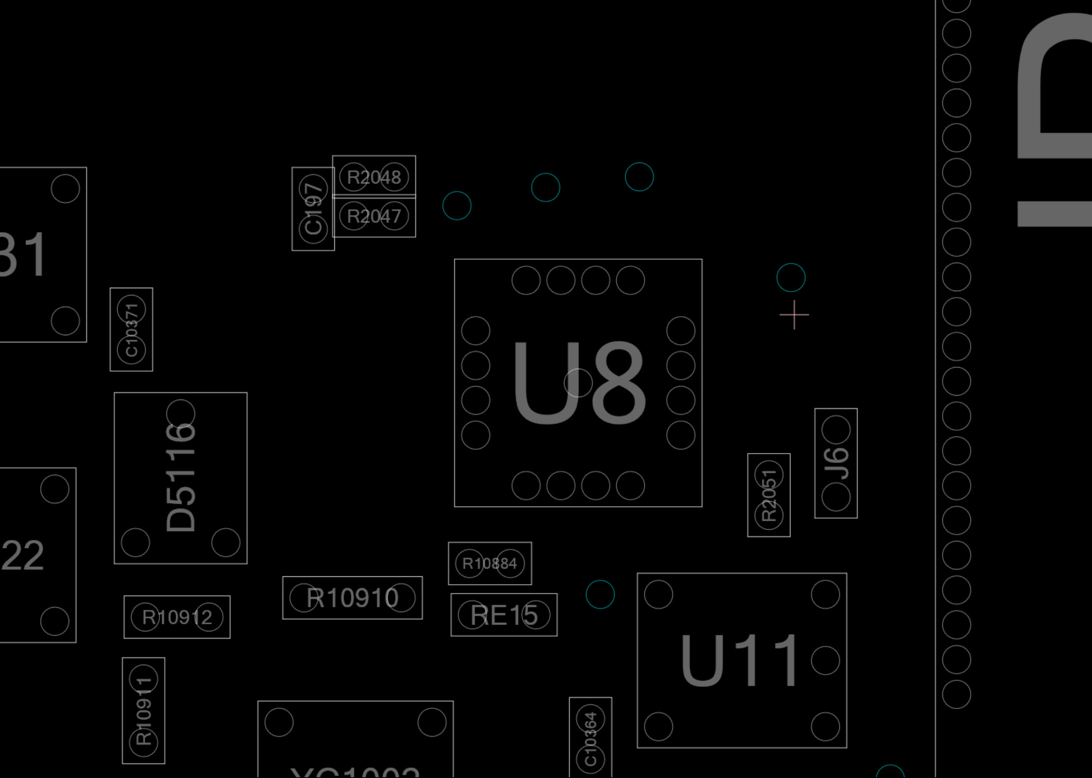

    Not enough details in your post.
    Logic board number ? Silk screen details ?
    USB charger IC = U8 ?

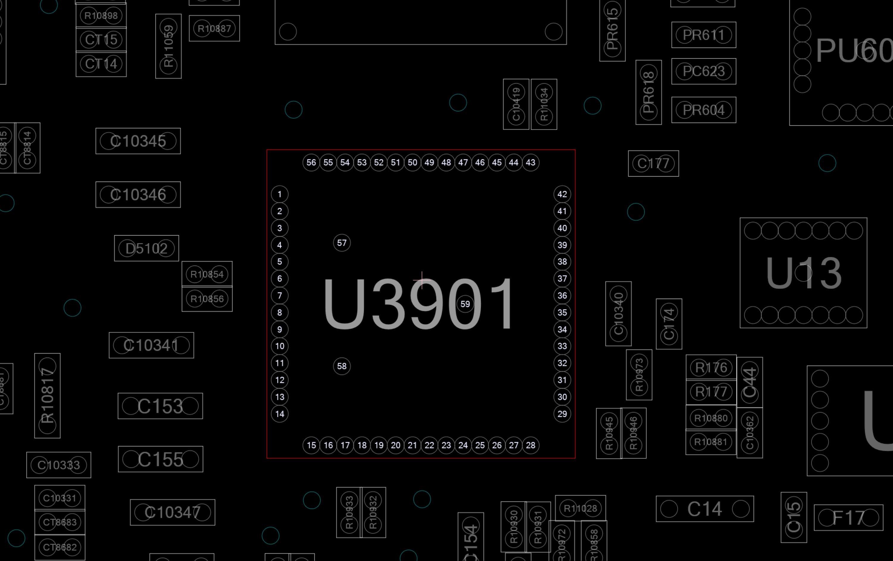

      Re: Lenovo c740-14in
      Sure! Nm-c431
      Looking for u3901 and around. It is located next to the wifi m.2 port
        is it in the attached ?
          Looks to be that one yes, can you zoom out a bit on it? So that I have the area

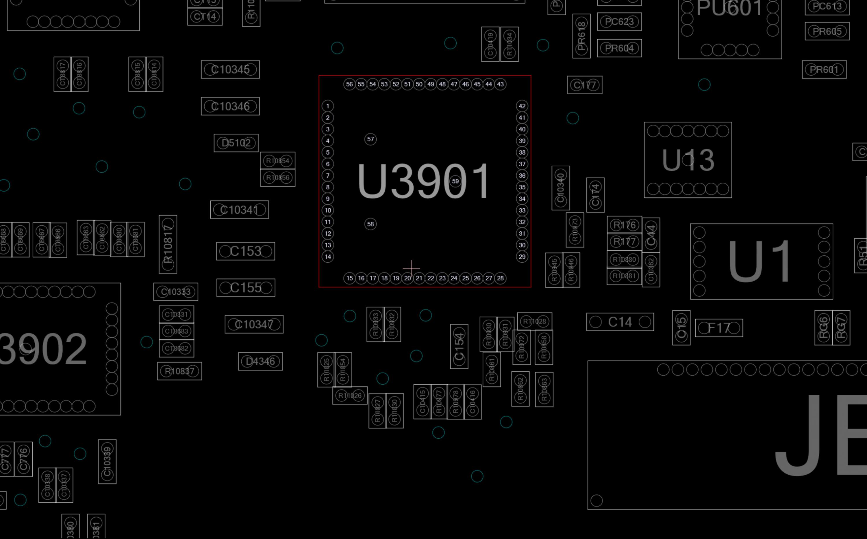

            Sure - see attached. Also attached the boardview file so you can do the same.
              Thanks! Will look at it tomorrow!
              Board view gives a lot more resistor/caps then what I have... Will see! Thanks again!
                Some of the pads may be a 'no stuff' - we can compare against the schematic to be sure.
