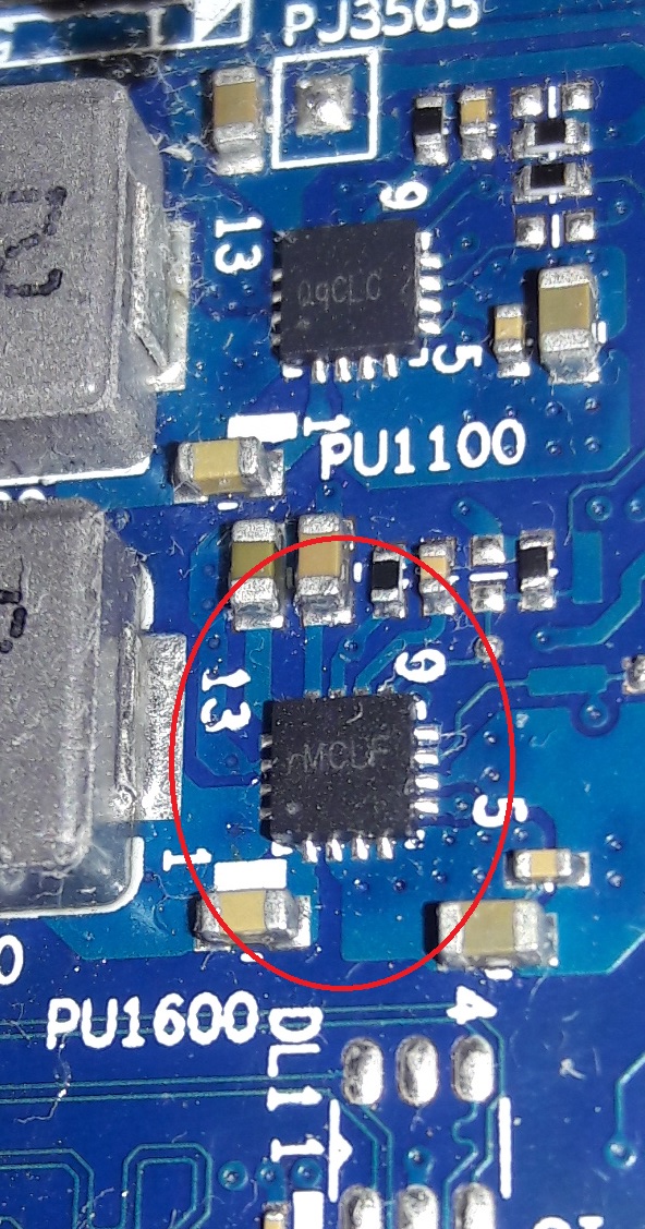

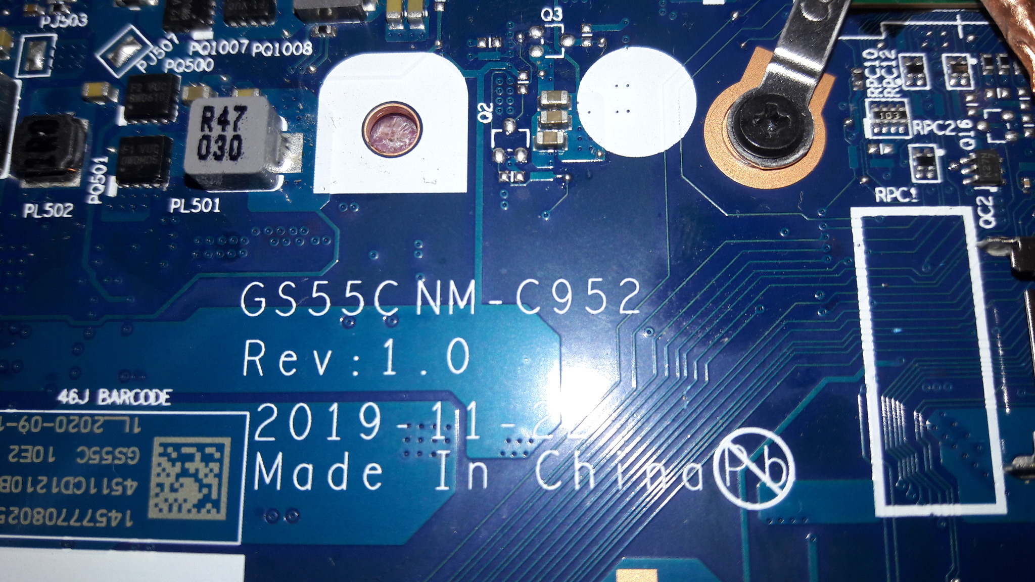

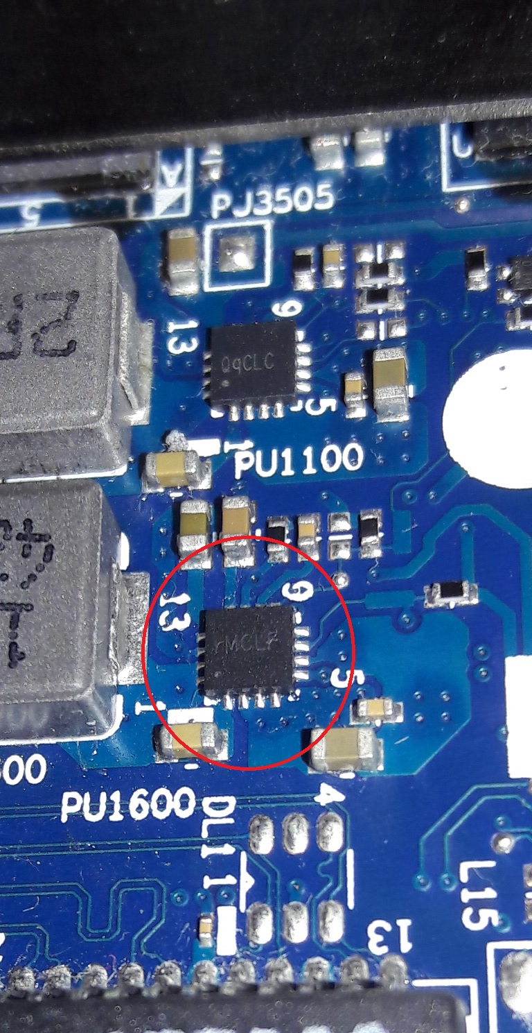

    lenovo gs55c nm-c952
    plz identify this part
    thanks
  • mon2
    • Dec 2019
    • 14205

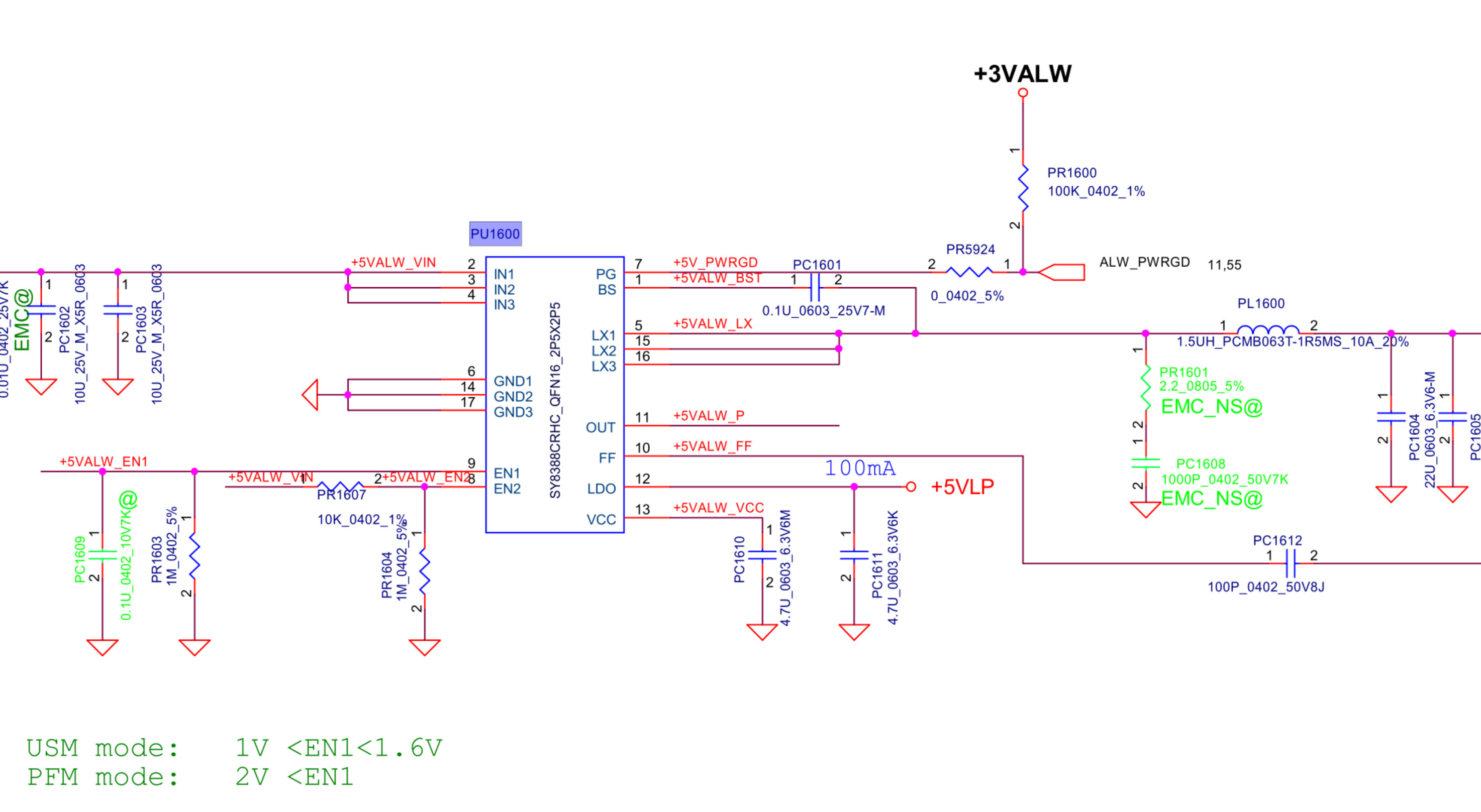

    Re: lenovo gs55c nm-c952
    SY8388CRHC QFN16
    see attached.
