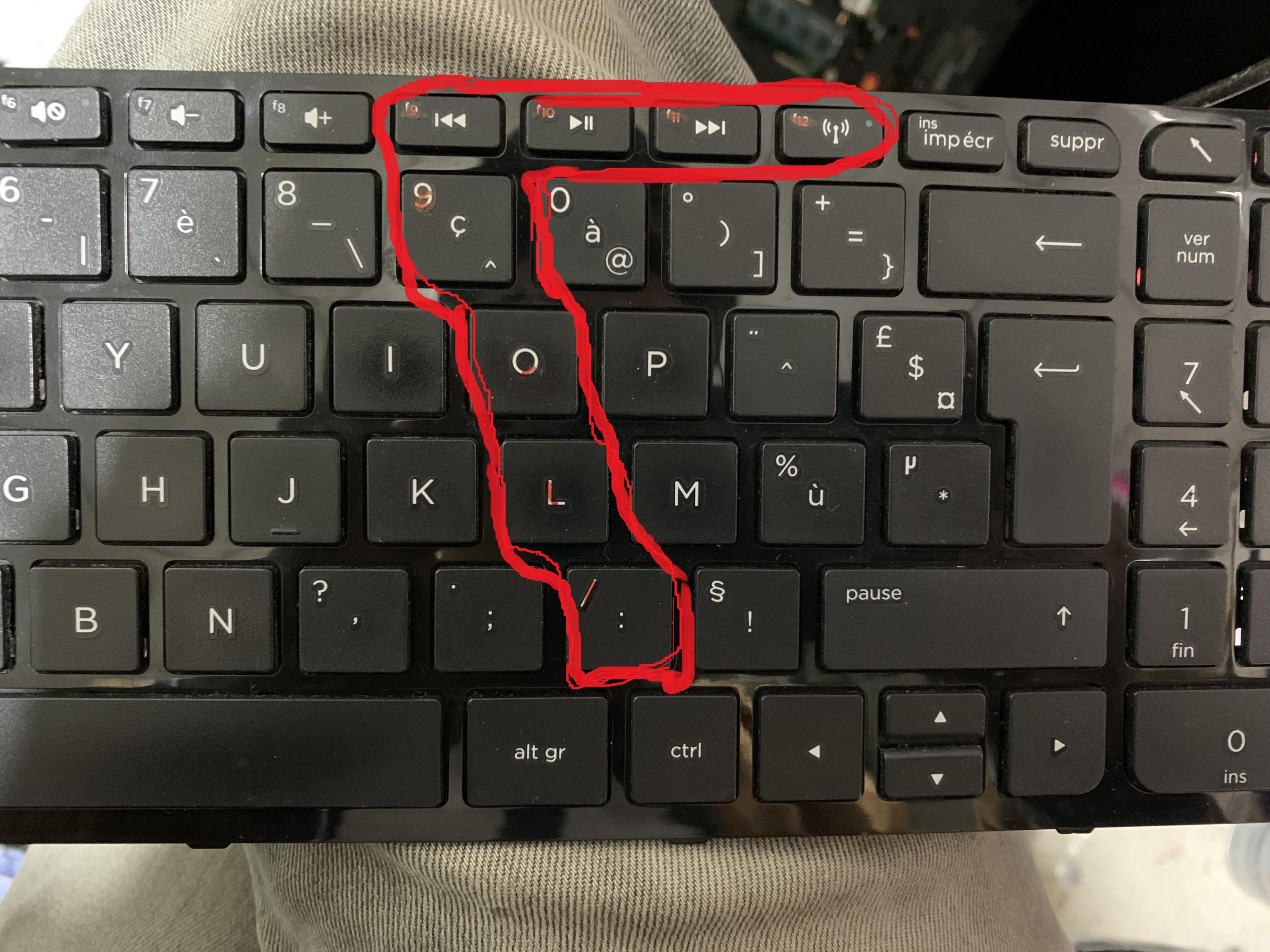

    hello everyone i need help with this board " da0r62mb6e1 rev e " that have some keys not working ( the keys are in the picture )
    i changed the keyboard but still not working
    i tried my keyboard in another laptop and it working
    so the problem is in the board
    do i have to change the io

    Usually there are resistor networks related to the keys on Mobo side. Unfortunately no clear picture of the bkard shared, but worth to check I guess, before messing with the EC.

      thanks for the reply but i dont have those resistors check this photo

        check connector solder joints. measure in diode mode, if the connector pads are connected with ec and look for abnormal values. maybe the ec is faulty

          u10 looks a bit displaced, did you work on this already? also check ec solder joints then

            "Displaced" is a good call.
            This has to be sorted of course. So we have a NOT mentioned repair attempt in this area. I teally want to ask the thread starter how we should troubleshoot that without asking the crystal ball?
            Full history of the device please!
