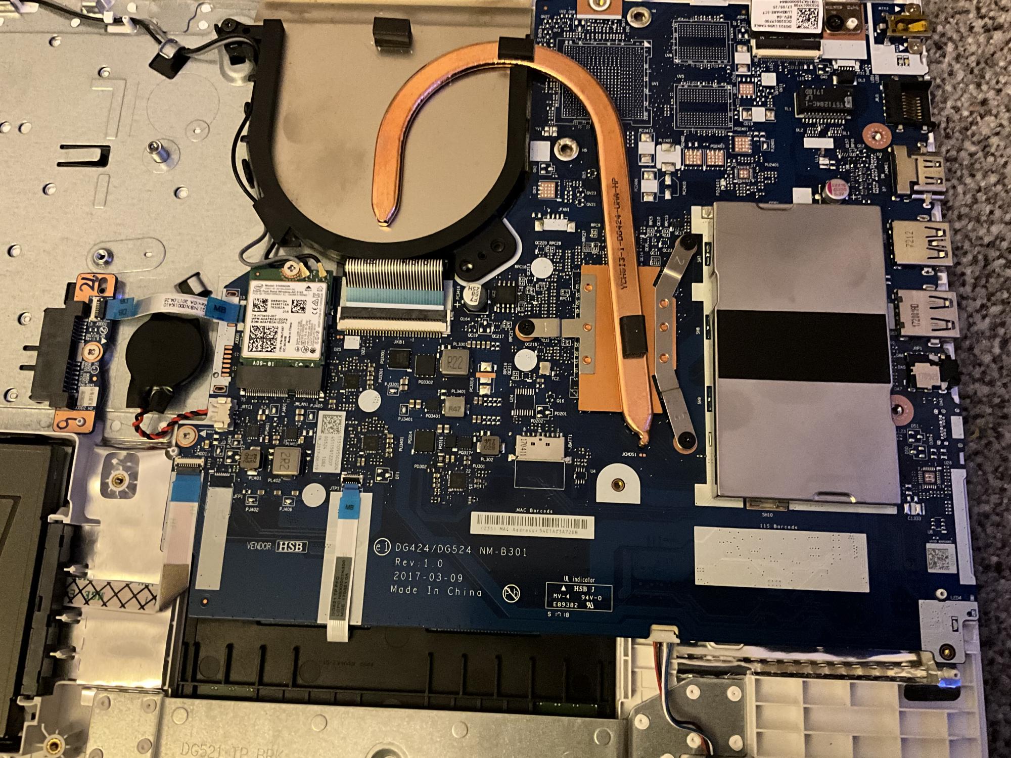

        Lenovo 320-15iAP
        80XR00T9UK
        Bios:5RCN36WW
        Working off a iPad, have attached a picture hope it comes through.
        Am a bit old for this as 76 yrs old, please take it slowly.

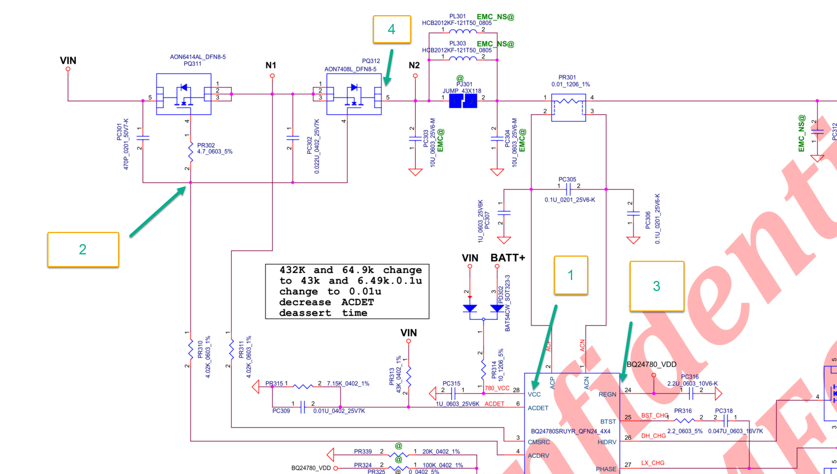

                  See attached. Is this your logic board ?
                  Lenovo 320-151AP
                  is really
                  Lenovo 320-15IAP
                  reference schematic: NMB301

                    Re: Lenovo 320-151AP
                    Also, see attached.
                    With caution, meter in DC voltage (20V or higher is OK), measure the voltage of each test point and post each measurement.
                    Often, as per the stick above by @Piernov, the 2nd DCin mosfet gets damaged (leaks). This often causes such faults or tanks the ACDRV boosted voltage.
                    Each of the DCin mosfets is an N-channel style so the GATE pin # 4 should be about 6 volts higher than the voltage passing through source / drain pins. The charger IC boosts the voltage of REGN pin and applies it to the ACDRV pin to enable the mosfets.
