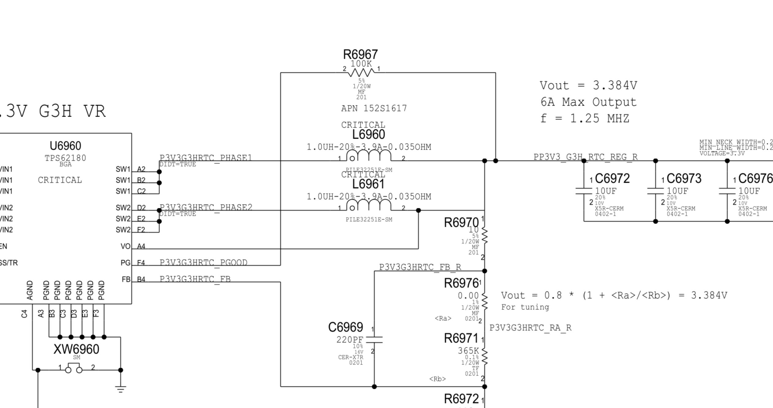

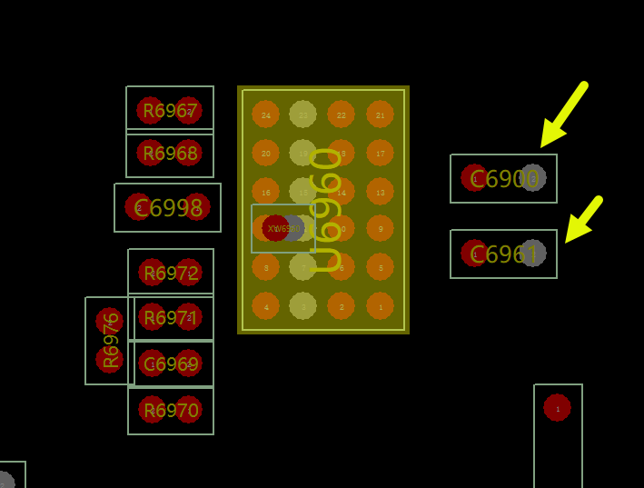

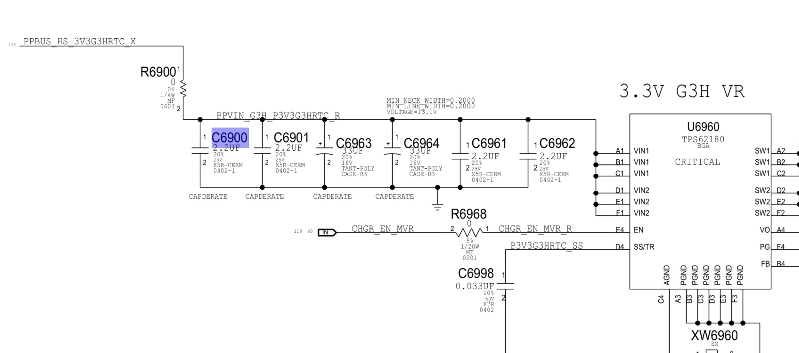

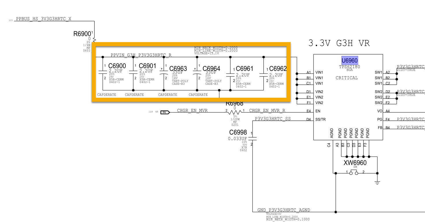

                See attached.
                It is possible that a cap that is nearby is heating up rather than the IC @ U6960.
                Unless known for sure, apply flux and carefully remove C6900 and C6961.
                Then measure the resistance to ground of the pads for this input rail.
                Is the resistance higher than before?
                Hoping that you have a shorted cap and not U6960 itself. However, the repair should not be too difficult but suggest to practice the process on some donor / dead boards available from Aliexpress.
                The trick is lots of flux, enough heat and enough air pressure to melt the balls under the IC. Spin the hot air tool in circles to melt the original solder. Do not allow for the surrounding parts to go flying.
                With tweezers, gently nudge the corners to see if the solder is melted.
                Then remove the IC when it is. Allow for cooling -> use IPA to clean the flux -> apply low temp leaded solder by skimming the top surface -> use point to point soldering iron and nice braided solder remover to flatten the BGA pads. Do not rush else the bga pads will be ripped off the PCB and then it is game over.
                IPA to clean up again.
                Flux again and apply the fresh replacement IC. Take pics of the original IC so you know which side is pin # 1 !!!
                If in doubt, post back or even consider to ask a local who has cell phone experience. If someone local can replace the iphone TRISTAR ICs, they can handle this replacement.

                  I used an infrared camera and U6960 is the only one glowing.
                  Is it still possible that the caps are shorted? I would love it to be the caps.

                      Re: 820-01041 Macbook Pro Not booting
                      I finally replaced U6960 and the short is gone. Good thing I bought 3 pieces of the IC because I failed on my first try and on the 2nd it did move to its correct place while heating it up. Hopefully I soldered it properly.
                      I also ripped the pads on C6900 because I accidentally pulled the wire that I soldered on the pad when I injected voltage. I already replaced the pads and waiting for it to cure before I solder back the caps.
                      Anything I should double check before I plug the charger?

                        On the soldering of U6960, apply enough flux and hot air in top side circles to melt the underside balls of the component. The BGA will naturally sink into place when it is in the liquid state for the solder balls.
                        Allow it to cool and confirm the short is gone.
                        As always the resistance / diode mode checks are without any power to the logic board.
                        The cap @ C6900 is only 2.2uf and will not be missed. If you have removed each of the front side caps for the input to this BGA, then do place some / all of them back. Check the resistance to ground of this input again after the processing.
                        Confirm the resistance to ground of the output as well @ L6960 and L6961.
                          resistance of PPBUS_G3H to ground is not static and it changes from 1MΩ to KΩ
                          C6900 resistance to ground is same as PPBUS_G3H and looking at the schematics it looks like they are indeed connected.
                          L6960 & L6961 resistance to ground is 6Ω that is also PP3v3_G3H_RTC_X so is this shorted?
