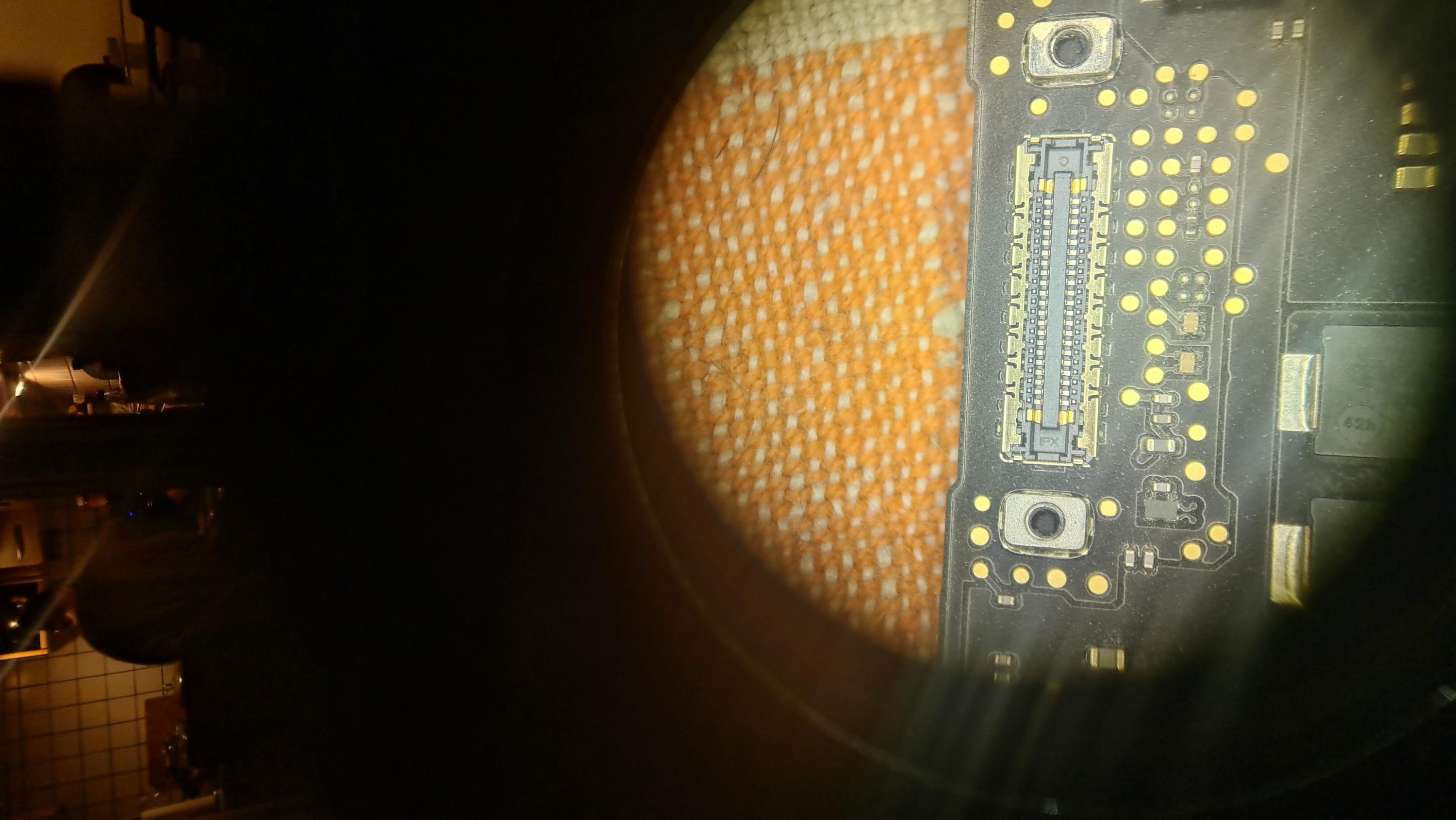

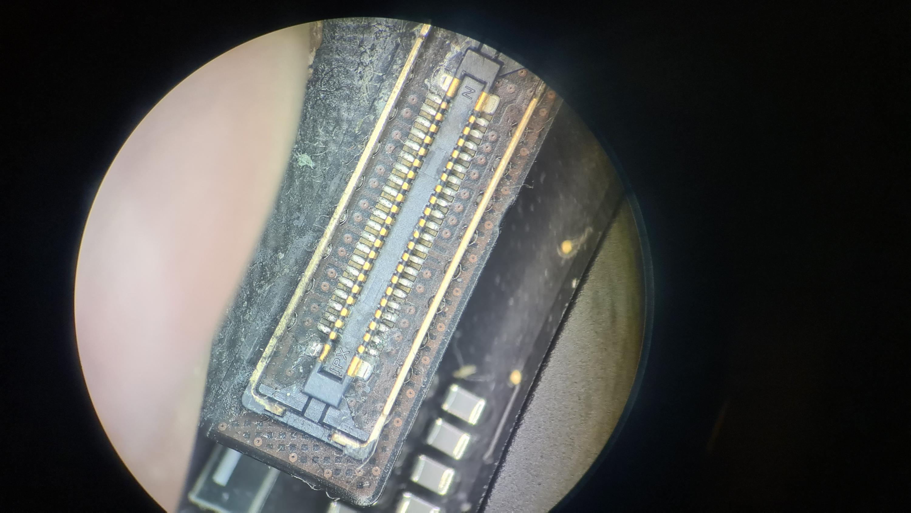

    Hello, I have a MacBook Pro 15 inch 2018. A1990 Board 820-01041-A. The MacBook has water damage. It works but the display stays black. I took a picture of the LVDS connector. there you can see on the thick pin over IPX that there was a short circuit. there is also zero volts. Have any of you had the same problem? Thanks

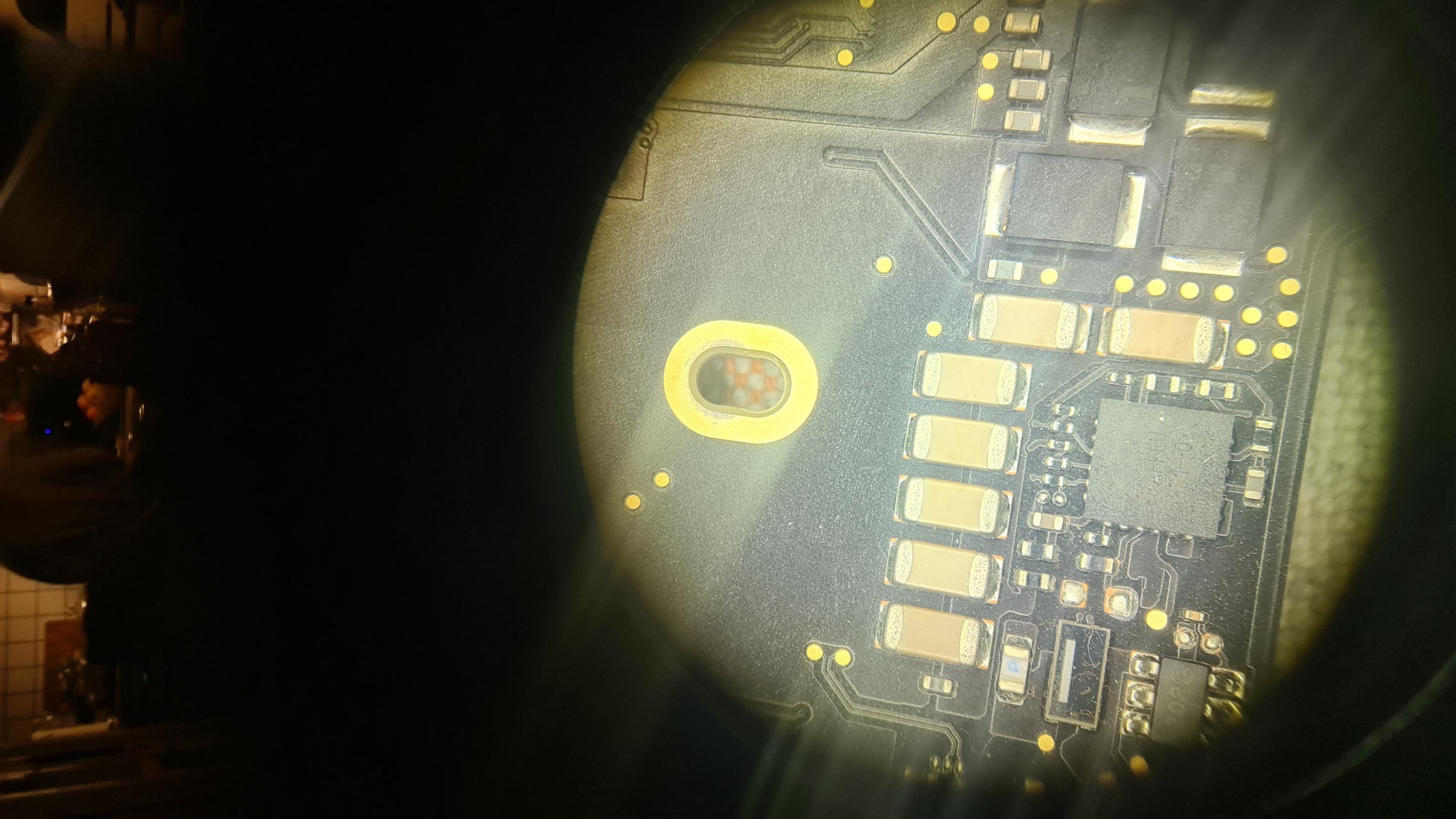

    Hello, I have now made a few more measurements on the board with the power supply connected.
    • Strolch
      • Nov 2017
      • 237
      • Deutschland
      Re: Macbook A1990 820-01041-A Dark Display
      LCD pin top right 0.0072V
      bottom right 3.369V
      top left and bottom left 5.11V
      • Strolch
        • Nov 2017
        • 237
        • Deutschland
        on the second picture I measured 0.004V for the 5 in the row and 0.0035V for picture 3 and 12.55V for the fuse

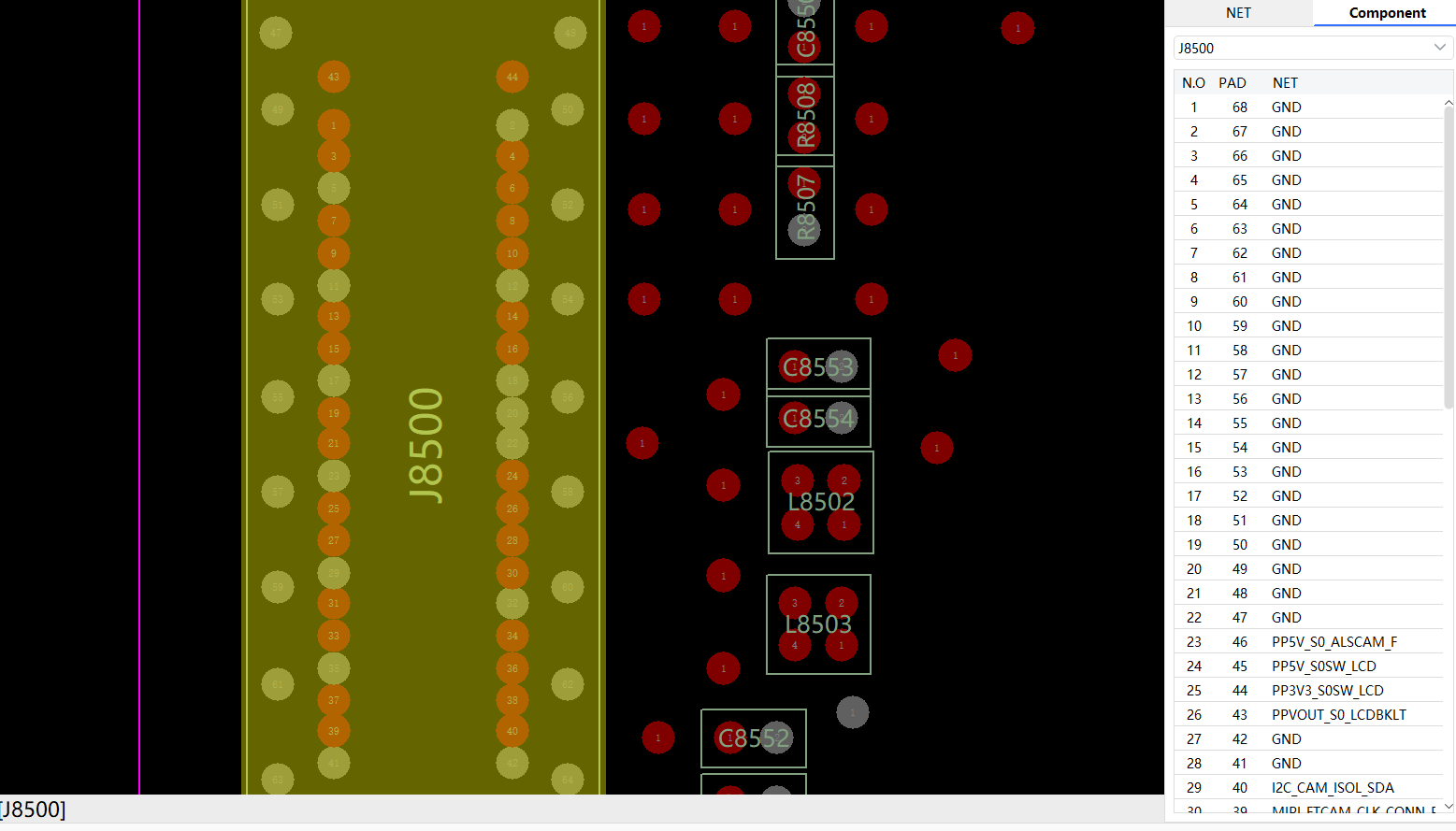

          Hi. Best to use pin numbers from the BV file for this logic board.
          Can you measure and post your voltage readings of J8500?

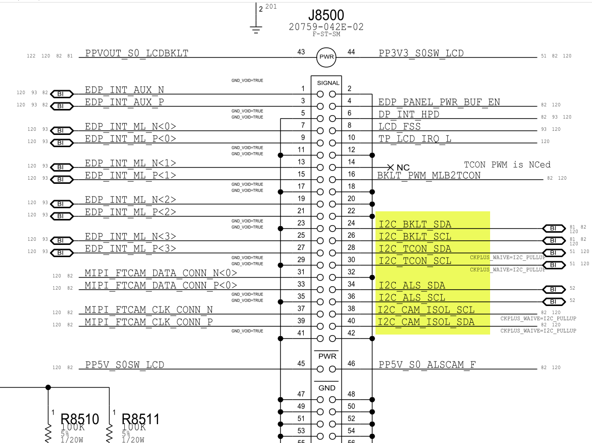

              Start with the voltage to ground check of each of the I2C pins.
              See attached.
              • Strolch
                • Nov 2017
                • 237
                • Deutschland
                i have
                Pin 24=5.108V
                Pin 26=5.104V
                Pin 28=3.36V
                Pin 30=3.36V
                Pin 32=0.0004V
                Pin 34-40 All= 1.7934V

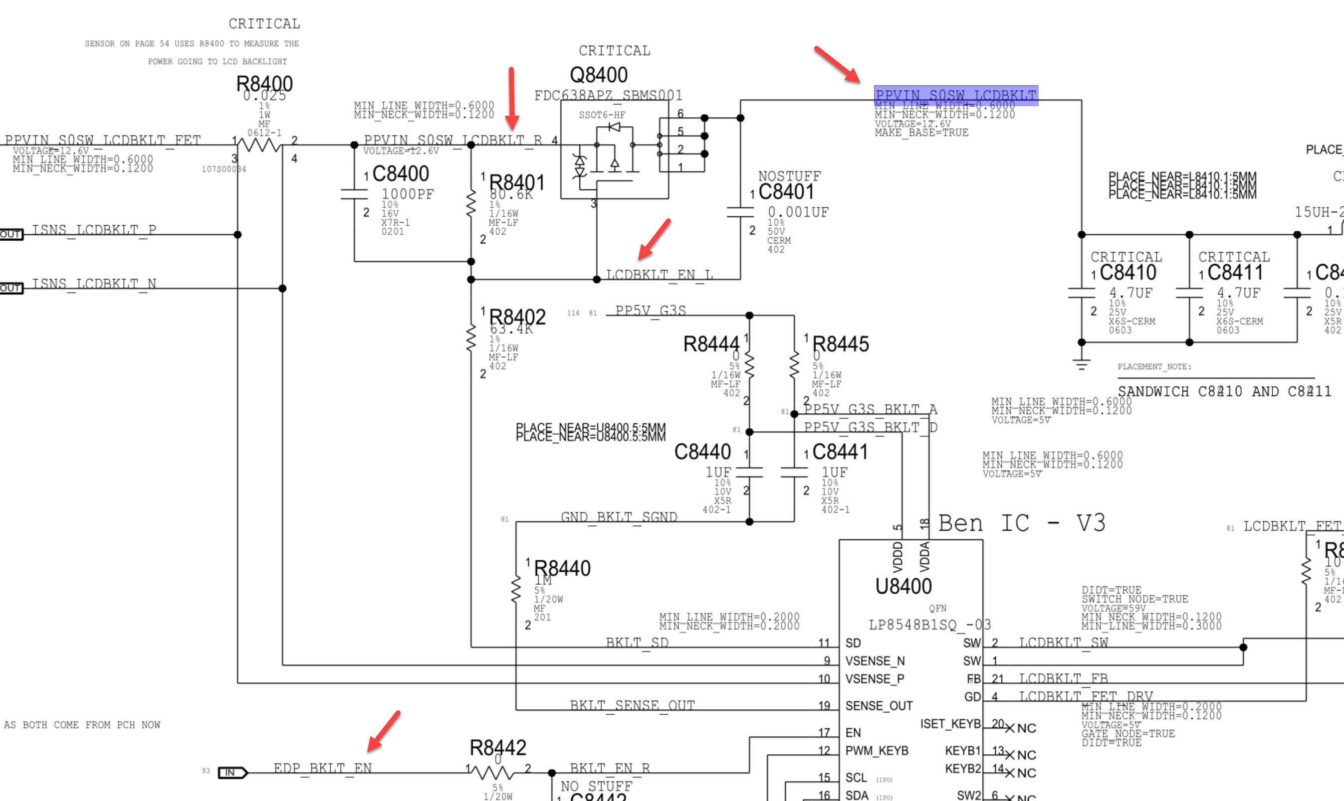

                                        Measure the voltage to ground for the following points of interest:
                                        EDP_BKLT_EN
                                        PPVIN_S0SW_LCDBKLT_R
                                        LCDBKLT_EN_L
                                        PPVIN_S0SW_LCDBKLT
